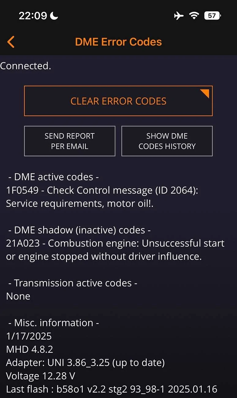

**Update**
Put a 1000amp jump starter on it and car still won’t start. Cranks for a split second then cuts off (almost as if the car does it INTENTIONALLY) but won’t start. Checked codes and didn’t receive a low battery anymore. But still received a “Combustion engine: Unsuccessful start or engine stopped without driver influence.” - code without it pinpointing the main cause. (Ignore the 12.2v that’s after trying to cranking it).
another update** just put my Noco jumper back in to charge but it appears fully charged still strangely. I wonder if it’s registering with the car? Don’t want to have to override the Noco in order for it to work.
Does code: 21A023 need to be cleared in order to start the car?
Should I disconnect the battery and then reinstall it?

Although I have a Code : 21A023 I’ve noticed there’s A “212023” error code “appearing on a BMW after flashing usually indicates a “Data inconsistency detected in the DME (Digital Motor Electronics) module” which is the car’s engine control unit, often triggered by a corrupted software flash or an issue with the data being written to the DME memory during the flashing process”. (I don’t have this exact code but wonder if it corresponds to code: 21A023)
