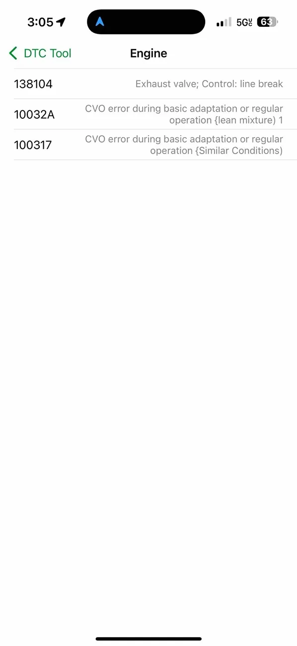

Hey guys, started my car and i got a CEL, checked my ECUTEK app and got these codes, does anyone what these codes are? The first one i assume is because i have an SP1-R but not sure about the other 2. Thanks.

according to the code - suspect faulty injector. CVO = Controlled Valve Operation that monitors injector open/close time.
