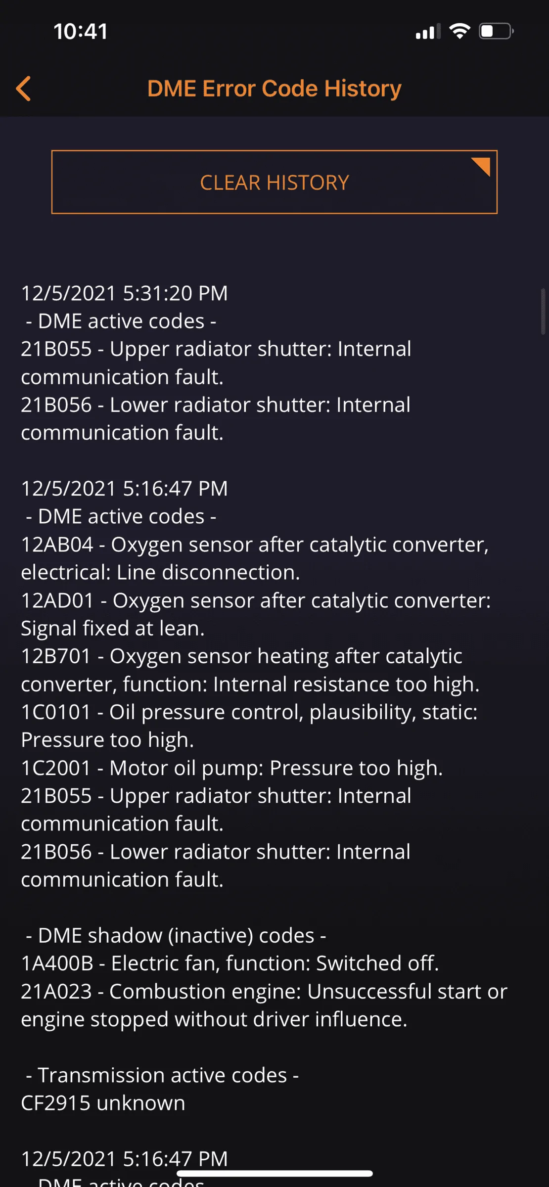

The radiator codes are norma in these cars. They come with that from the factory for some reason.
Those O2 sensor codes aren't the oral ones you get from a catted/catless downpipe. It's possible whoever did the downpipe install damages the rear o2 sensor.

yeah hear that, OP? Twisted Tuning said it's a part out.

Thanks for the reply, I've gone ahead and replaced the rear o2 sensor before in hopes it was that and it still throws the same code. In terms of the oil one I figured out that it's a faulty oil sensor. I can't read oil levels through my cars settings

I've been MHD tuned for quite a while now and have had 0 codes aside from the "Insufficient fuel for power delivery" code that you get when trying to run the OTS E50 map. Basically it will put the car into limp mode if you red line the car on the OTS E50 map. All of that is 100% solved with my MHD Ethanol Custom tune though.
For your issue, MHD has a box you can click inside of the app itself that turns off the entire catalytic converter check system so that you can't get a CEL related to the Catalytic converter. I've been running a catless DP for close to a year now with 0 CELs. I think your issue is entirely mechanical and specific to your car and has nothing to do with your tune.
What box? I've looked for that endlessly

who did your custom mhd tune? whenever I try the ots e30 map I get limp mode too

Fabian @Pureboost. MHD is partnered with Pureboost for tuning. Fabian did a fantastic job with my custom tune. 0 check engine lights or limp modes since and I beat this car like it owes me money.

Id start by putting the stock dp back on. Just to rule that out. It’ll probably clear half those codes
Betting the car feels just as fast as well. Whats with the obsession of power when the base 3.0 is simply a fast car overall. People beating their heads against a wall and if not on track no where to really enjoy it at all.

this can be fixed by either reaching out to MHD, or just getting a custom tune from a knowledgeable tuner.
