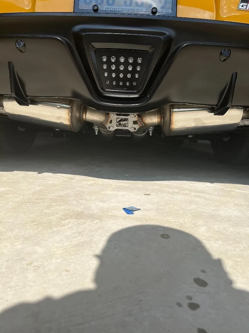

Purchased mine with Borla ATAK already installed. Noticed the valve is always open regardless of Comfort or Sport mode (even on cold-start it's open).
Checked the 203 fuse and it's there and looking fine.
Is there a way to reset or fix to where I can control the valve open and closed?

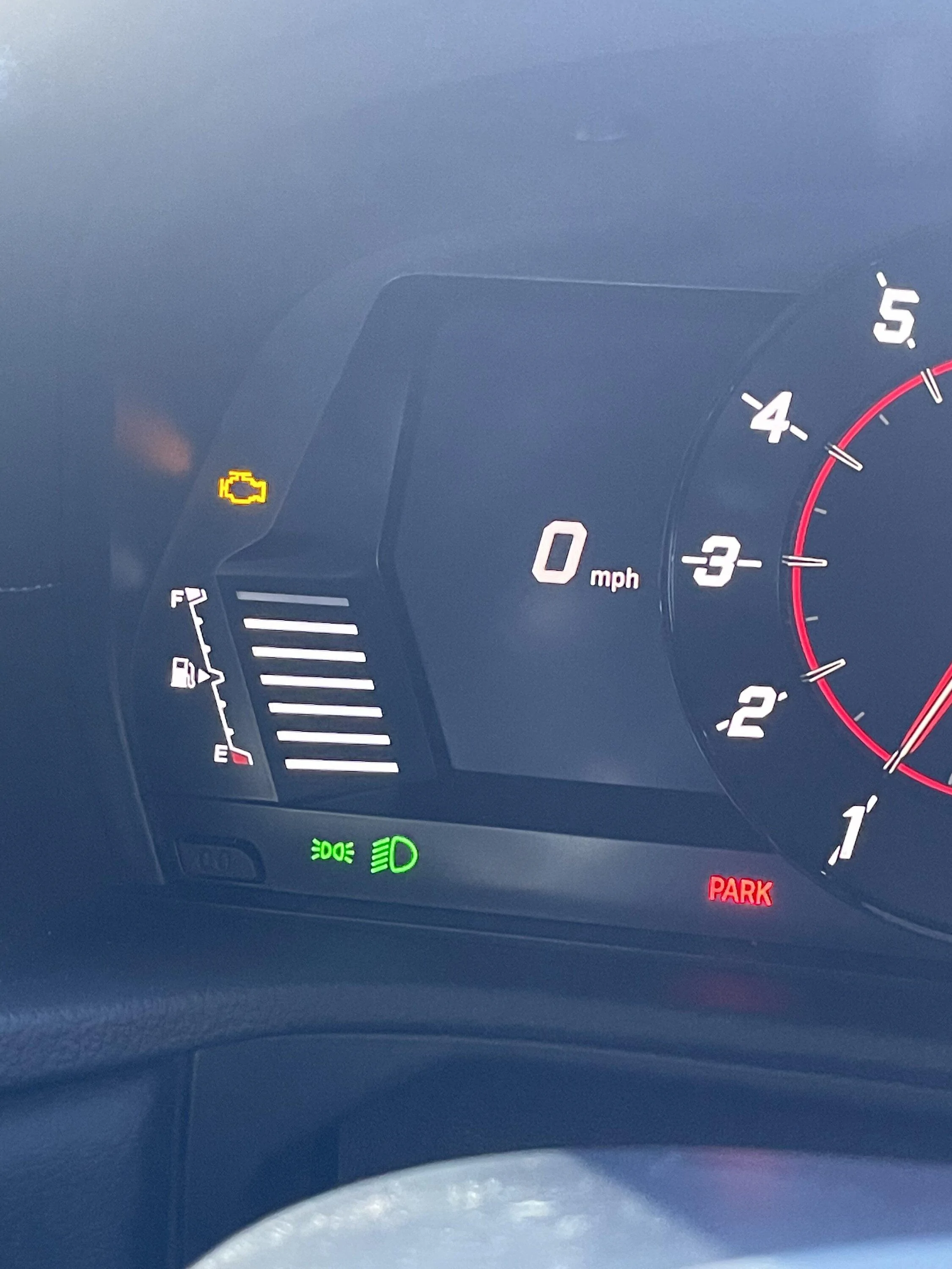

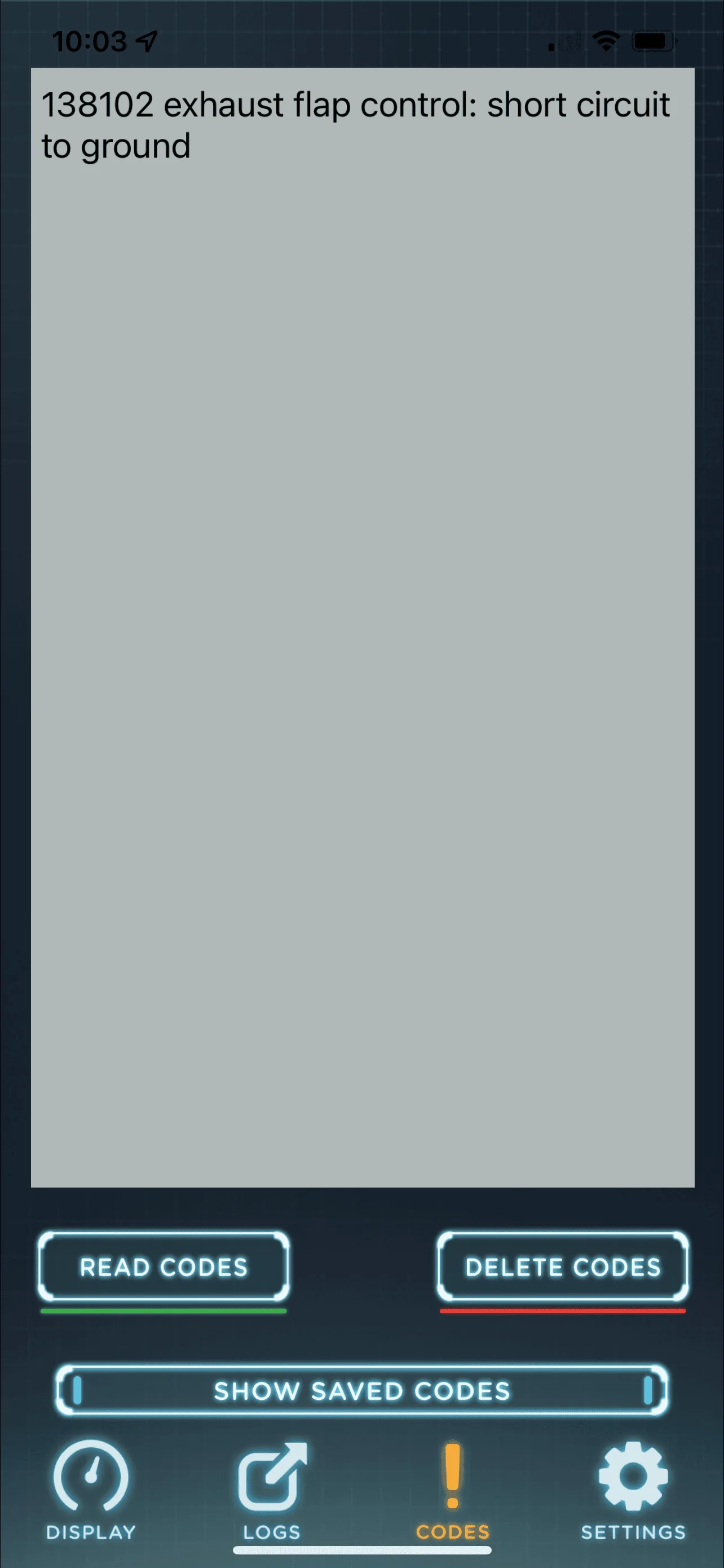

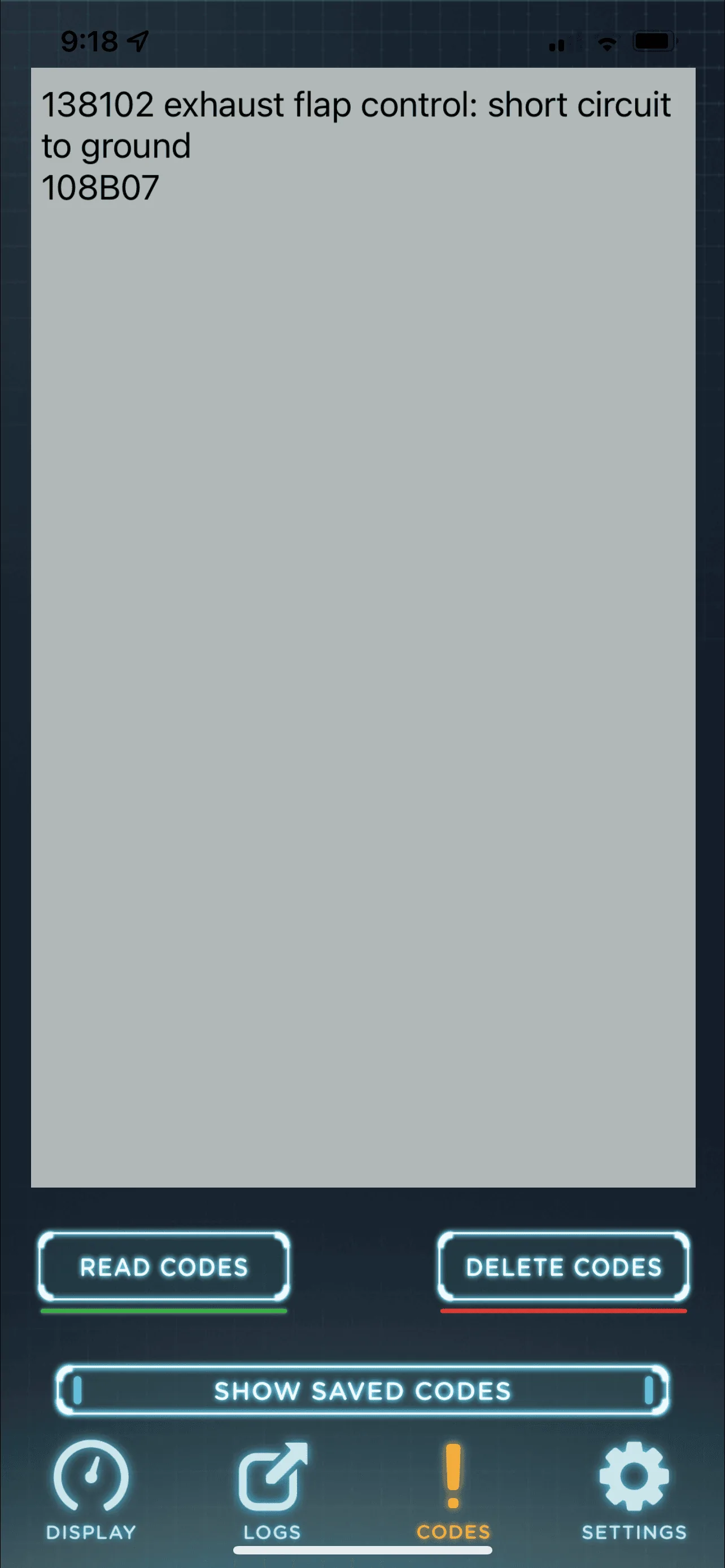

I removed the fuse, instantly got a CEL. I cleared it, turned off the car and valve is still open. I started the car and no CEL, I’ll update in a while after it’s cold then I drive it to see if a CEL comes back on…

I cleared it and it just came right back…

Maybe reach out to AWE and ask if you can purchase the valve motor simulator from them. Really don’t know if they would sell it separately without it being a replacement for one that came with a full exhaust.
