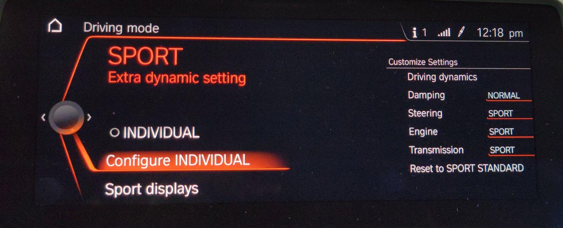

Yes. you can do that. Configure Sport Individiual to the settings you like. Suspension -> Normal, Engine (exhaust) -> Sport. Then use BimmerCdoe to start the car in Sport Individual. That'll get you the settings you desire.
Really? I have not seen that option. Will check it out, but I have not seen where you can change the suspension to normal in sport mode.
Yup, it's way down there in the menus. If you find 'Sport Individual' settings, you can select Normal or Sport for Suspension, Engine, Transmission, and Steering and save that configuration to your profile. Then you can choose Sport, Sport Individual, and Normal in the selection pop-up.
BimmerCode will then let you select a default mode.

Is there coding to force it to Comfort suspension with Sport exhaust ??
Yes as Zrk mentioned. Configure individual, set damping to normal and engine to Sport or Sport+. Then set the car to start up in Sport Individual. So essentially you have Normal, Sport Standard, Sport+ with more aggressive shifts, and then a Sport Individual to tailor however you want.

You can code this with Bimmercode. I have my car coded to start in Sport Individual with Sport + Transmission mode active.
Thanks for that - so 'Engine' is really exhaust?

It does a bit more, throttle responsiveness is also part of it. I'm honestly not sure if there are different values for torque targets/ performance as part of that setting or not. But, yes it also changes exhaust based on being in Sport vs Normal.
