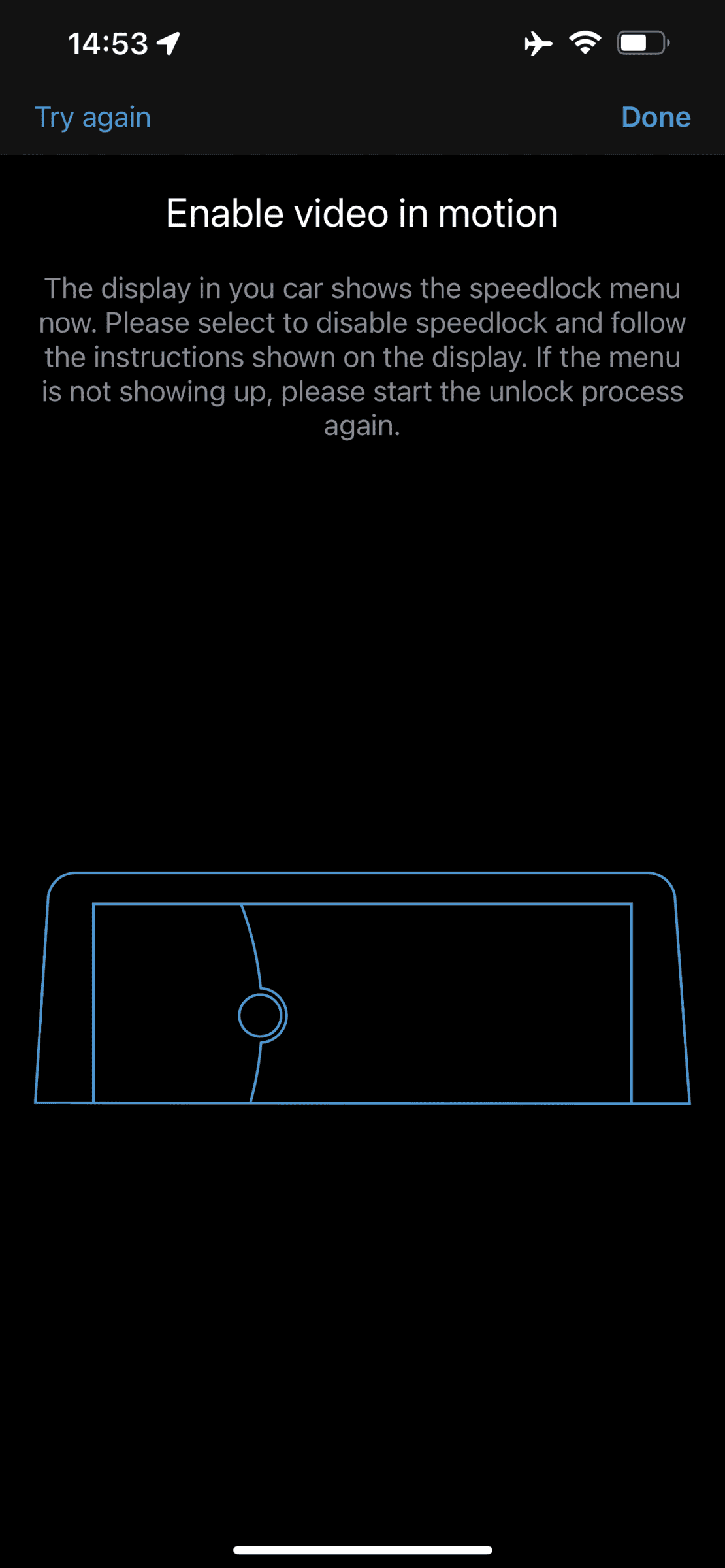

When attempting to perform this step:
Main → HeadUnit (HU_NBT_EVO) → Video in motion → Active
After coding another message pops up to perform an additional action:
The menu before it has me holding the iDrive button up and the headunit appears to restart but then this screen shows up:
Any ideas? Thanks

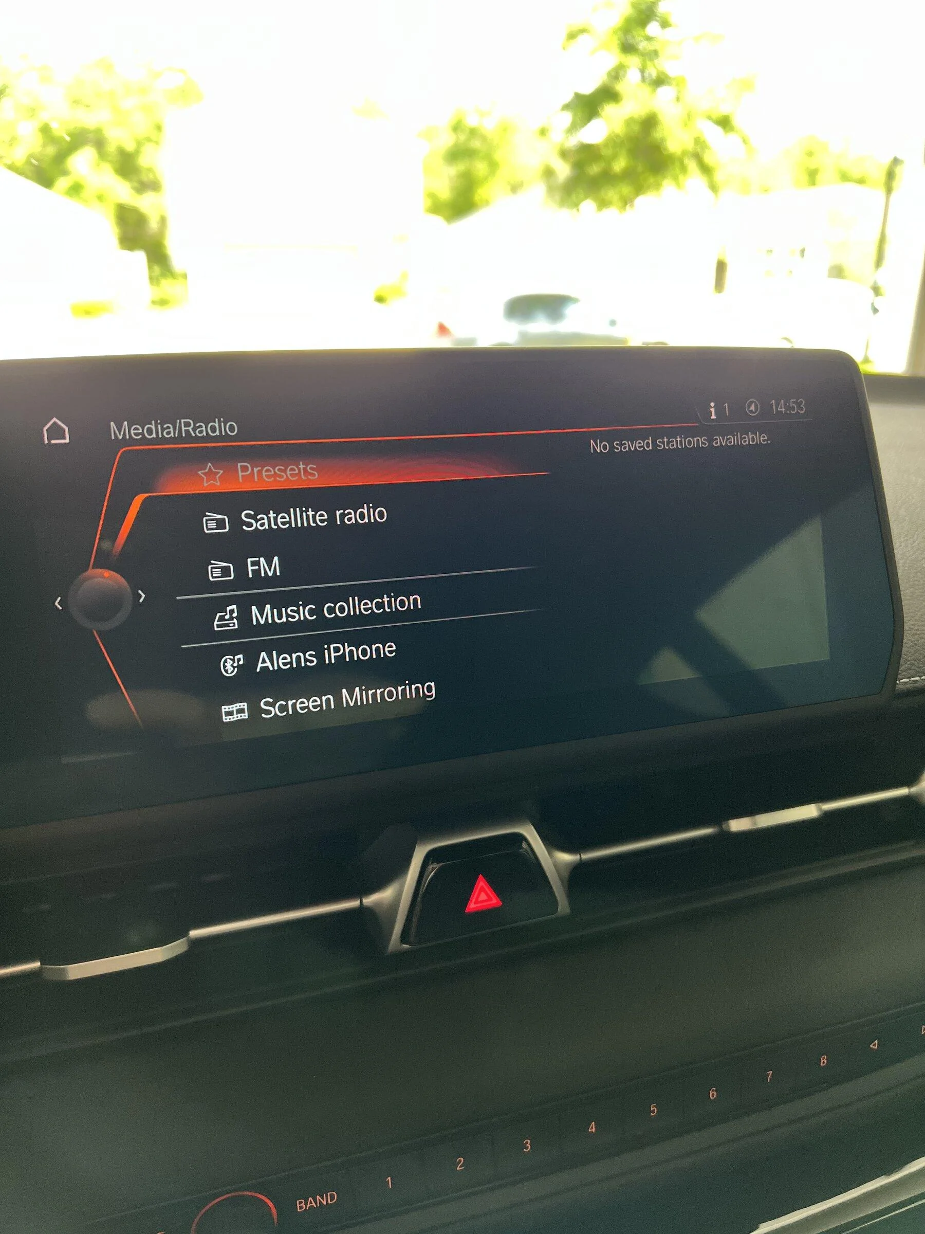

Does this work with android screen mirroring? Will it play YouTube or?
Yes you code in video in motion, then you when you do android screen mirroring it won't pause and stop it. Once you have video in motion set up the screen mirror can play any apps such as youtube etc. Without it, it says something like "this device can't be used while in motion", even including map apps.

I just got an Android phone and I'm loving the screen mirroring. Does anyone know if there is a way to have videos other than YouTube play? If I try any of the sports or video apps the car's screen goes black.
Any ideas? Thanks
I don’t know if you already figured this out yet but what you need to do is to hold the button up while activation is completing. If you let it go once activation bar starts to fill but before it finishes it will dump you back on a main screen.
