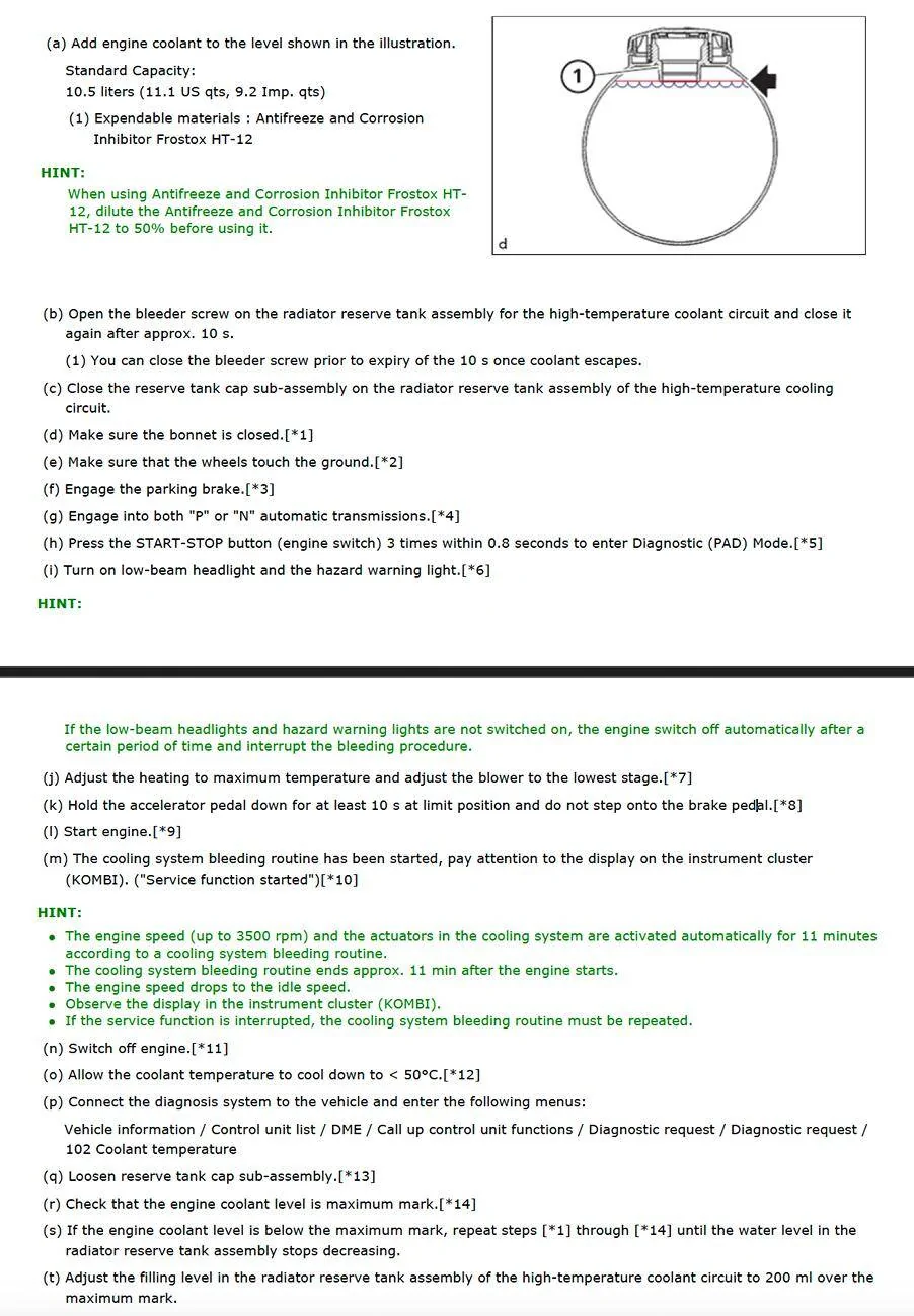

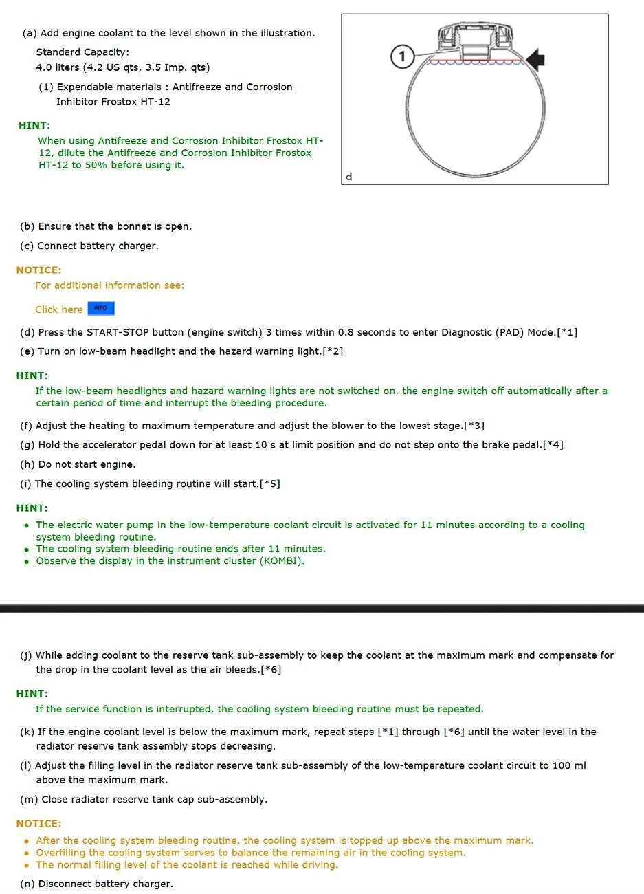

i’m having some coolant issues, but how did you run the coolant bleed procedure? my mechanic’s scanner can’t run it for some reason it’s not coming up as a BMW or a Toyota on the scanner and we need to run the coolant bleed procedure
8,638
16,936
