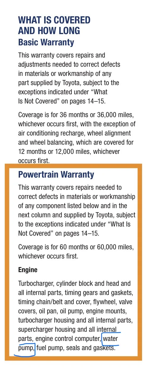

Quick update, dealer is now covering the job under the powertrain warranty. Hurray! My wallet is saved. To think I almost foolishly folded and could have been out 2k.. that's new tires money!
Thanks to you all for your input, advice and information. I'd buy you all a beer and pizza if I could.
