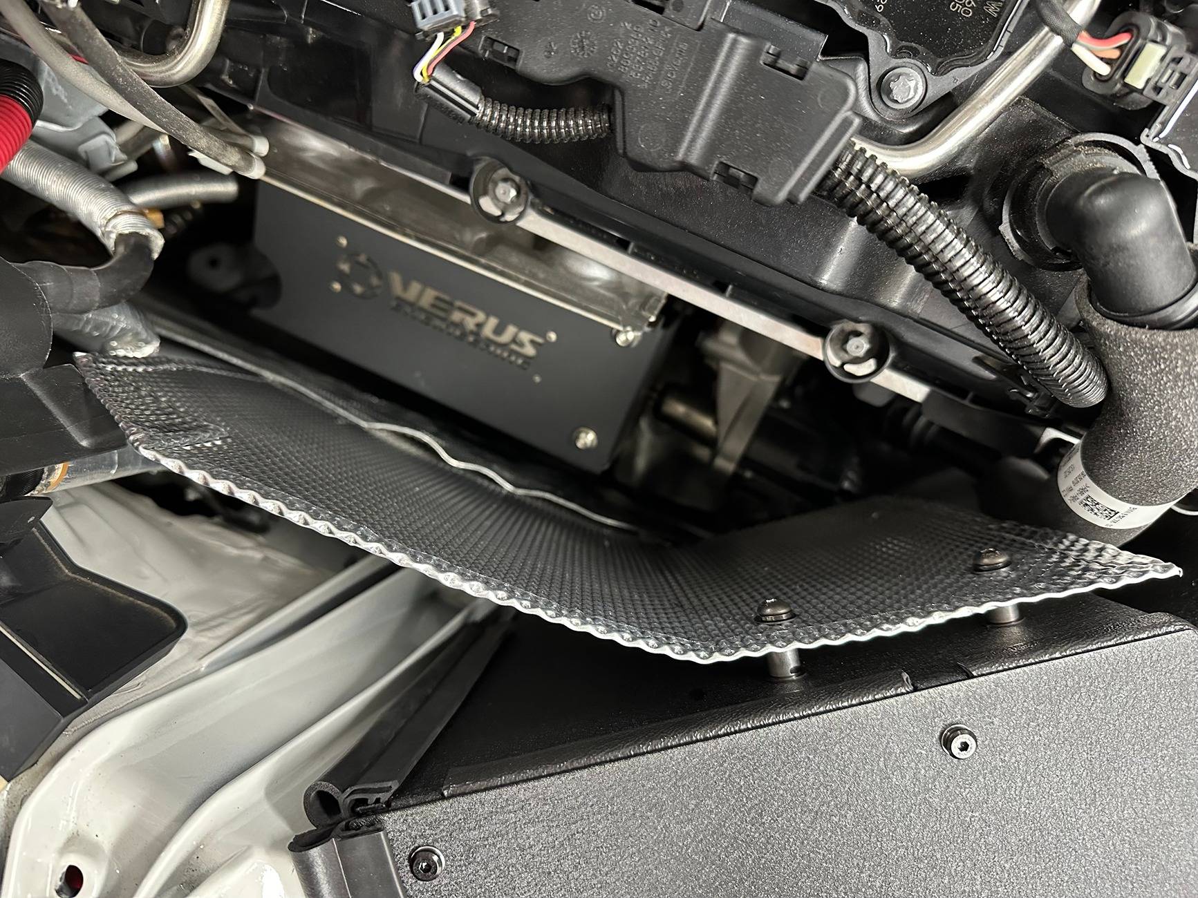

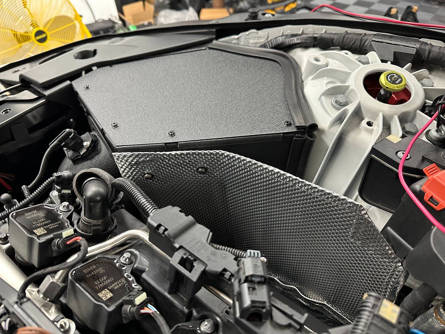

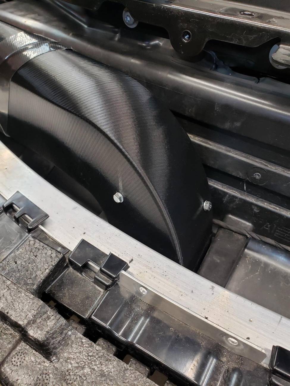

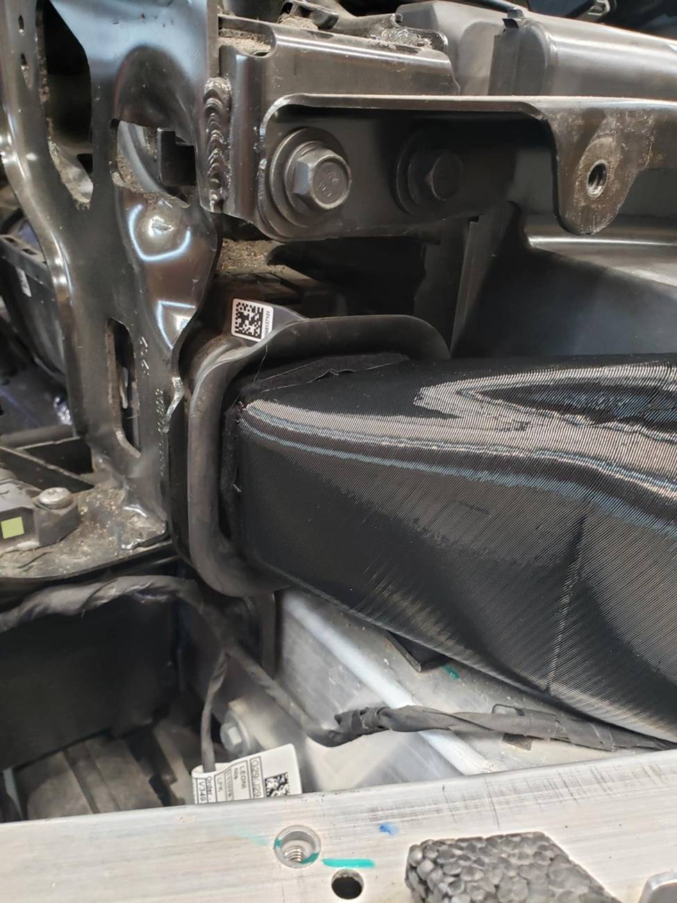

Yes, it was on mine and I don't make that much power. You could custom fab a box for the filter setup you have. This is why I also fabbed up a heat shield for my MAD intake box.

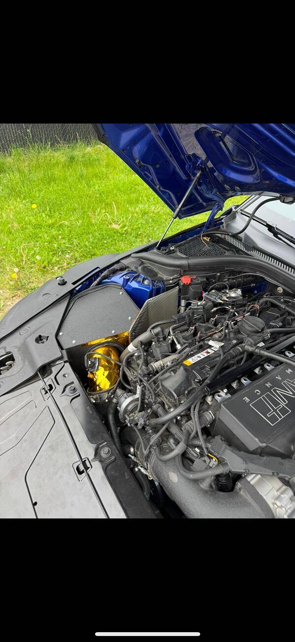

Modifications were done as you can see in my pictures

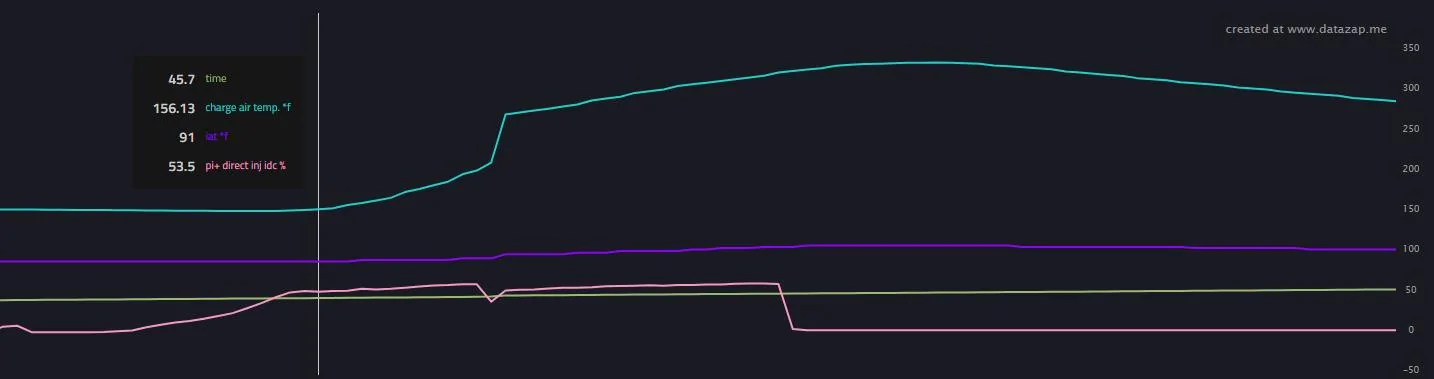

Charge temps are still going up to 338f in 6 seconds...
At this point im wondering if there is a hidden problem with the car
https://datazap.me/u/ajrmkv/3-4-rev-39?log=0&data=0-5-11-52

What's up with that 60F increase in charge temp on gear change? Is that a logging drop out or is that repeatable?
It appears to be a one off. Havent seen that in other logs although peak temps are the same
8,818
17,303
Not even looking at charge temp, IAT jumping 20F in a single two gear pull is def suss.

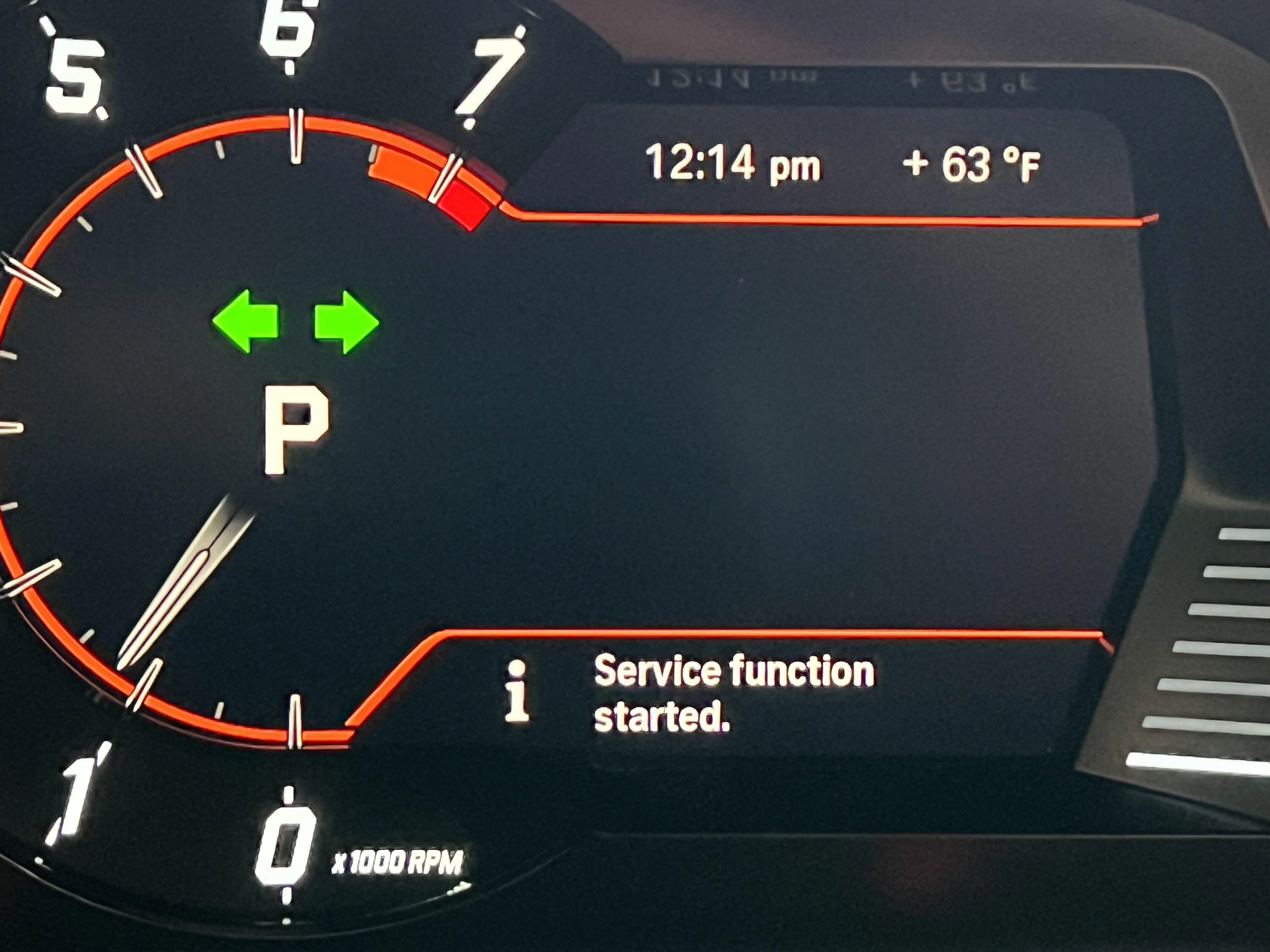

I wonder if logging the water pump would be a good idea. You can do it in protool and maybe bimmercode?
Might be a good idea, i'll give that a shot
