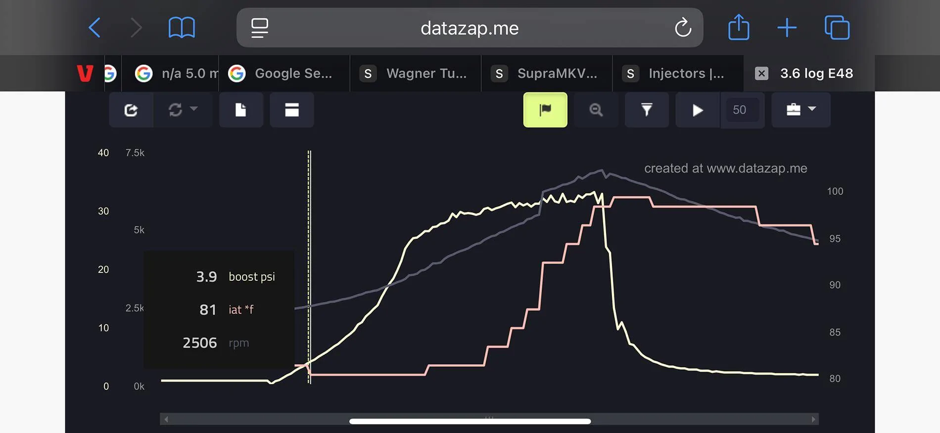

During 4th logs of 2K to 6.8k at 33 psi, ambient is around 60 each time im seeing 16-19f rise in IAT over baseline.
wait so this isn’t normal?
8,813
17,287

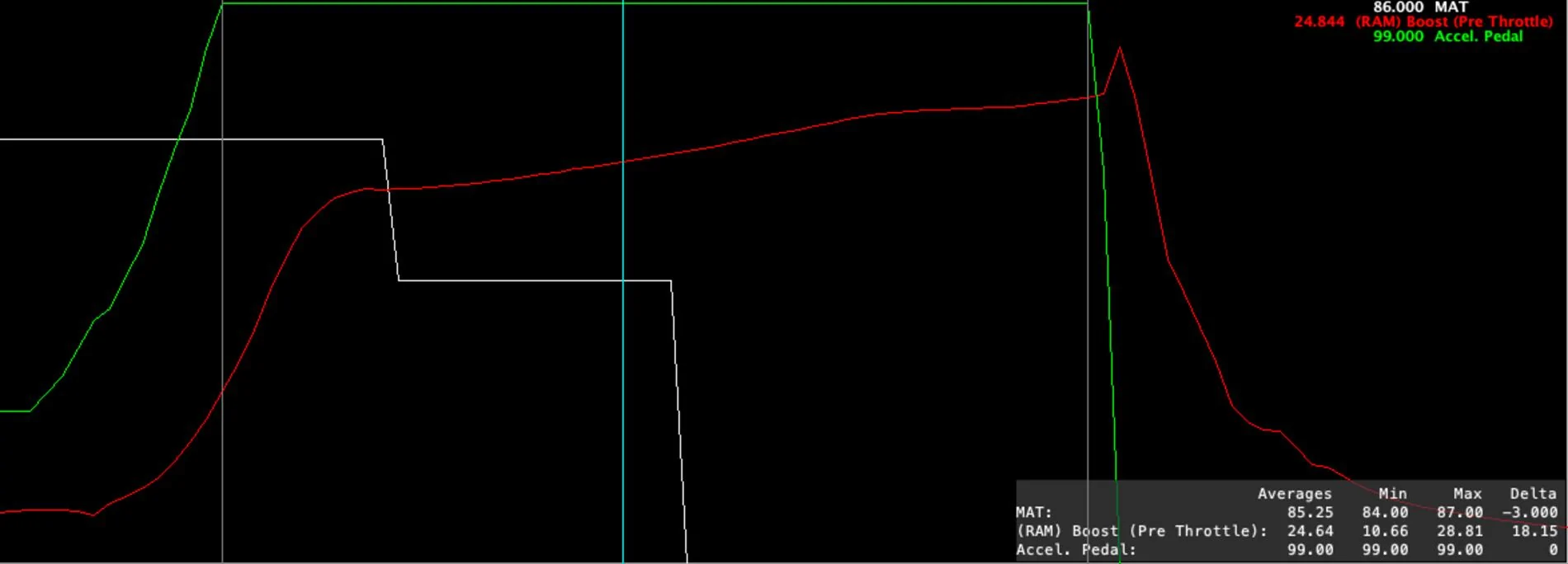

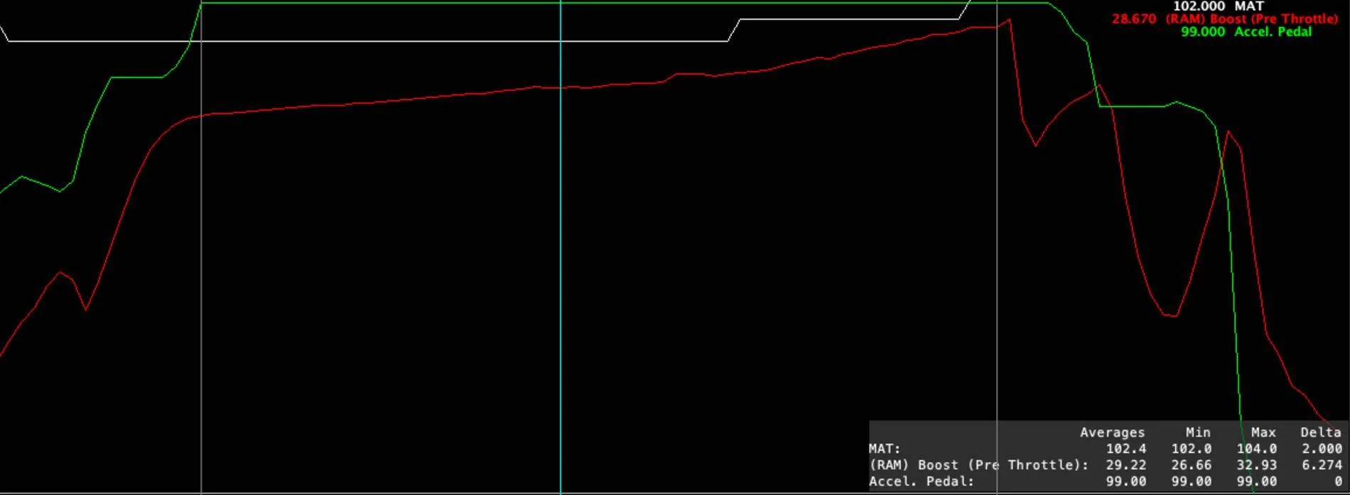

16-19F IAT rise during a single gear pull is not normal at all. It should be the same, rise maybe 2-3* or drop, depending on ambient temps and usage.
My Wagner, 4th gear on the street:

On the track after about five laps:

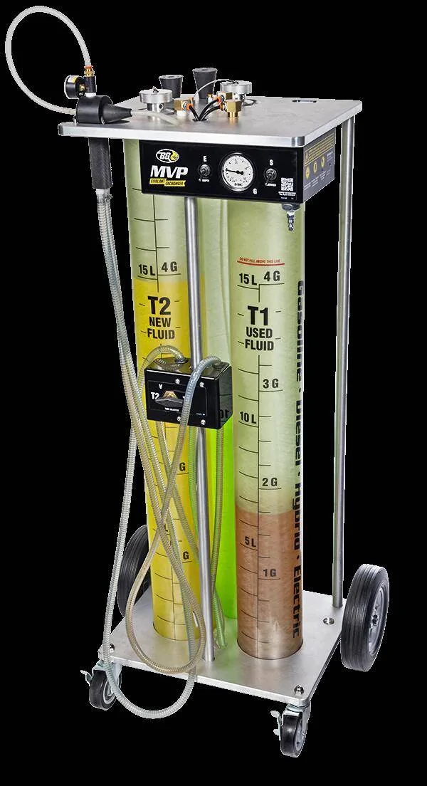

do you know how and what they're using to bleed it with? i used a harbor freight one at first but it didn't create a proper vacuum so i ended up using my shop one which looks like this.
AJRMKV
Apr 28, 2022
961
913
2023 Manual Supra
That may not be the exact brand, but something like that yeah

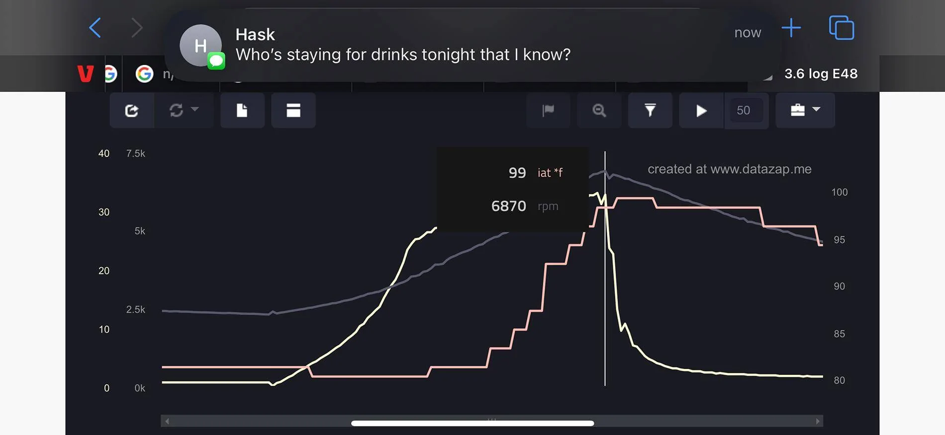

Beginning of pull
81f - 2500 rpm
End of pull
99f - 6870 rpm
Also end of pull: my friend interrupting my screenshot
8,813
17,287
Beginning of pull
81f - 2500 rpm
End of pull
99f - 6870 rpm
Just FYI, you aren't the first to have this issue with the Remnant manifold.
