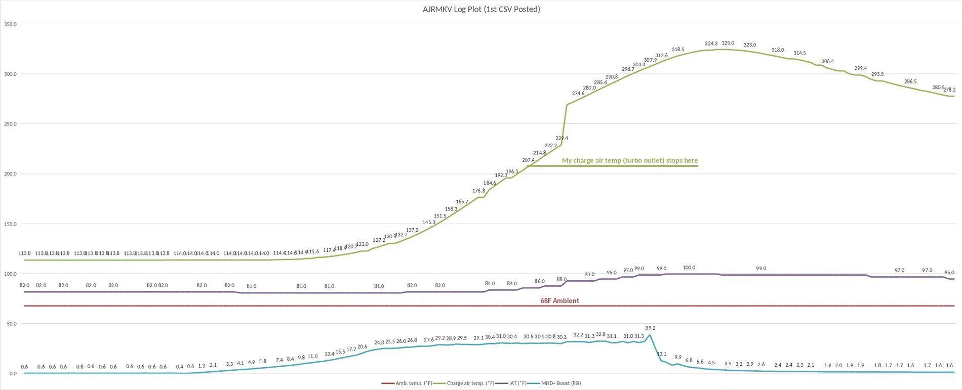

What are your thoughts on the charge air temp? This is 32 PSI, apparently some others charge air temp only goes up to 200ish degrees indicated in the pic
8,779
17,222
Charge air temp has nothing to do with the mani-cooler.
According to your chart, your IAT is 100F max, when your charge temp is 324F. Your mani-cooler is shedding 224F of heat. However, 300+ charge temp during a single pull is a bit high.
That 16F IAT increase over a single pull is also not normal.
The "Others" you are referencing are running the same turbo and boost?
200F charge temp is like a chill WOT pull in 50F weather.

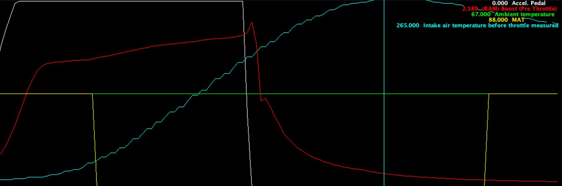

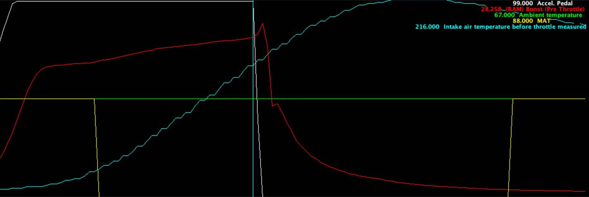

Here is mine after a 4th gear pull at 28.Xpsi:

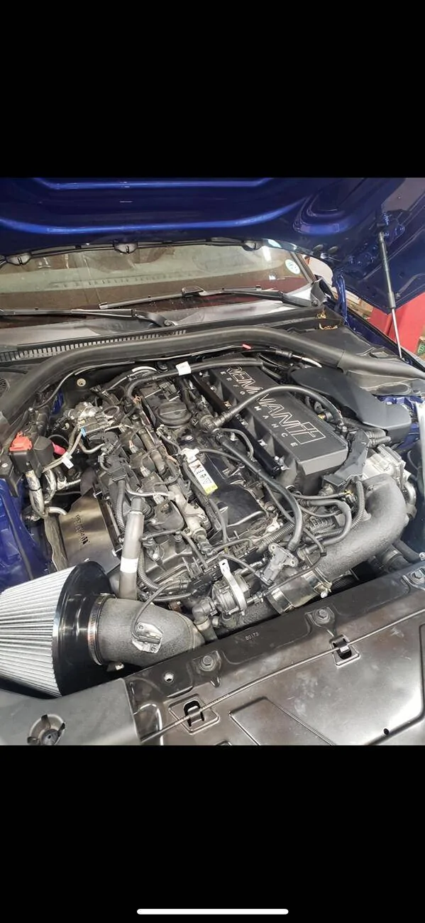

@razorlab I'm starting to think the stock airbox might solve this issue based on my intake setup in the pic. From your experience, would it be a restriction on 700+ whp?
Yes, it was on mine and I don't make that much power. You could custom fab a box for the filter setup you have. This is why I also fabbed up a heat shield for my MAD intake box.
Great idea. I’ll give that a shot.
might be PITA adjusting the WG arm if I need to but I’m willing to take that risk
8,779
17,222
Yea it could be your issue since your charge temps are so high.
