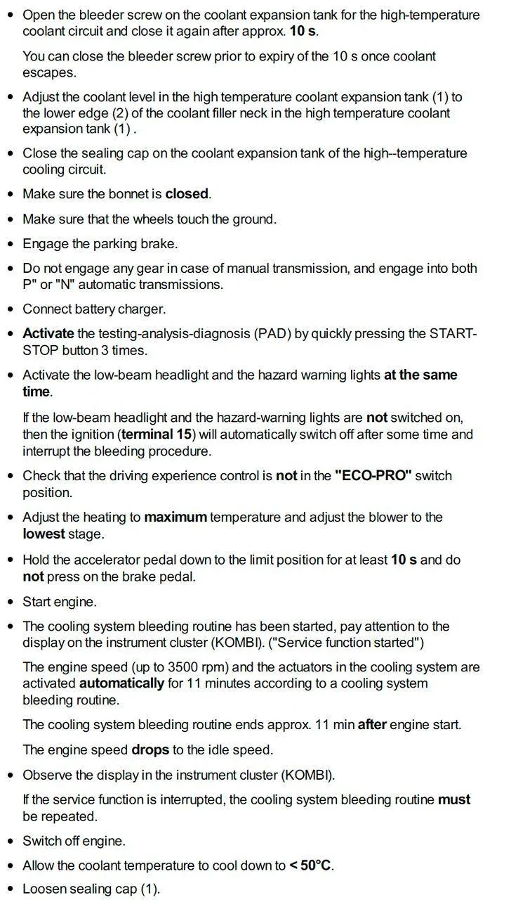

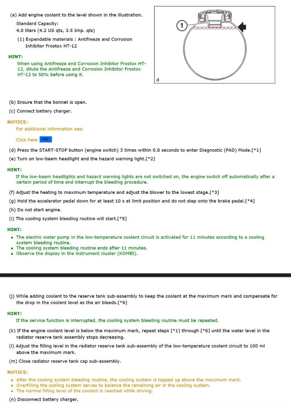

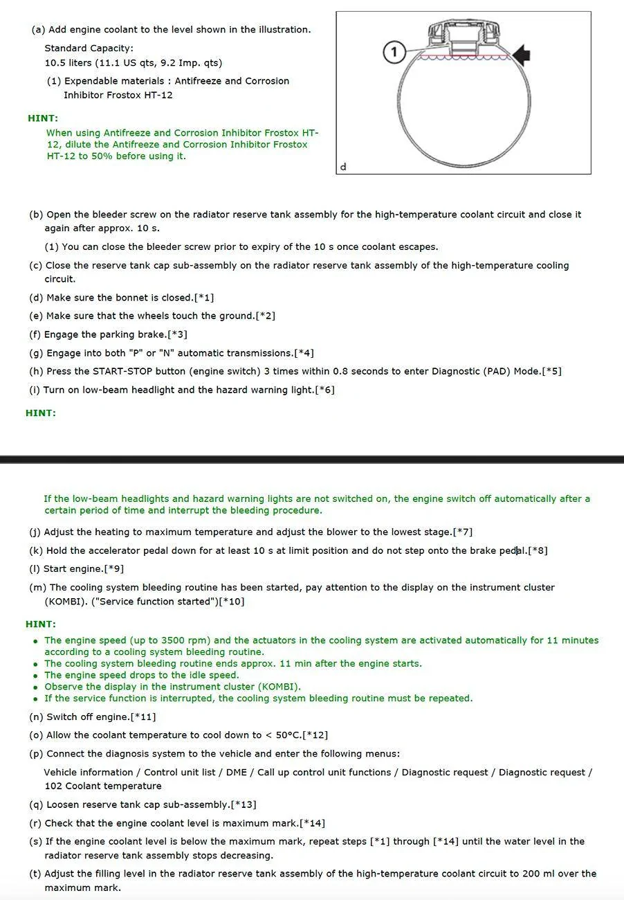

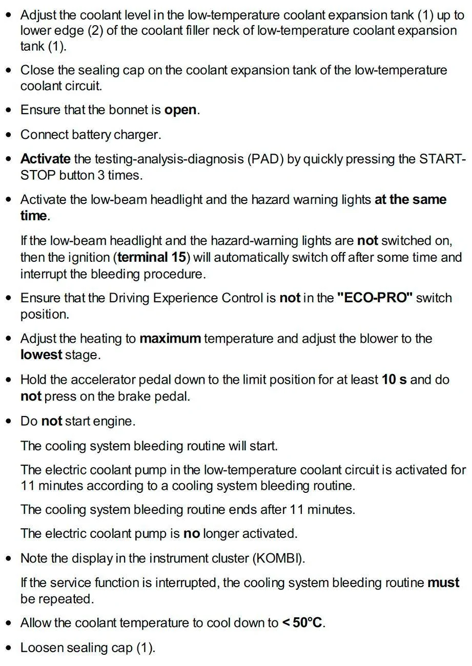

No need to guess what the procedures are. I've posted them here before and now here again:
Toyota Low temp:
Toyota High temp:
BMW Low temp:
BMW High temp:
