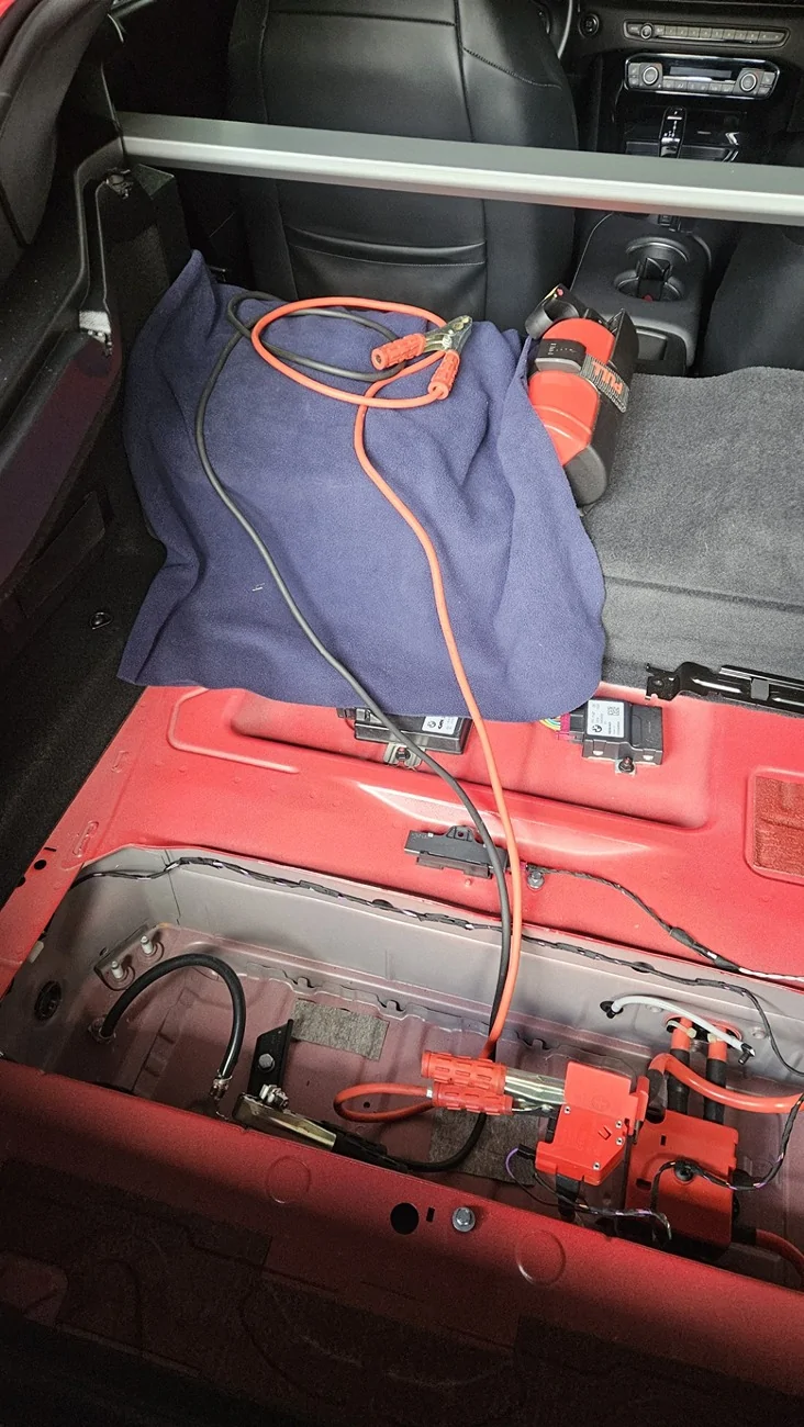

Do you have jumper cables? If so, disconnect the battery, put black clamp on the battery, red clamp on the cable you took off. Leave the other side alone and sitting in the front seat. When it comes time to power the car back on, connect the two clamps together at the other side and pop the trunk. Then connect everything back up and fire the car up like normal.
I do have and based on your tip I could remove the battery, extend the OEM battery wires with jumper cables, so they are closer to the door and use this extension to connect the battery just to be able to press the switch to open the trunk. I think this is the best and the easiest solution to my problem and I could normally close the trunk.

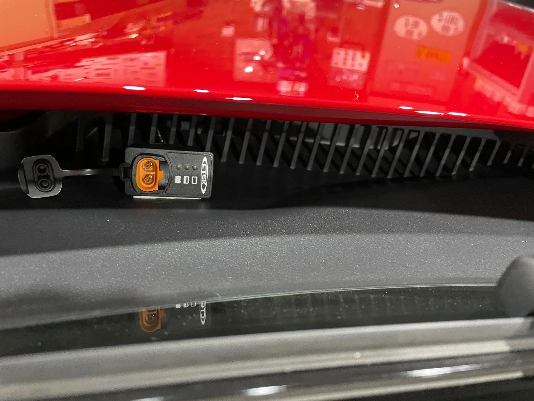

Here's what I would do in this situation on my car. I would remove the battery and connect the battery leads with a small jumper lead made from some 8 or 10 gauge wire with small alligator clips. I'd then connect my battery charger or emergency start battery pack unit to my external charge point which connects to the front battery terminals and lock the car and disconnect the charger/battery pack unit. Then reverse the process when I re commission the car.

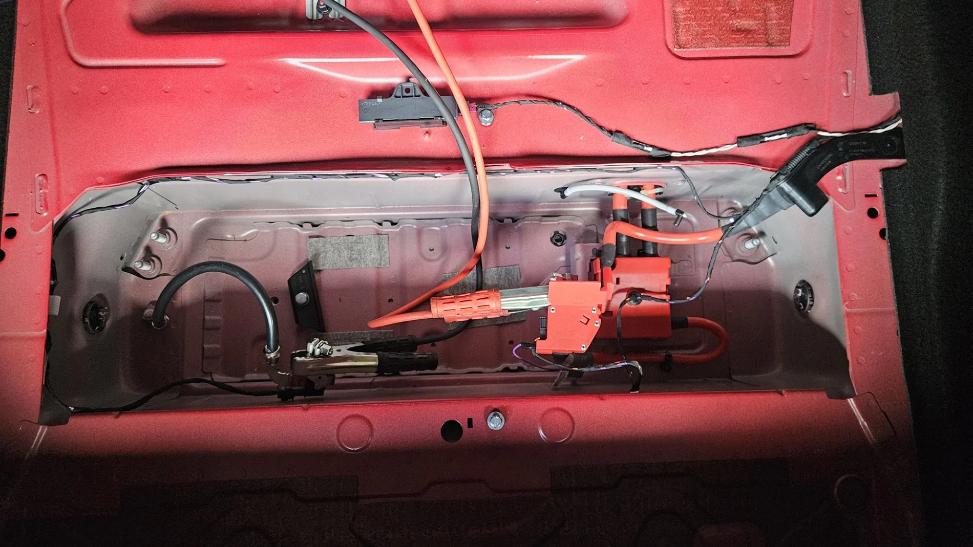

So this is how I prepared the car to be able to open the trunk after 6 months of garage storage. I used jump wires to "extend" OEM ones, to be able to clamp them on the battery, just next to the driver's seat. It worked perfectly.
Regarding battery maintenance, I moved battery to the basement, where the temperature is constantly 15-18C, I had to recharge it only once during all 6 months, using an automatic AGM charger. The engine started on the first try.
