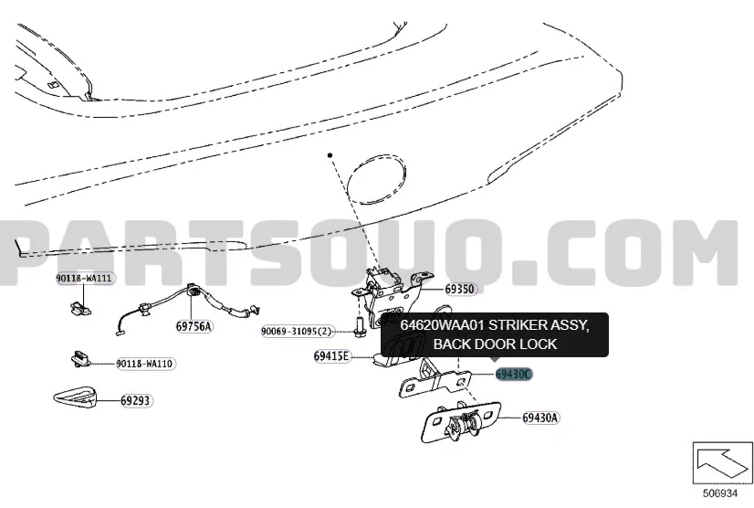

I have another idea, since I really want to remove the battery, otherwise it's gonna be dead after 3 months of garage parking. I was thinking to remove the striker so the trunk will not lock itself, it shall stay in place under it's own weight.

Seems unnecessarily complicated, why not rest a shirt over the latch?

Removing the locking mechanism from the trunk isn't a bad idea, but of course you'll want to be sure the trunk stays closed somehow. And that no one will know that it's left unlocked.
