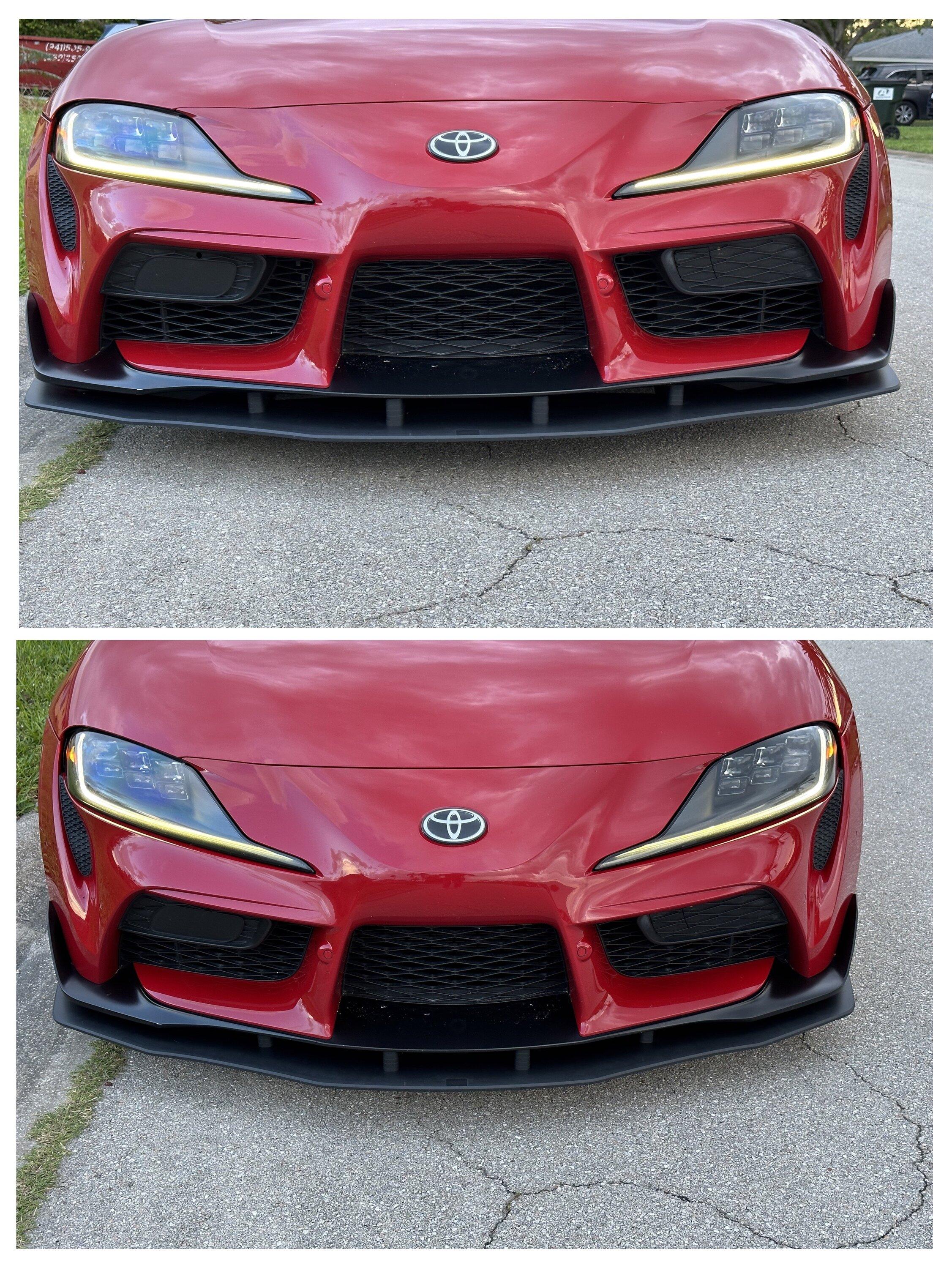

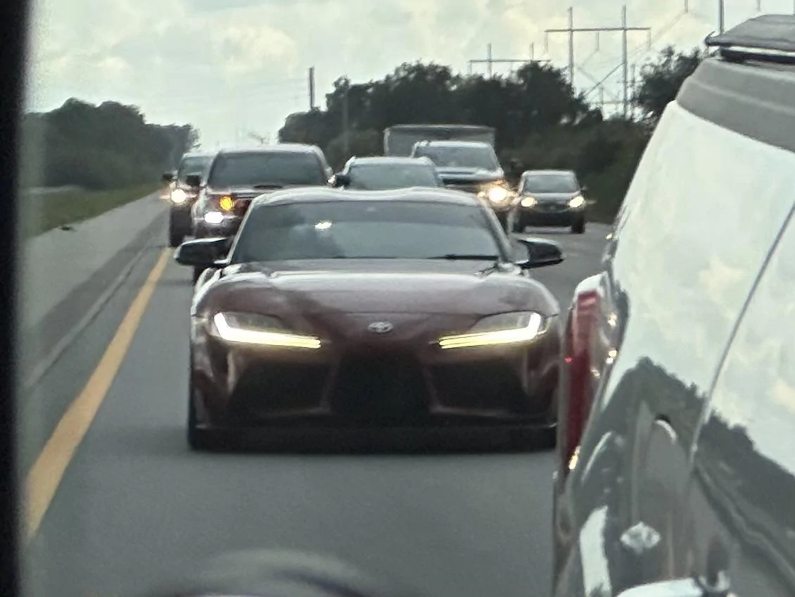

I just noticed the inner portions of both of my DRLs appear to be dimming. Quick googling shows that BMWs have experienced this prior to the LED failing.
Thoughts?
And if they are failing, does anyone know the part number(s)? I’m two months out of warranty…
The “headlight module” I found was ~$380 each, and I’m not even sure that’s the right part.
Was considering yellow if I have to replace them, but I don’t think I love the look on red or with the Supra DRL style for that matter.

Someone mentioned that this may be expected (post was deleted?).
This pic was from feb 2022, and I can see some dimness on the passenger side here.
Maybe the outside conditions today (mid day storms) were ‘perfect’ to highlight the nature of the DRLs 🤷‍♂️
I will have to check tonight when it’s dark.

I think this is part of it.
This is the first time I’ve seen my headlights from this angle. I was looking from the cab of my truck, which is higher than the typical angle from which you’d look at the lights.
As you increase your viewing angle, the inner part of the DRLs are impacted.

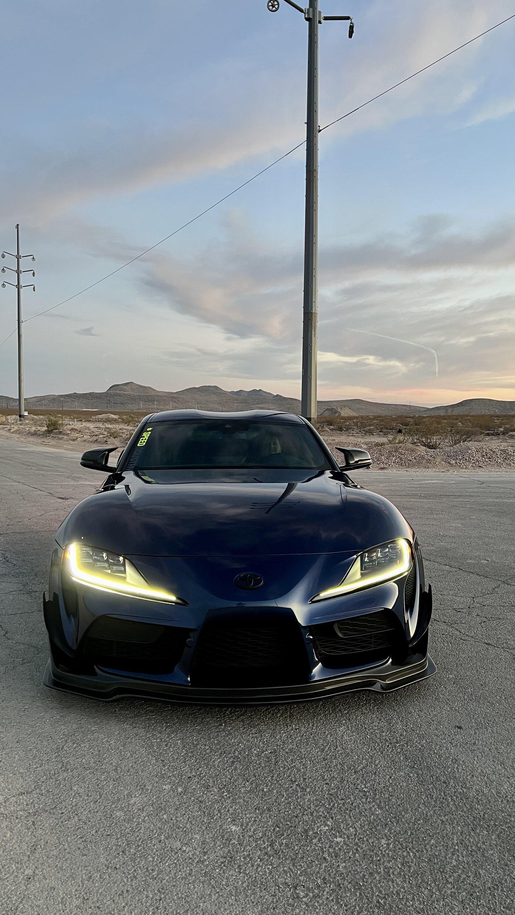

My left side (drivers side) is noticeably dimmer then the right side. It kinda comes up in photos, but in person it’s way off. Took it to the dealer and they “reflashed” the headlight module and also did the recall. No difference. I was hoping Diode Dynamics would’ve come out with a module as I have had great luck installing their BRZ and Camaro DRL modules, but they don’t want to. Guess when the time comes I’ll just the DRL board or see about de-soldering and soldering in a new chip.

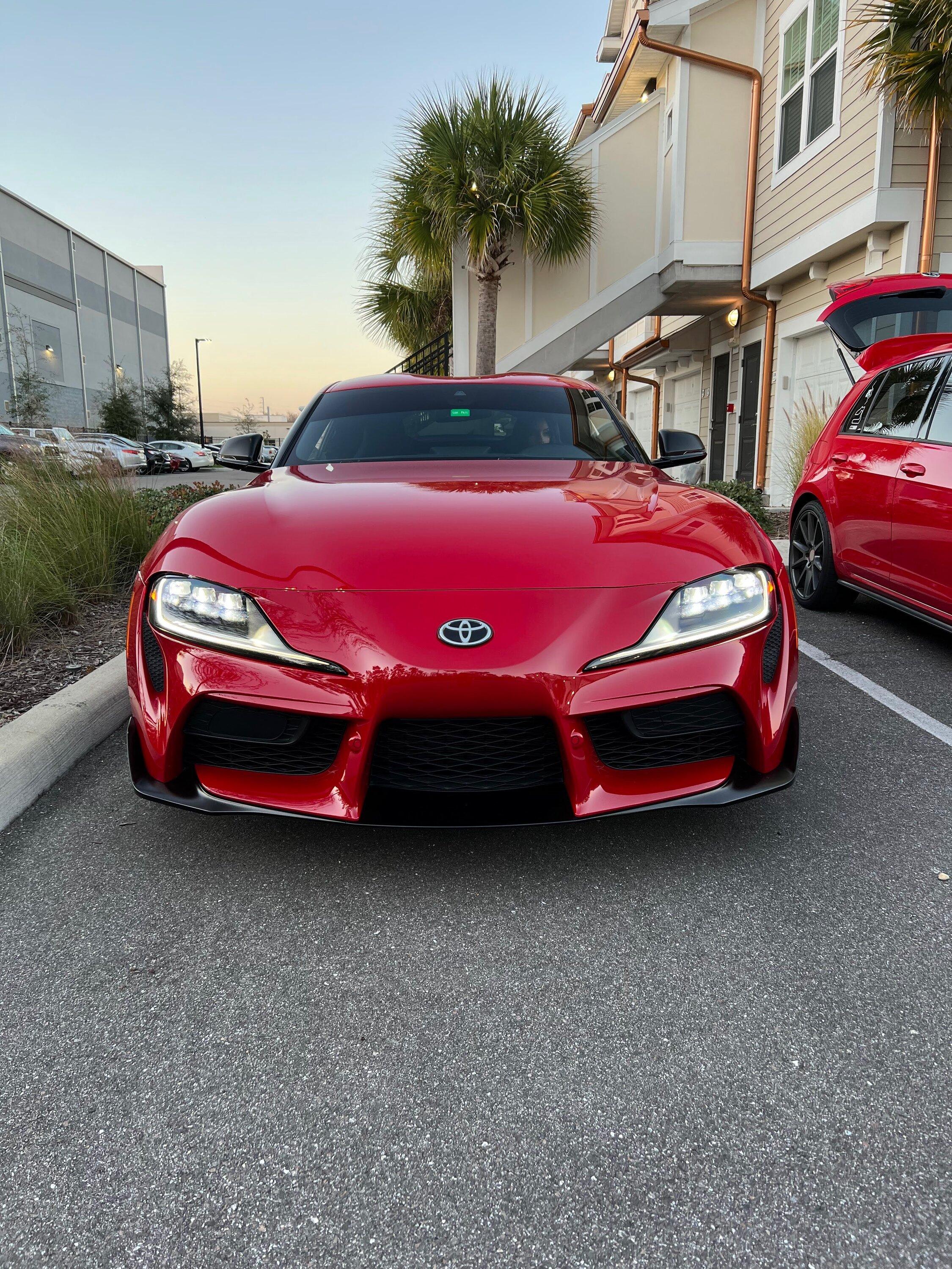

Idk, kind of looks like something is going on. Or I just never noticed it 🤷‍♂️
