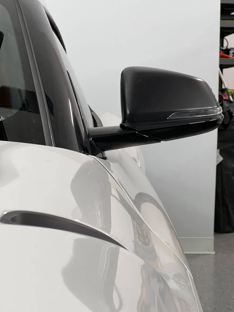

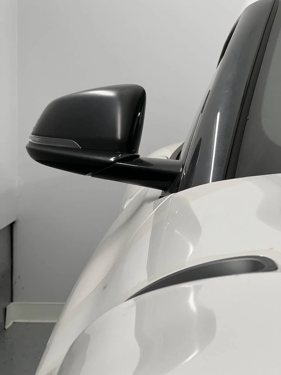

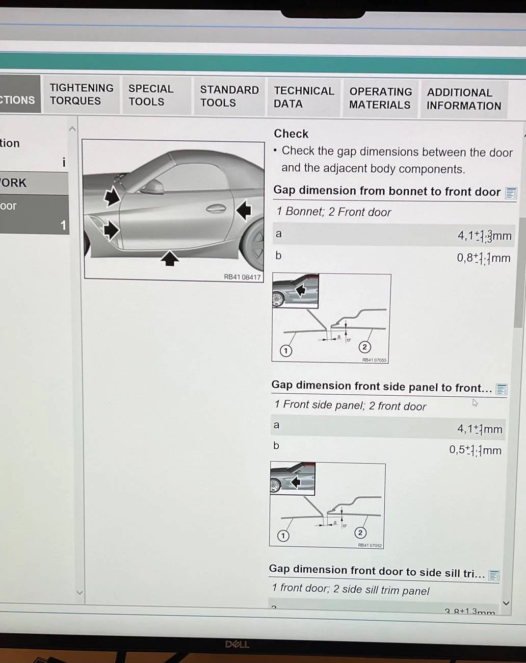

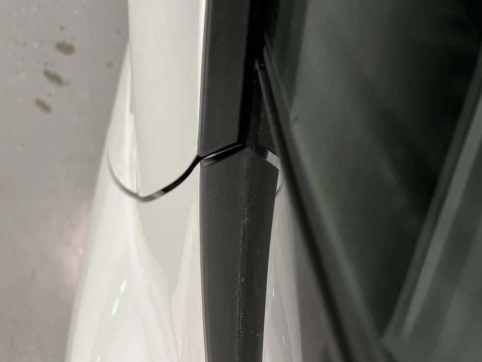

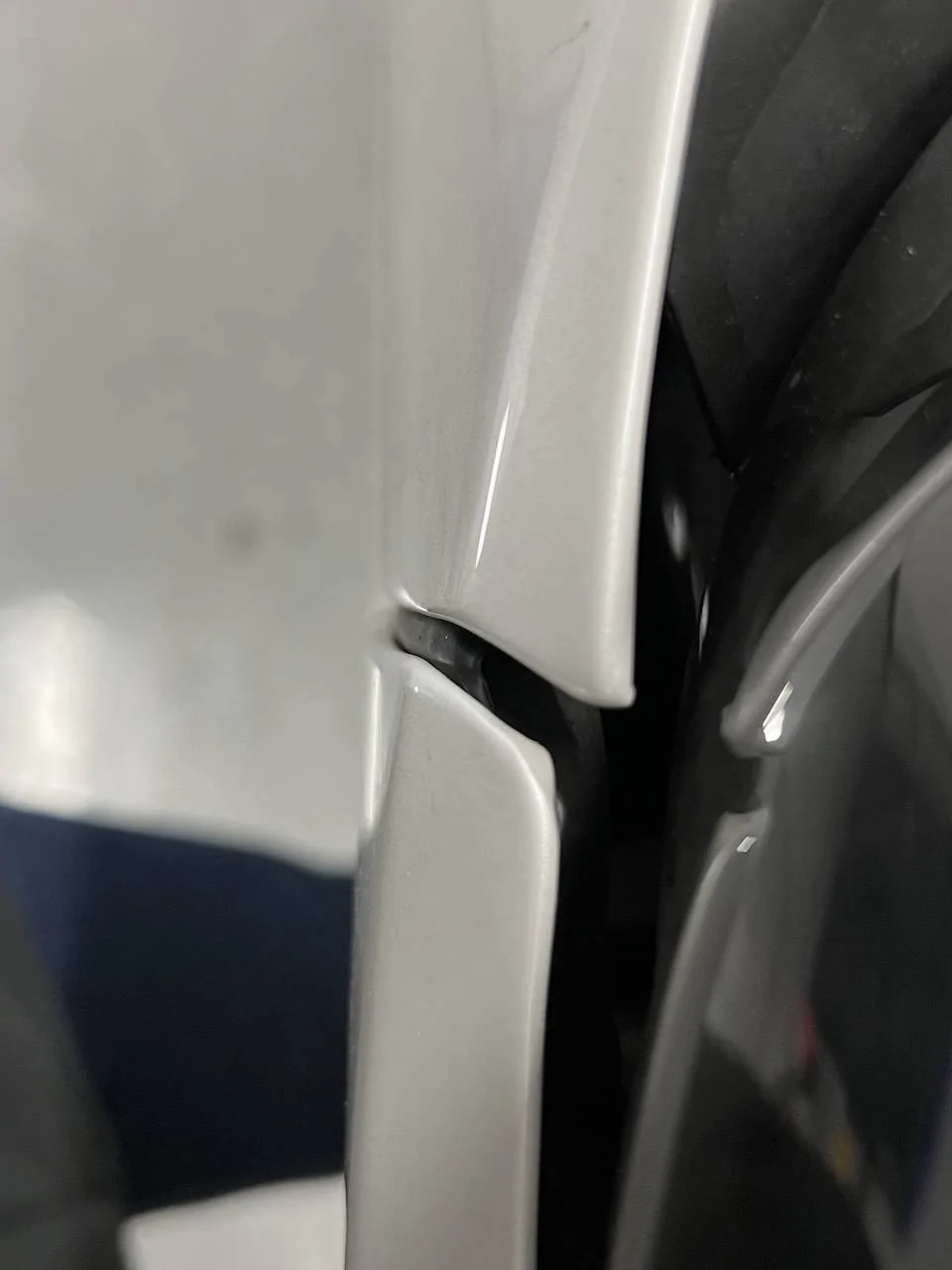

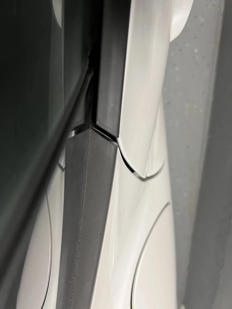

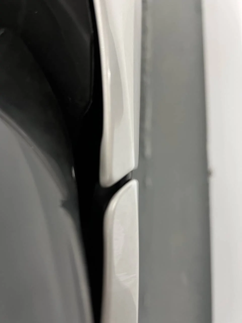

Alright I have it fixed. Inspected a couple more panels and eventually found the door is not the primary issue, the hood is. It’s the classic misaligned hood discussed in many other threads. It was installed way too much to the passenger side, so the driver side panel gap between hood and door was out of spec. Surprisingly the issue was carried from the first production year to the last, Toyota/BMW never try to address it.
Fix was simple, loose the nuts in the rear end of the hood, two on each side and one side at a time. Push the hood to the driver side a bit after loosing the nuts, then tighten the two nuts. Repeat on the other side. Close the hood, check the panel gap and repeat the process if needed. Torque is 19NM according to ISTA. The paintwork was done after the hood is mounted, so you will be chipping the paint on the nuts. I’ll touch up later, but should be fine leaving it there.
Once the hood is aligned right, the bumper alignment will be screwed because they installed the bumper last to fit the misaligned hood. Just need to loose 6 larger screws holds the center piece, and 4 small screws, 2 on each side to hold the part above reflector. Larger screws should be torqued at 5NM and small ones at 2.5NM. When I unscrew the 6 larger ones in the center, the bumper pops out a bit right the way. They seem pushed it really hard so it fits the misaligned hood. SMH

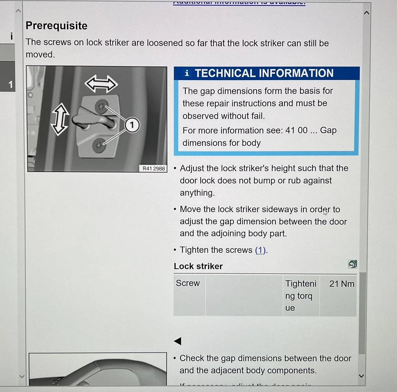

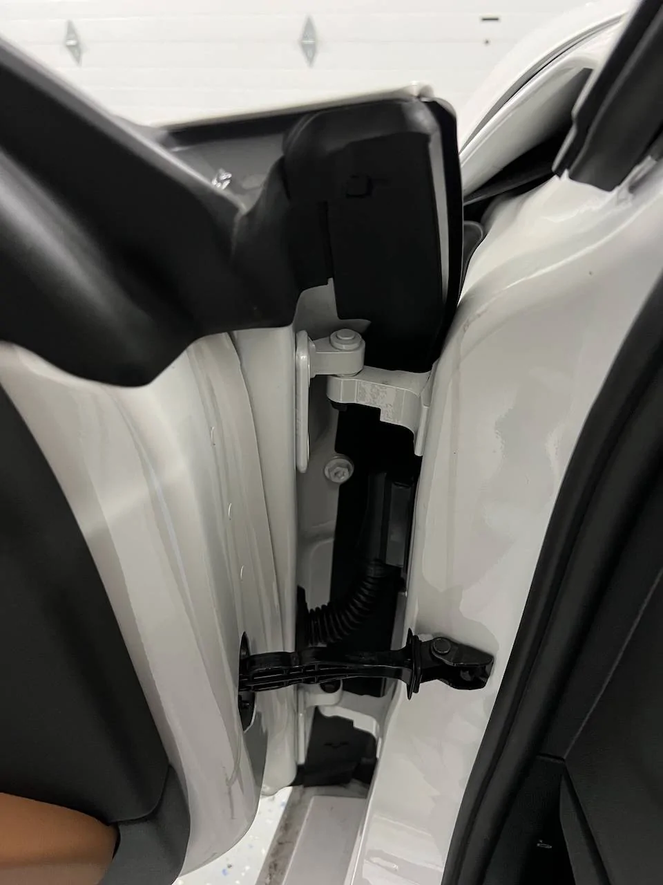

The door gap in the rear was fixed by adjusting the striker, torque spec is 21NM. It’s a very common issue on almost all BMWs so the instruction is everywhere.
