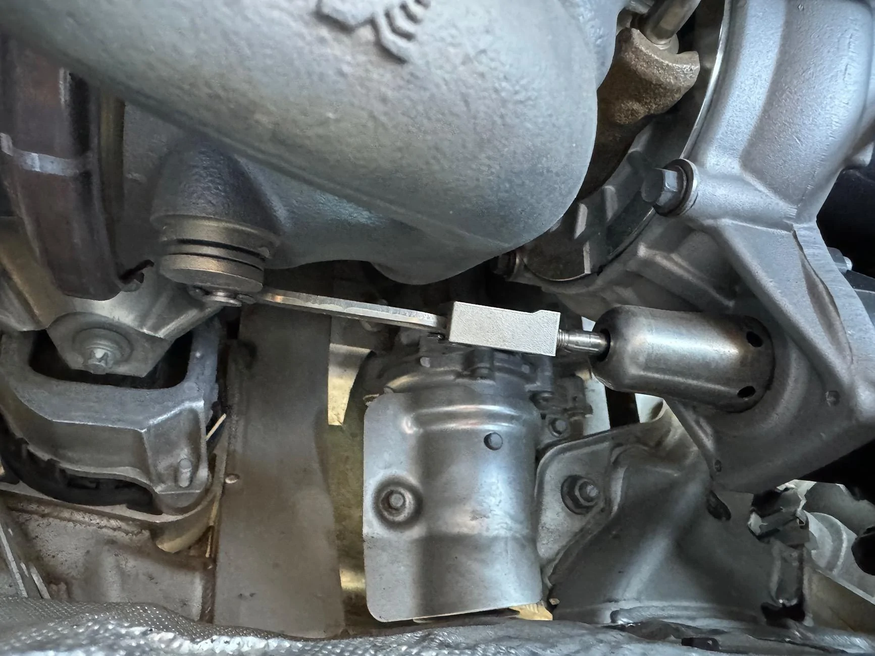

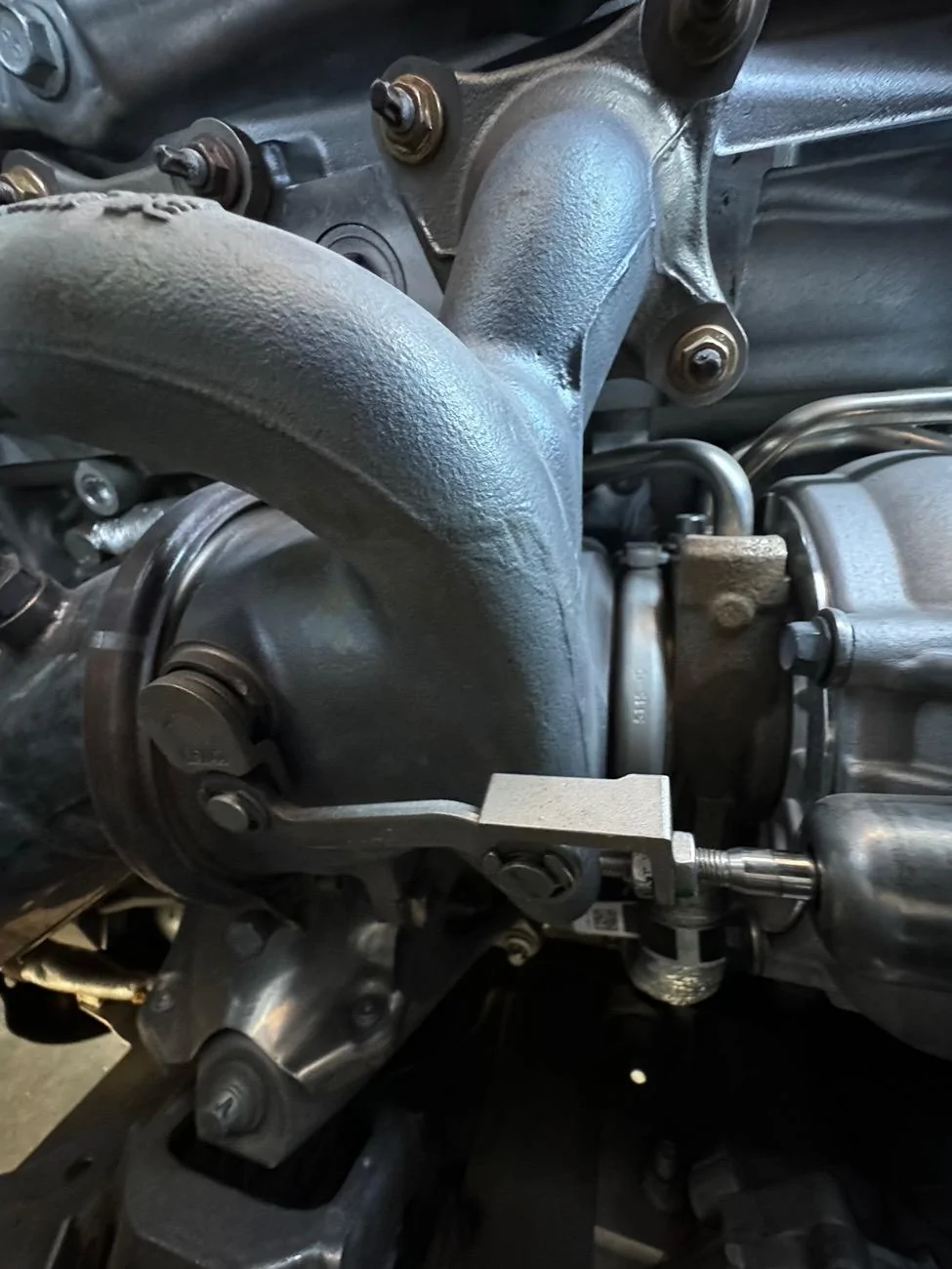

Please share pictures of the actuator, especially the piston coming out of the wastegate; the linkages secured with C-clips; the green-painted nut; the connector and wiring that is plugged into the EWG.
The 123516 code can be caused by a boost leak, so make sure your cold side is reassembled correctly if you took it off to do the valve cover work.
Also be certain that your battery is actually charged. No, I do not mean "the car starts so it must be good, right?" Actually check it with a trickle charger or a multimeter with awareness of the appropriate float charge for a full battery. Low battery causes all manner of weird issues on BMW and Mercedes vehicles.
Lastly, the EWG could simply be bad.

You don't have the downpipe clamp rotated in a way to block the WG arm right?

Could it be that the flapper-valve pivot pin is seizing up?

Here are pictures and video of the actuator moving. I evidently had a bad battery I replace with and coded the battery to the car but the codes still popped up…..
