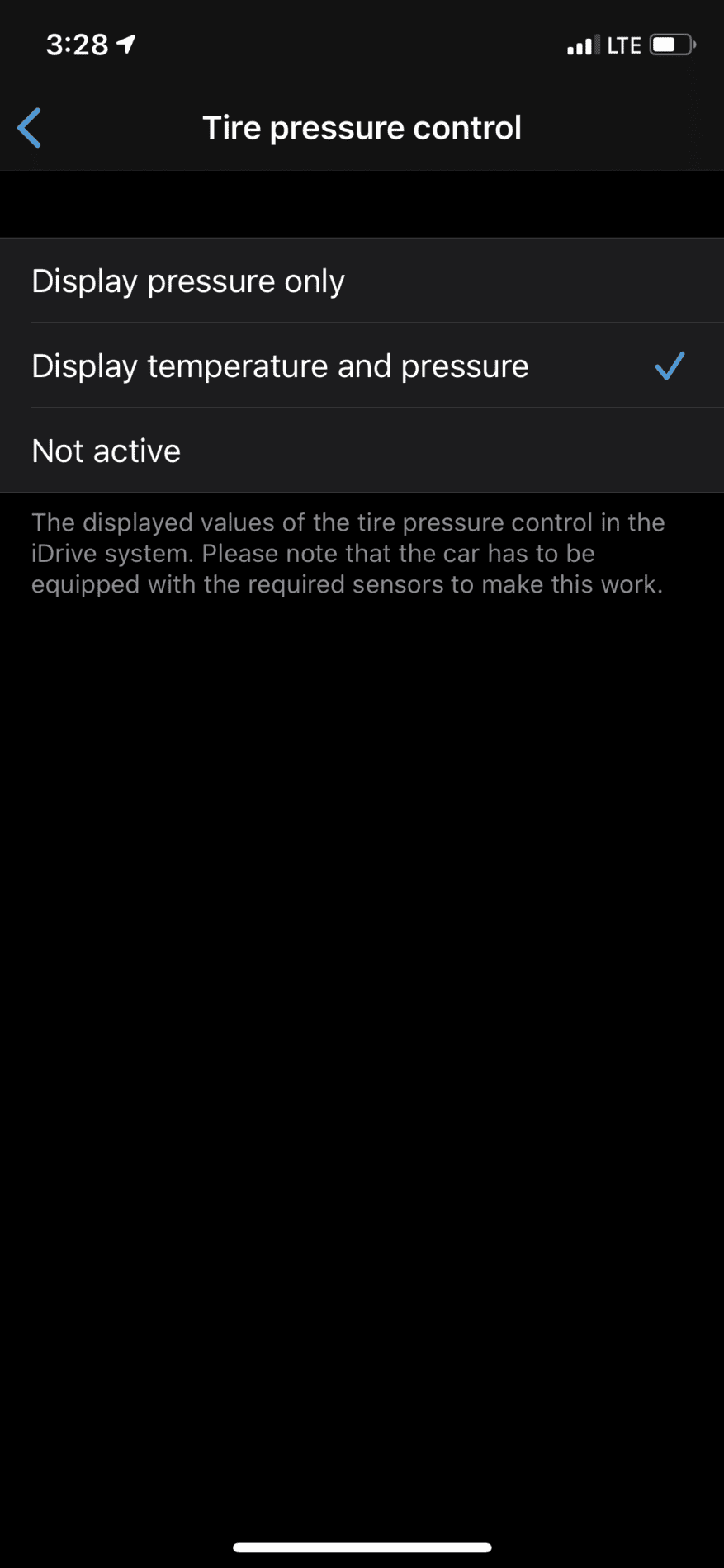

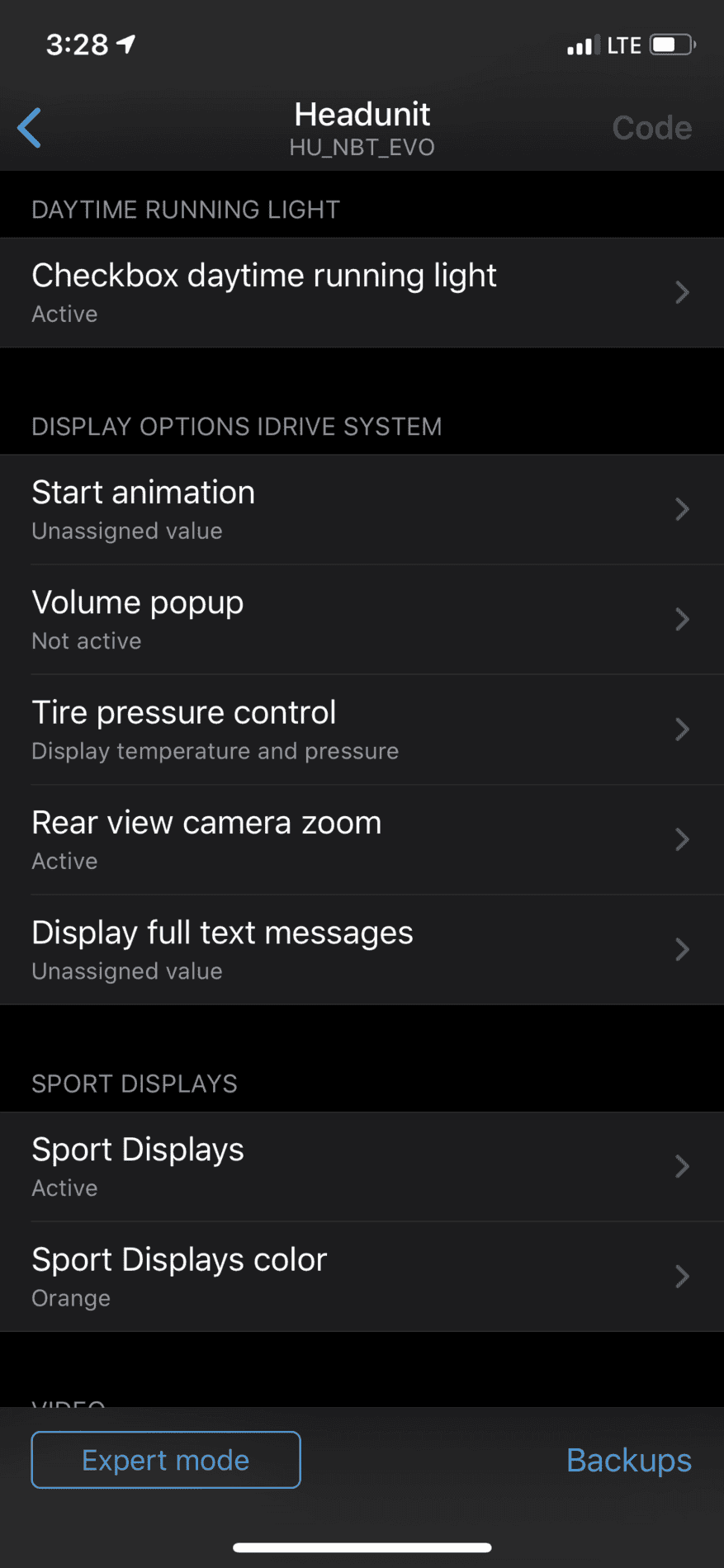

Has anyone tried turning off TPMS with Bimmercode in Headunit? Not sure it this just turns off display or actual reading of sensors?

Did you use BimmerCode for that? If yes please explain what did you select and where.

I see above @CarGuy11 mention's trying to code out the TPMS warning in the display, but I imagine it is just that, the display, and the computer will still see the car as having low tire pressure, and not allow VSC to stay off. Would really love a solution to this.
