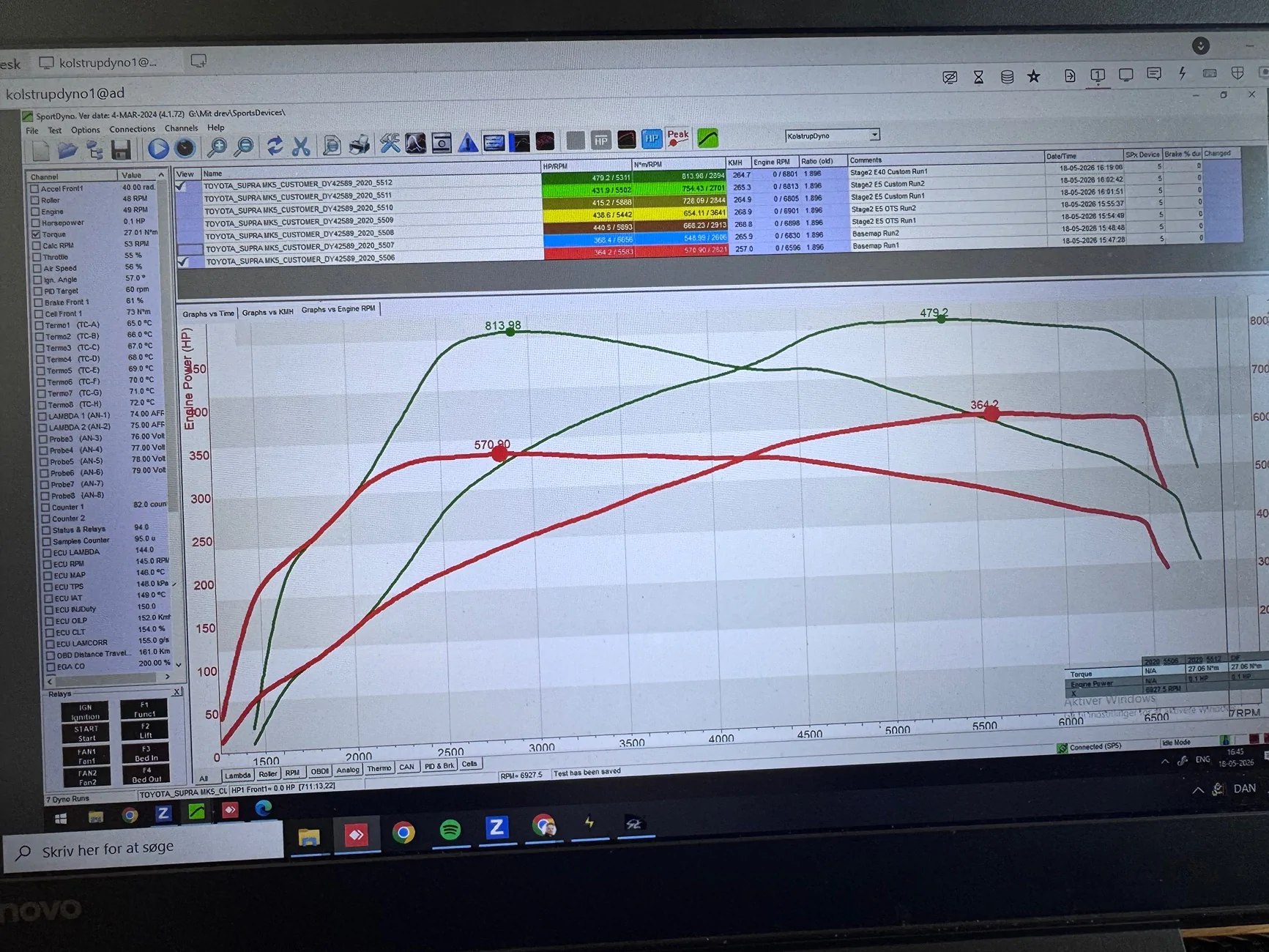

Just finished dyno’ing the car.
Catless dp and custom flexfuel (e40) tune.
If I add the discussed slicks, Will the stres be to much on the drivetrain?
The transmission / driveshaft / diff can handle it no problem.
Stock axles have a history of snapping on ethanol tuned stock turbos. It isn't a guarantee and many users never have an issue, but if you plan to hit the drag strip often / launch the car a lot, especially with semi-slicks or slicks, I would recommend saving up for better axles; better to be safe than sorry.
