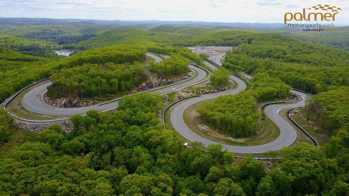

Palmer is another track I attend, 2.3 miles. Palmer has a crazy amount of elevation changes, basically a roller coaster ride of a road course. Lots of heavy braking. Depending on counter or normal clockwise config, the car hits 120-130mph in the front straight and into very heavy braking zones. Last event I was there it was 95*. Brakes worked all day long. Seven sessions.
Photo of Palmer showing how much of a roller coaster it is and NOT easy on brakes:
My one gripe with my current setup is that the Club Racer pads lack the initial bite that pads like the ST47 and CSG C21's do. That said, they still haul the car down just fine all day long, on stock OEM rotors.
