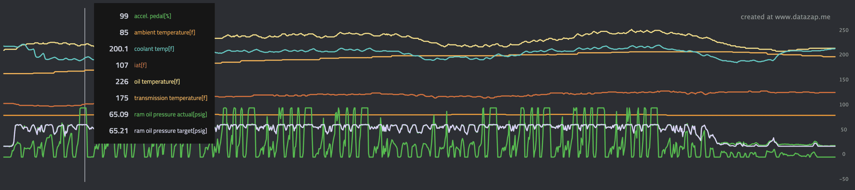

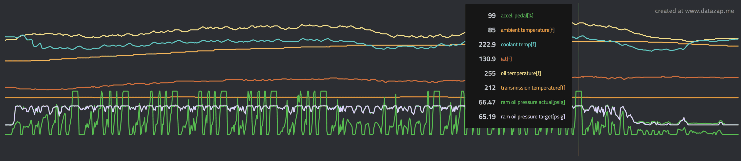

I can add some data here.
Oil pressure hits oil pressure targets with no issues at the beginning of the session and at the end of the session with all temps up in this log:
Oil pressure look fine. All the temps are "getting up there" but safe. What oil grade are you running?
