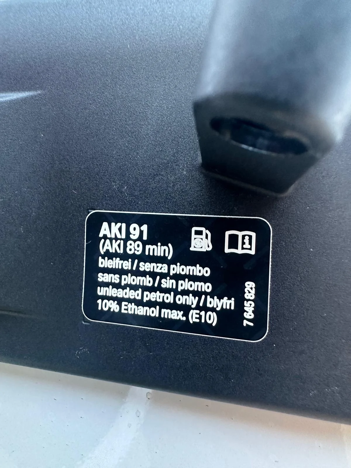

I was wondering how much ethanol can a stock Supra run? If any at all? Does anyone know?
My fuel cap says up to e15. But people on here disregard and run it up to e50 or so...... Run it at your own risk lol
e50 on stock car no tune.. uh no

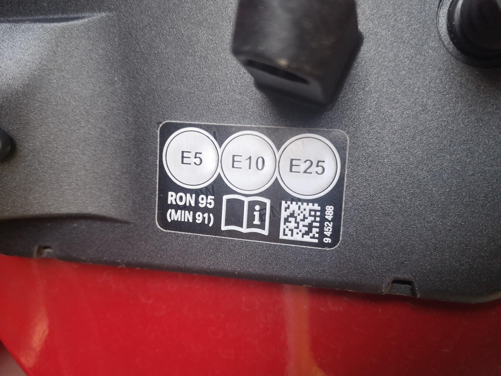

Eplejus
Morten
Sep 15, 2022
213
456
Norway
2020 A90 Supra 3.0 Premium
Sticker inside the fuel cap cover says up to E25
You're not in North America, so I can see that being a bit different
