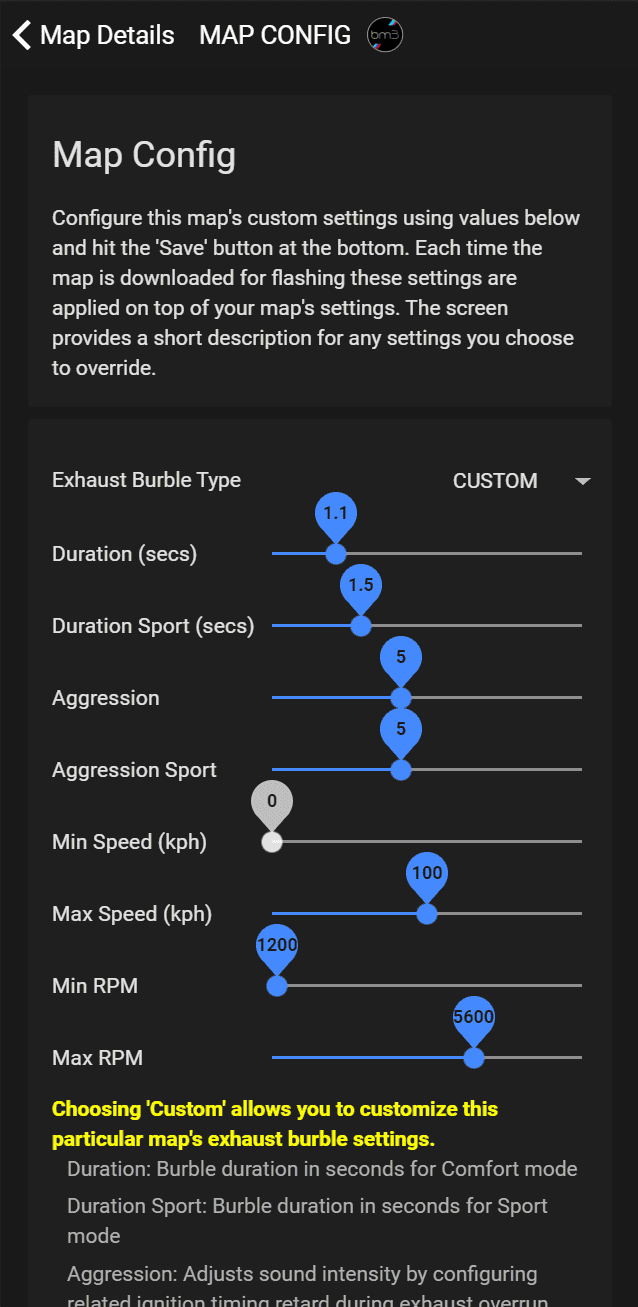

Mine sounds like gunshots as well ? did you just disable it or adjust the settings real low?
Under custom. Messed with those settings until i got it right. Only on a hard accel/decel.. 1 to 2 pops

Thought OEM was way to much as well, here's my custom burble settings, I feel is just right, you can use this as a baseline and go from there. Much less aggressive than OEM and more nice humming burbles vs. gunshots.
Thanks for this, I felt the OEM burbles before flashing were just fine, but clearly OEM in the BM3 settings is just not the same OEM, OEM. It's something else.
