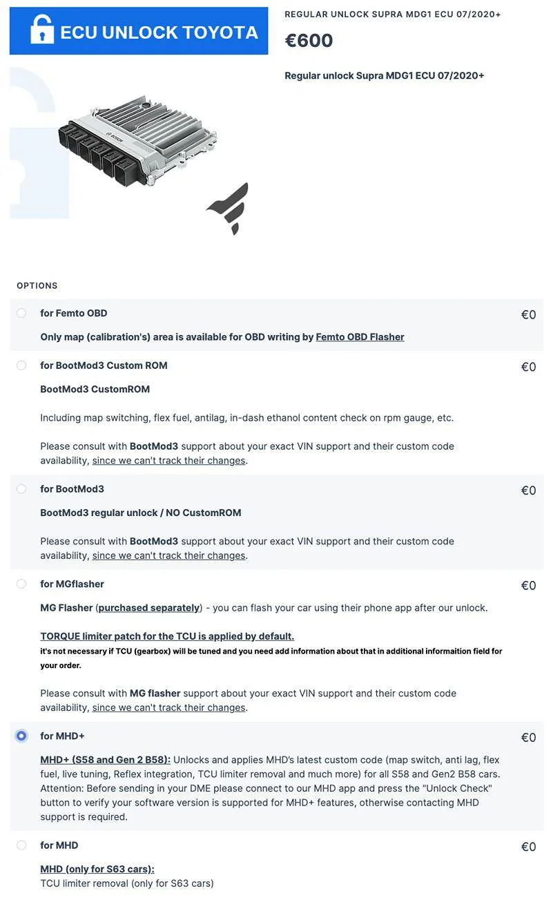

Sorry all but I have some more questions. I keep reading about MHD+. If I send my ECU the Femto treatment now, will it need to go back for MHD+ when (if) it is released. Also, are we missing much without having MHD+?

MHD+ has been released for some time now and an option during Femto unlock.

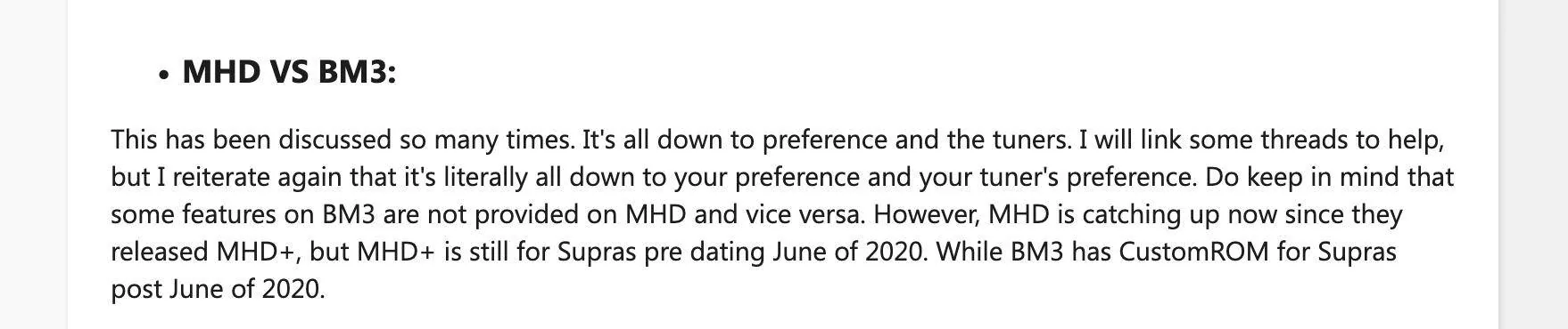

Does the routes to big power thread needs to be updated or is it correct in stating that MHD+ is only for Supras pre-dating June of 2020?
..Or do you mean that I can get Femto to prepare the ECU for MHD+ and then wait for MHD to catch up?

It's avail to femto unlocked post June 2020 DME's as well. I know of at least five 21+ people with MHD+ on their Supras.
I think maybe the only outlier are the manuals.

@BMWAF - I have MHD+. It went to Finland twice. Once for MHD and again for the Plus stuff. Both times went with Euro Performance Center.

So could I get Femto to set me up for MHD+ but just use regular MHD if that's all I can use? Or do I have to like you, step through?
