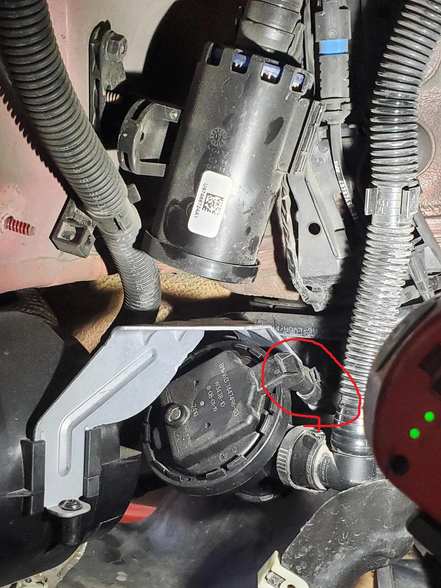

The picture attached shows the EVAP canister/sensor assembly in the rear wheel well with the liner removed. There is only 1 visible clip there that can be disconnected. I'm thinking to detach it and zip tie somewhere safe and see if that just stops the EVAP sensor from doing it's thing. Not really a bypass but just a shut down. It's worth a try... any other suggestions?
*All the parts seen in the picture were replaced.

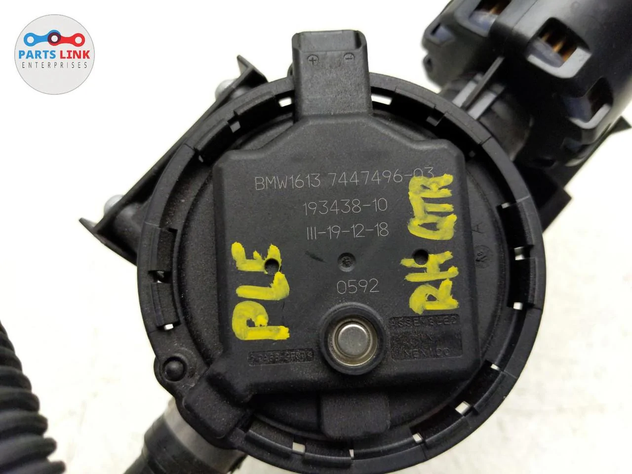

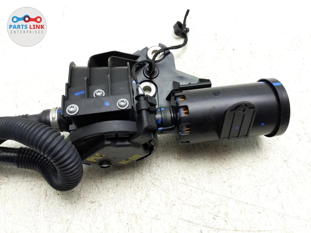

Added 2 more picture for reference: This is the EVAP pressure leakage sensor. Which is the only thing in that area with an electrical connection.
