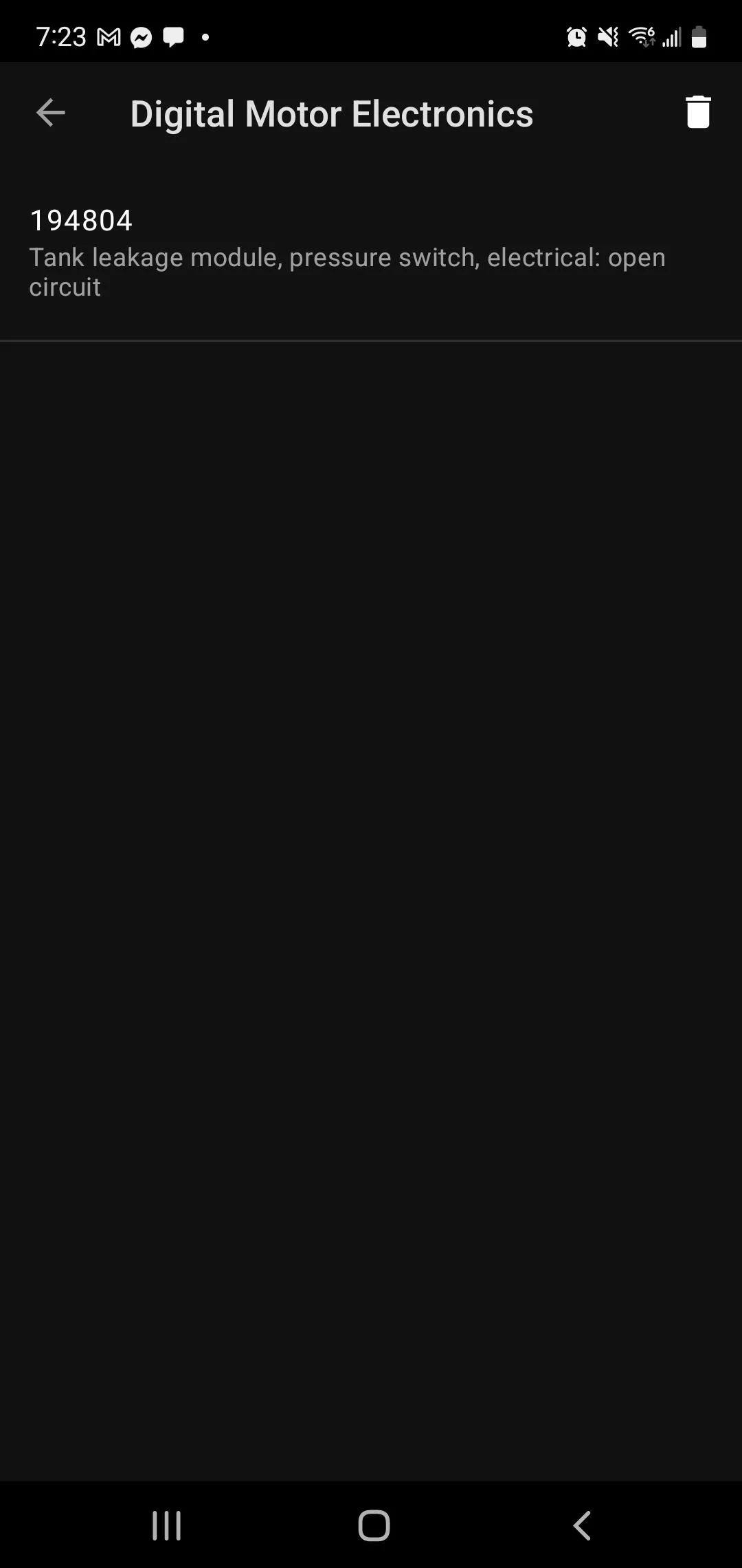

Pulled details from Bimmerlink, cleared code drove around and it came back. Anyone had this before?

Google says perhaps you should visit the dealer as there may be fuel vapor leakage... Or some sensor error causing the open circuit...

Seems that way, just concerned that Toyota mechanic won't really know what to do.

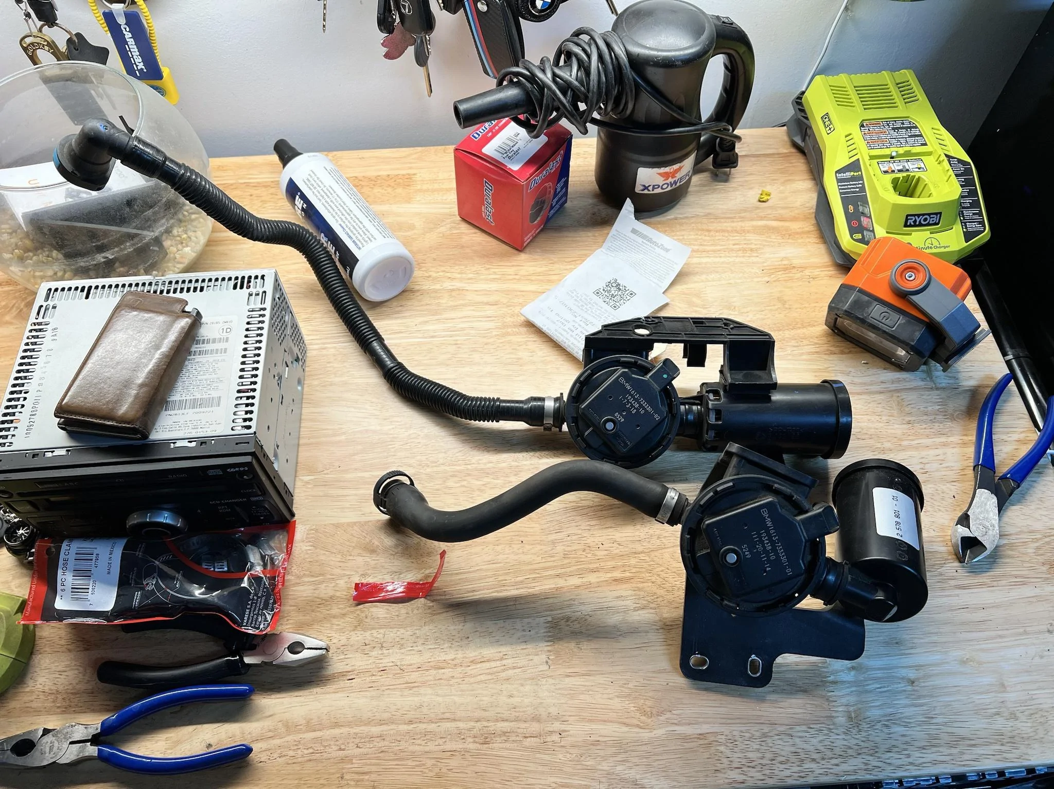

Dealer diagnosis,
Replace Canister SUB-ASSY, Part# 77704-WAA01, to be replaced under warranty. No idea what caused this. Some people say maybe the previous owner forced extra gas in the tank after the pump clicked. Car only has 13,000 kms, (8000miles), but she is a garage queen.
EDIT: Part on back-order, 1 to 2 weeks

Update:
Tech verified charcoal canister assembly found a hose or tube that was damaged that's not apart of the new assembly. Part on back order. 10 days minimum. Car remains at Toyota. Pretty disappointing for a car with 13,000kms. And an uncommon issue on top of it. Going to miss the next Femto service again, lol.
