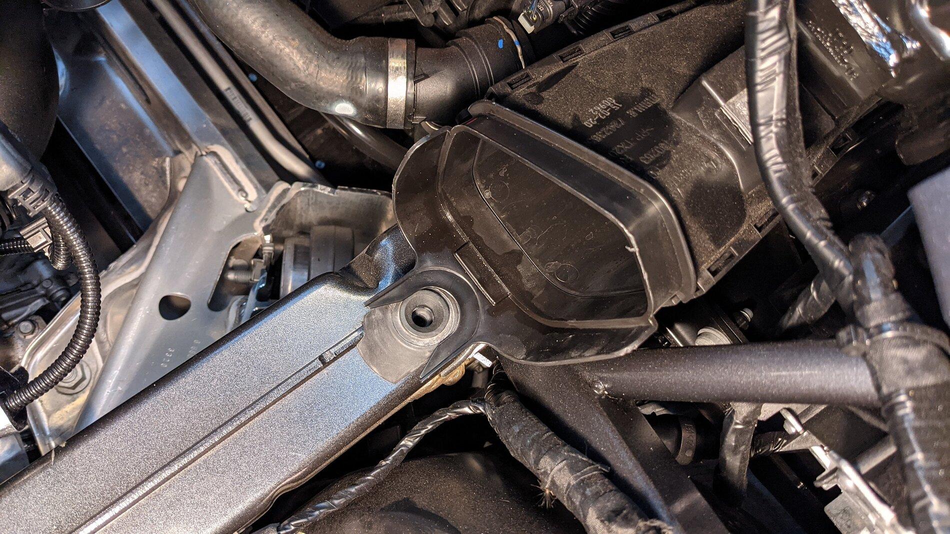

Yeah, it feels great and if you apply the coats light, it doesn't pool as bad and fill in the ridges. I did use a tiny hobby paint brush to help in some places.
I have begun my 2 week long install lmao.
Mostly waiting forever for stuff to come in the mail. Ordered small polishing pads for the dremel to polish out some light scuffs and smooth everything out. Took a few hours to do that today. Next I'll apply ceramic coating, probably tomorrow.
Also waiting on a replacement piece to come in since the one I bought did not include the panel that comes off for the headlight brake duct.
Another thought: if I have trouble keeping the inlet attached to the turbo, I MIGHT buy the CTS turbo inlet, cut it at or near the inlet adapter, and create my own hybrid adapter for the eventuri to attach to. Just brainstorming in advanced though.
Another delay, I might also wait to install the things I've been hoarding until after i take it to the dealership for the brake booster recall, so they don't annoy me or document my mods lol.

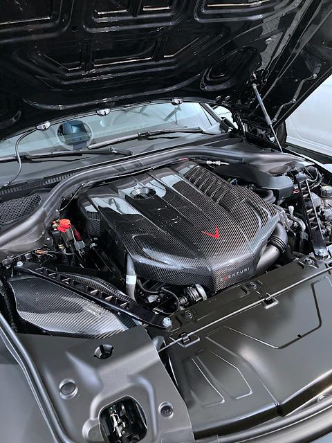

Took it for a test drive. I expected more intake noise, but the car is dominated so much by the loud AWE exhaust it can be difficult to tell. No doubt the thing is like a rocketship - it definitely added more power, probably moreso because of some of the other mods I have on the car. But, it seemed to change the... character of the car? It's hard to put my finger on. The throttle feels... different. Anyone else experience anything like this?
I had a similar issue with my Eventuri intake; it was louder than stock, just not by much. After swapping to the Armaspeed--while not as functional, the sounds really came to life in a big way.

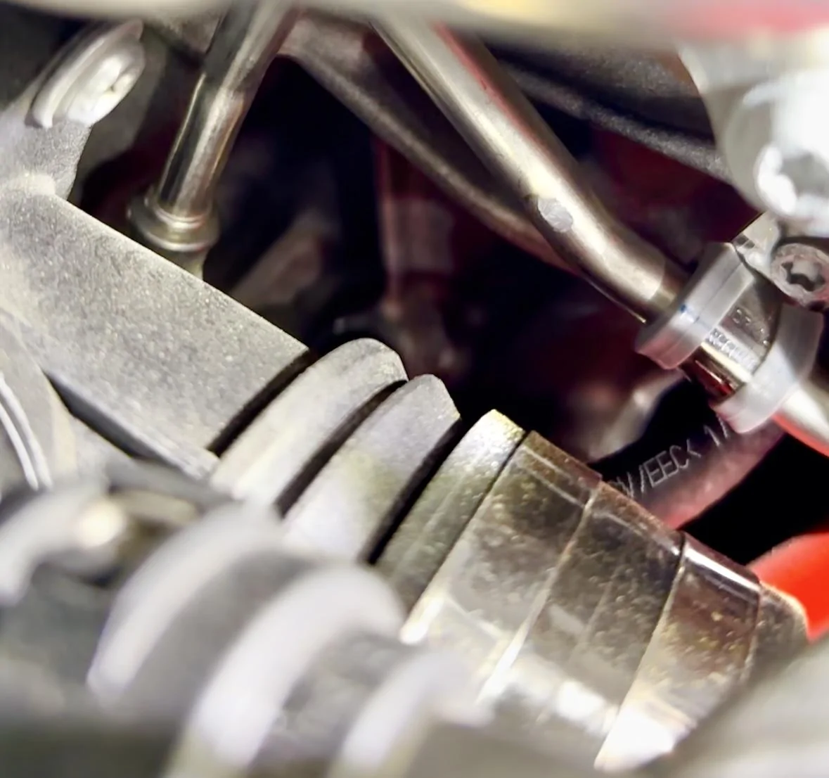

Anyone have an issue with eventuri coupler slipping off the turbo inlet?
It looks like eventuri revised their installation guide and is now including a new part with the intake (see steps 8-11 in the minke below). I wonder if I can buy that piece separately… I contacted them like 10 mins ago so obviously they haven’t responded yet.
I don’t believe I ever received this new part and I don’t see it in the Kies Motorsport install video either (what I used to install my intake) so I wanted to see if anyone was having a similar issue of the intake slipping off.
Link: https://www.eventuri.net/wp-content/uploads/A90-Supra-installation-V2.pdf
i had the same issue, but eventually i tightened the giant hose clamp enough to where it wouldn’t come off.
eventuri did revise it to include the new snap on ring, but you have to contact eventuri directly, They’ll send you one
Thanks for confirming!
Guess, I’ll go tighten it again til eventuri responds.
Yes, the post you're replying to is my odyssey with exactly that (and other problems). It's the reason I dumped the $1400 intake. It's horseshit, and a poorly designed product. I'm glad they fixed it but it's terrible they waited so long. I'm sure there are plenty running the product that don't realize they are having this issue. I would love to run their kit, not for the bling, but to combat heat soak. No damn way I'm giving them another cent.
I know it's tough to tell but I'm a bit bitter about it.

Yea unless you get in there and jiggle the mofo you can’t tell it’s not securely connected (at least I can’t).
What intake did you end up going with or did you go back to stock?

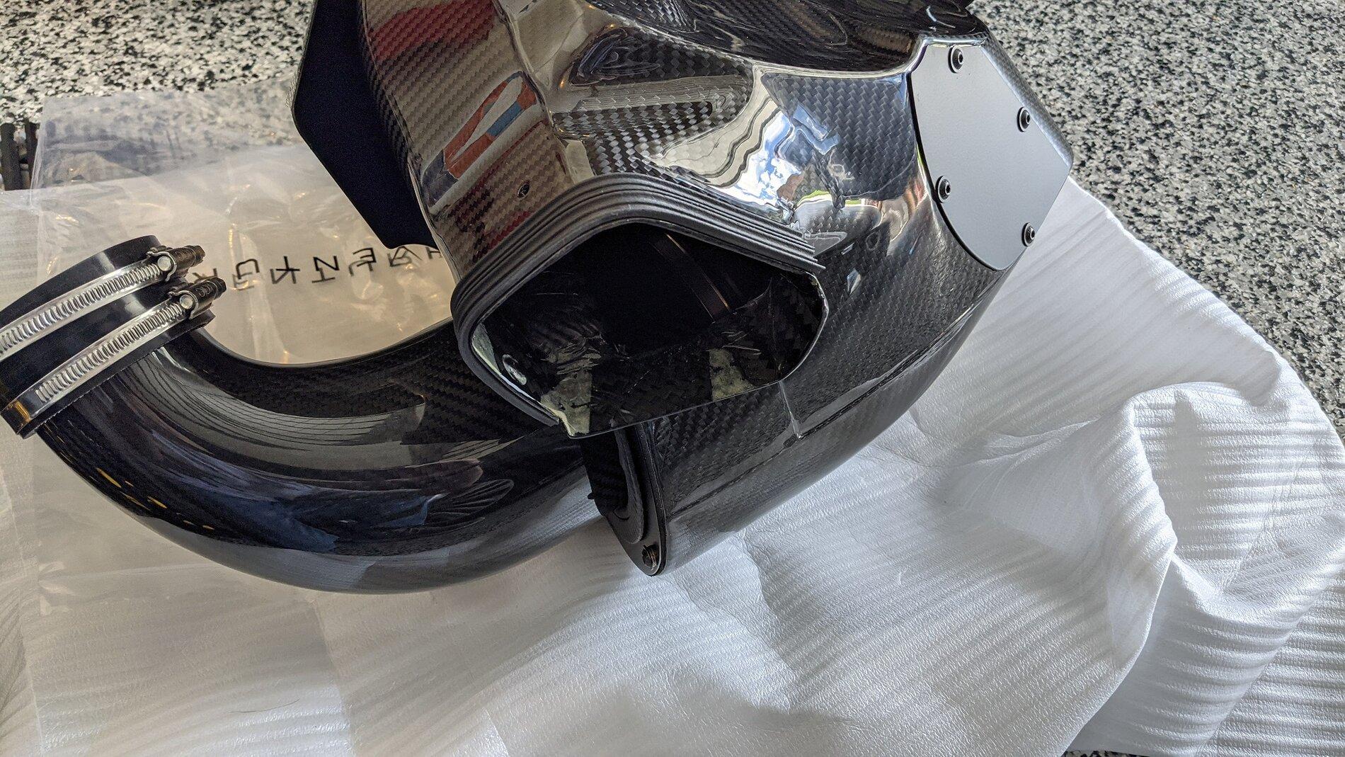

I did end up contacting them and they sold me the coupler for 115 bucks (including shipping). Hasn't shipped yet though...

Mine stayed solid for the first two air filter changes (ha this intake since 2020). Then this crap started happening. I THINK I got it tight enough that it hasn't slipped off in few of the last drives but I still want that coupler that I'm now waiting for from eventuri.
