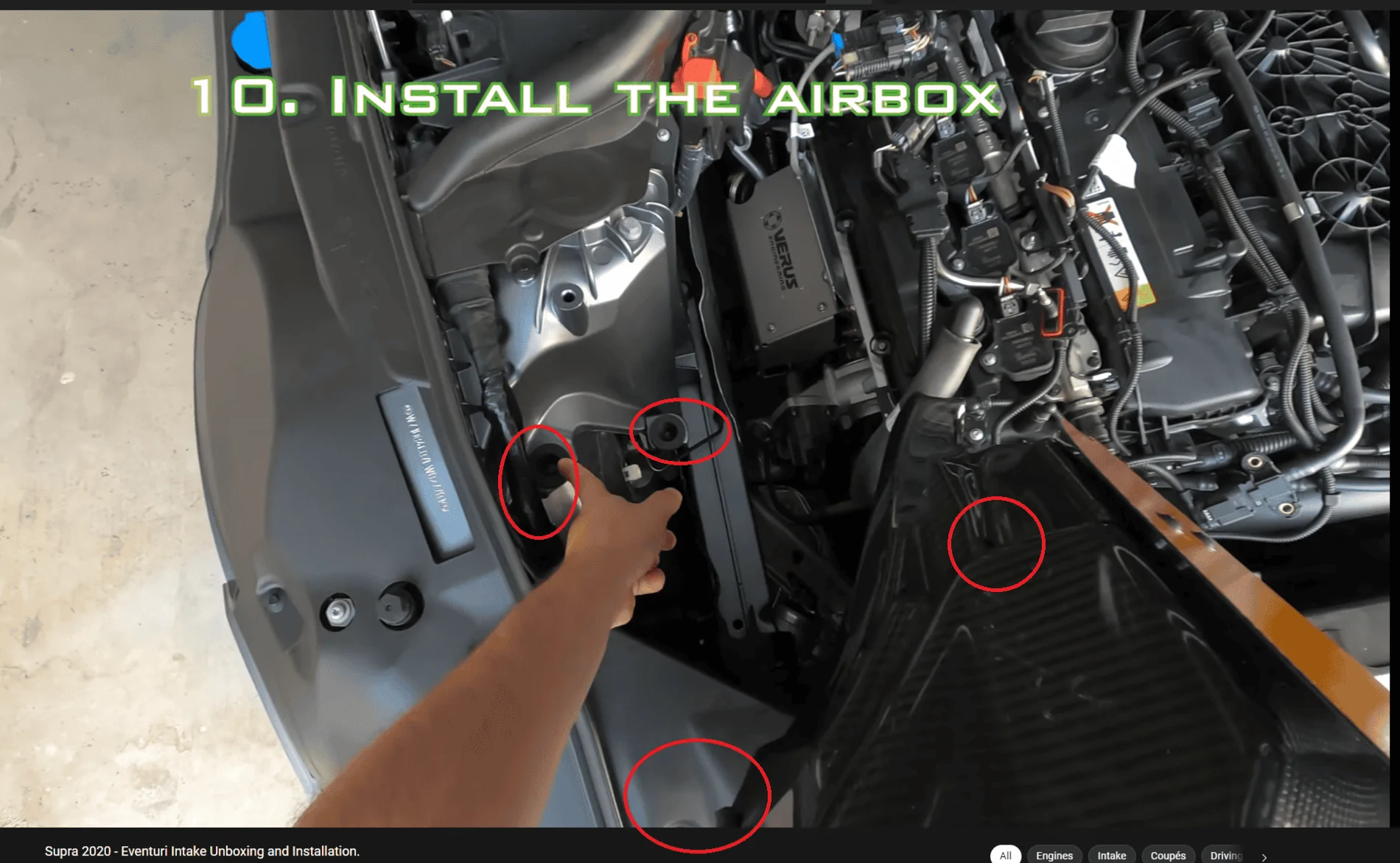

Not to advertise my video but I installed the airbox step by step:
As for Power I didn't notice anything different, if anything I wanted lower IAT than the MST and for that it worked. Sounds a bit louder than stock, but not by much.
I actually used your video! Thanks for putting it together. It was the heat shield and either the Verus AOS or turbo heat shield getting in the way. I removed the heat shield from the airbox and it fit pretty well. Now that I'm not hot, sweaty, and pissed off, I'm getting ready to actually pull the airbox back out and do the following: 1) Reinstalling the heat shield on the airbox and trimming it where it needs it; and 2) Finding a solution for securing it to the grommet below the factory cold air intake point where the factory airbox pops into, but the Eventuri part has nothing. I think I mentioned it before, but there's a hole in the Eventuri part where it seems like they were on-track to figure something out, but maybe released the product before it was fully-baked. I want to measure and see if that hole lines-up with the opening in the grommet and use said hole for some sort of post to pop it in. Probably not going to make a bit of difference, but I'll sleep better at night.
You are welcome :)
Oh, well this is a 2020 with the manifold with only 2 exhaust ports, so there is more space, I assume the header in the 2021 is larger and there won't be as much space to fit it easily, because I don't remember having issues to install it.
Also the airbox was secured, I remember this two plastic bolts:
So are you saying your airbox doesn't have these two?

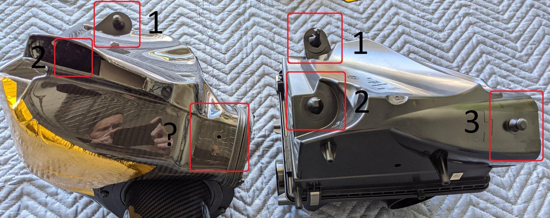

Here are how the posts compare between the airboxes:
Since the shape of the airboxes are very different, and they rest on the ground differently, the perspective makes it looks like the posts are way off, but as you know, they are not. So, you'll see posts #1 and #2 right where they should be and they line-up with the grommets you note above, @Camus. On the stock airbox on the right, check out post #3 and note the hole ("?") on the Eventuri unit on the left. Based on my completely scientific and accurate measurements, this hole is about where post #3 is on the stock unit.

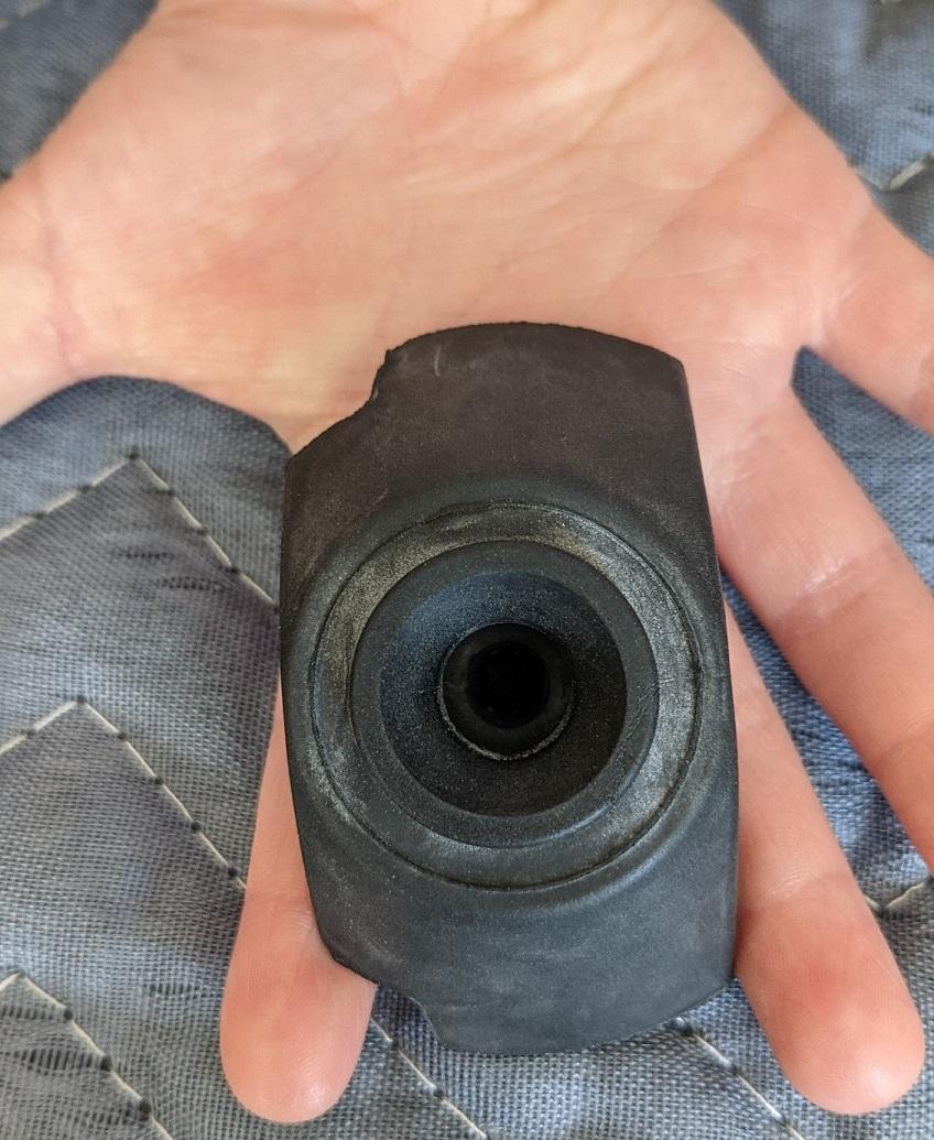

This is the grommet where post #3 fits (the kiddo wanted to help ?):

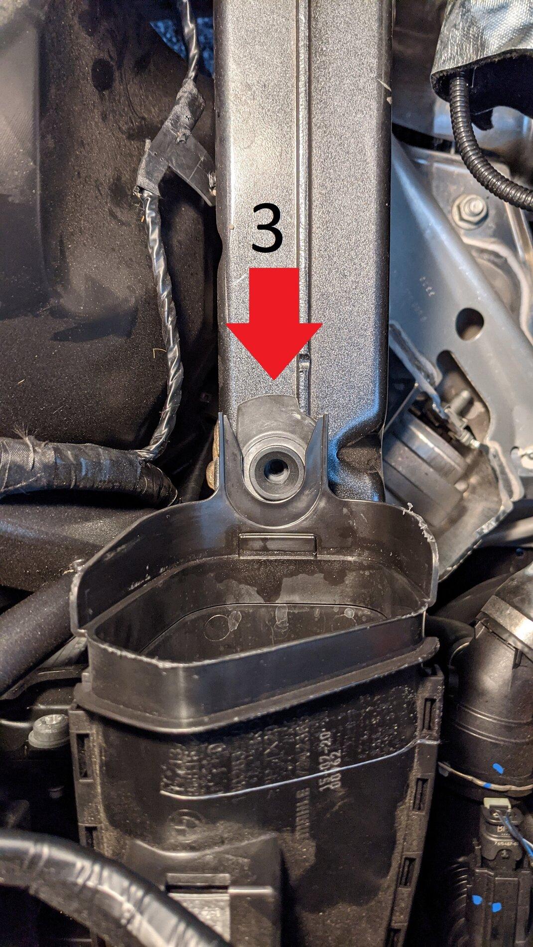

Here's where it is in the engine bay of the car (looking down on top of the stock cold air tube behind the passenger-side headlight):
While the fitment of the Eventuri unit is secure, this unused anchor point is what I believe results in a small gap between the cold air tube on the car and the associated cold air inlet on the Eventuri unit that does not exist on the stock unit (they mate together perfectly). Like a moron, I didn't get pictures of it before I pulled the airbox, but I'd be interested to know if this gap exists in anyone else's car with the Eventuri unit installed? I had actually wrapped the tube/inlet gap with heat tape after installing the Eventuri unit.

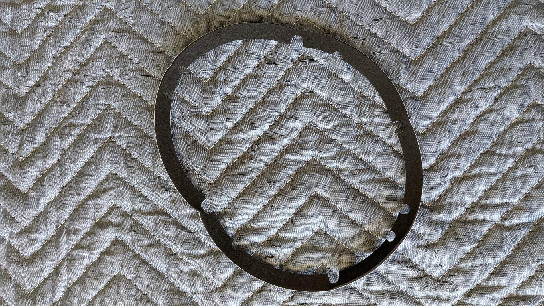

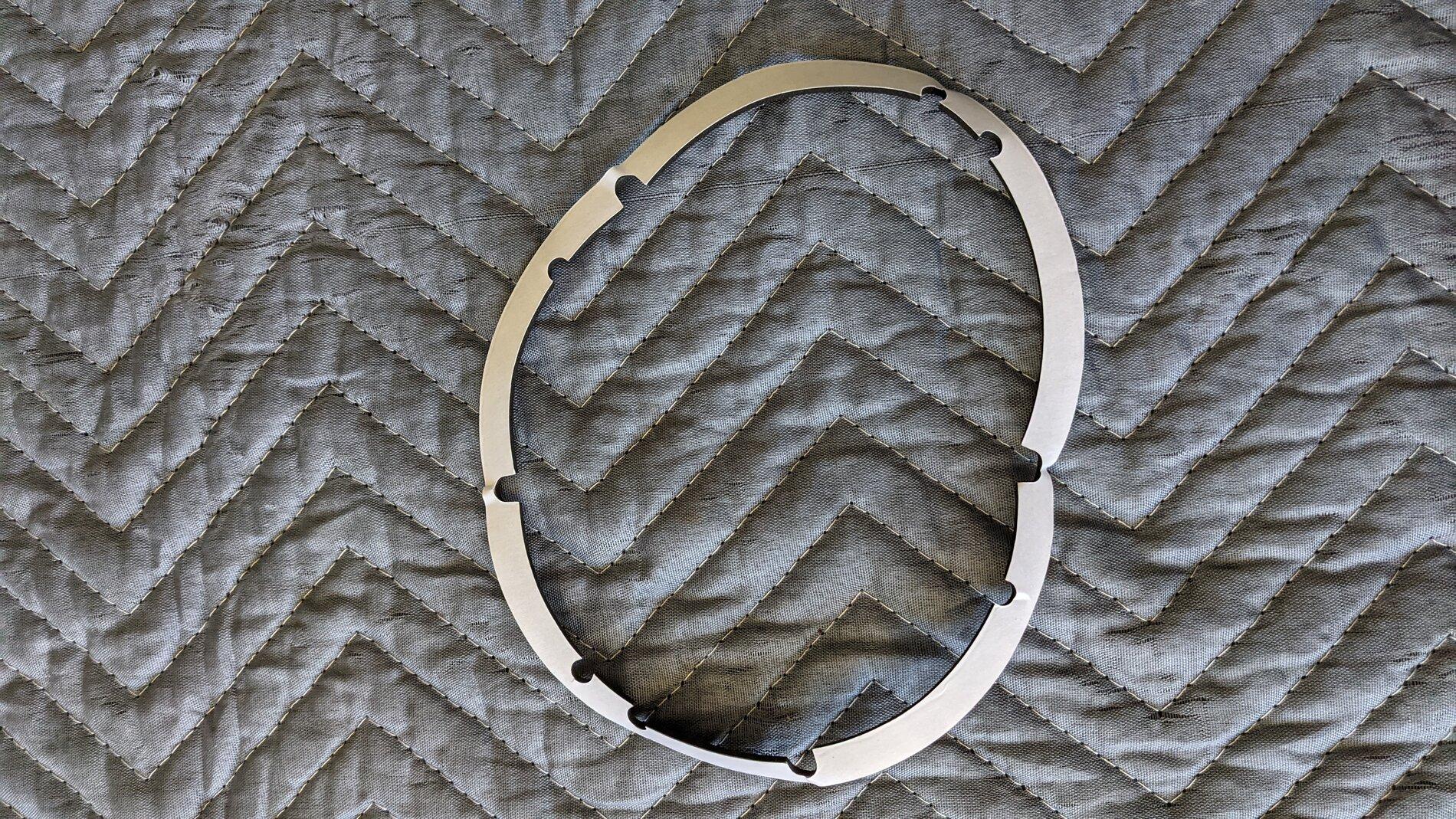

1) I'm not sure what this is - there were two of them in the packaging. The cuts out of the ring don't match up with anything on the airbox. They seem to be about the correct size for the opening where the turbo inlet tube (with filter attached) enter the airbox, but again, the cutouts don't match up with the hardware pattern. They are a foam material with adhesive on the back (which is covered with the waxy paper you'd normally find on tape:
They do not appear to be on the inventory shipped with the component:

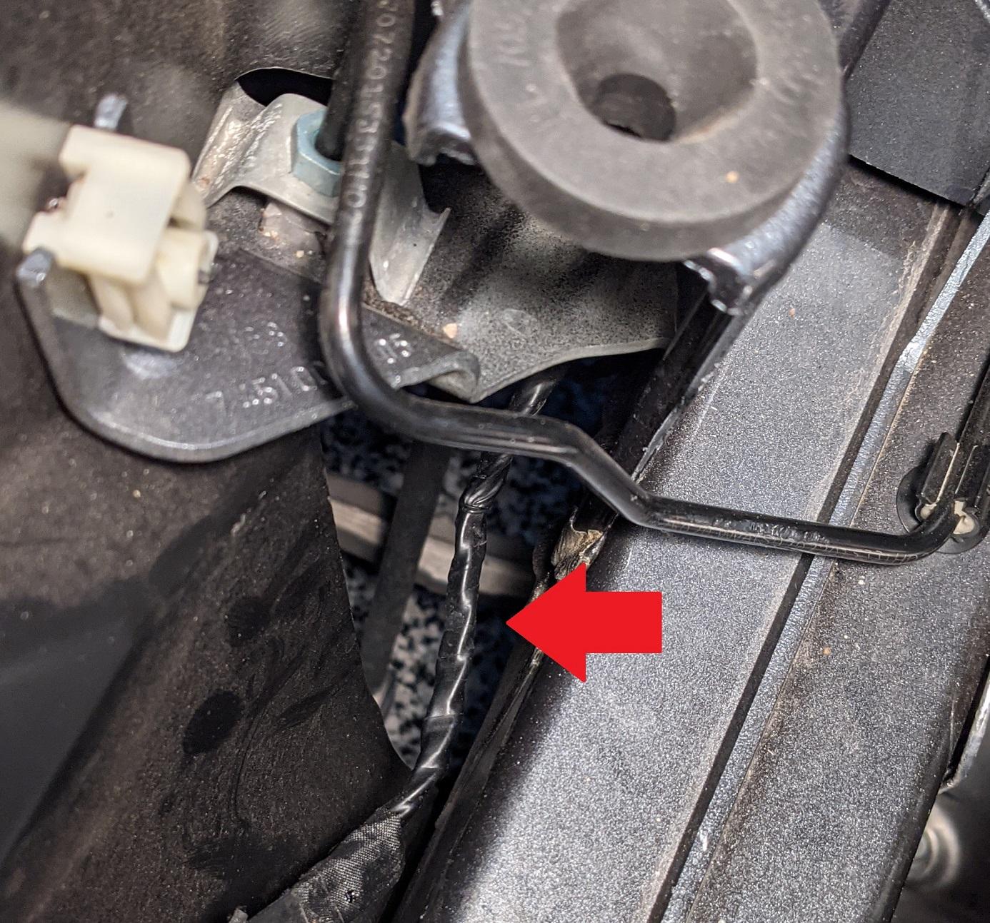

2) The gap below (you can see the garage floor - black/grey/white flake - through it) seems to be the "extra" place where the Eventuri is pulling cold air from. This wire runs through the opening, however. The port which extends from the Eventuri airbox may apply some pressure to this wire after inspecting it post-airbox removal. I haven't confirmed this, and it's as simple as taping the wire to the rail beside it (there's enough slack), but wanted to mention it to anyone who finds this thread. I have no idea what this wire/wire bundle goes to.

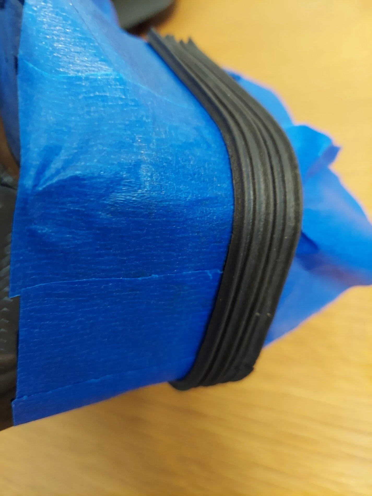

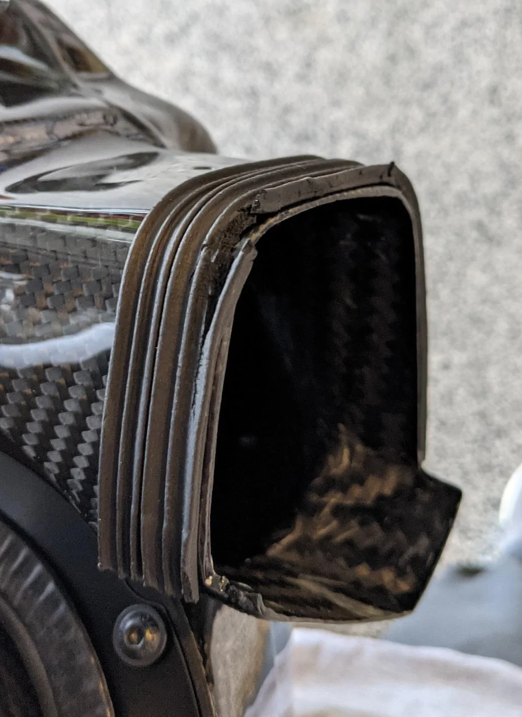

3) The material that's on the primary inlet (which mates to the stock cold air tube behind the headlight) on the Eventuri airbox seems to be a very, very fine, delicate foam. This feels nice when you touch it, but appears to come apart pretty easily. Granted, I was pretty rough with the component when installing it. I would have expected this to be a rubber material to provide weather resistance and form a better seal. BUT, I'm not an engineer nor do I design car parts. I have, however, been modifying and working on cars for 25 years (yes, I'm old) and I've never come across anything like it in an engine bay. Maybe I just need to buy a McLaren or Ferrari. ?

1) The wire noted above that went through the opening to the wheel well that the Eventuri system utilizes was definitely causing fitment issues. I used some heat tape to attach it to the rail next to it and the airbox slid right into place, clicking into two of the stock grommet locations. I'm not sure if this is a 2021-specific issue or if the wire bundle on my specific vehicle just wasn't secured, but it's something to watch out for when doing an installation of the product.

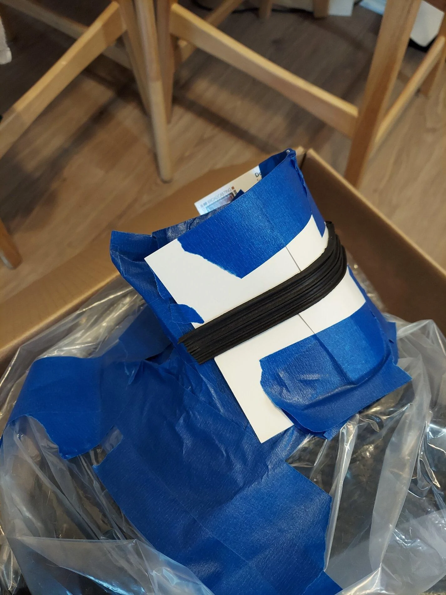

2) If you're running a Verus Engineering air/oil separator (AOS) on your vehicle, the heatshield will need to be trimmed on the top righthand side, from the perspective of holding the airbox in your hands, top pointing up, and looking directly, squarely at the heatshield. It's the corner that will be closest to the AOS when installed. I used some aluminum snips and cut the corner off, resulting in no fitment issues related to both of these components being installed at the same time.
3) The small hole on the underside of the Eventuri airbox inlet that connects to the stock cold air intake is there because it was, in the past, utilized for a post that connected into the unused (on the Eventuri system) grommet identified in my above message (#3). The stock airbox uses this grommet and has a built-in post which snaps right into place. Per Eventuri, using this post was causing "fitment issues" for customers. My observation is that it's because the airbox inlet on the Eventuri system seems to be too short, resulting in the above noted small gap between the cold air intake and the airbox inlet. This appears to be a design issue with the product, and instead of fixing the issue by extending the inlet and realigning the hole, they simply stopped providing the post as part of the overall system. If the airbox inlet was extended 1/2 - 3/4in and the hole was aligned properly (which extending the piece may do in itself), there would be no issue with both the post fitting and the gap with it installed.

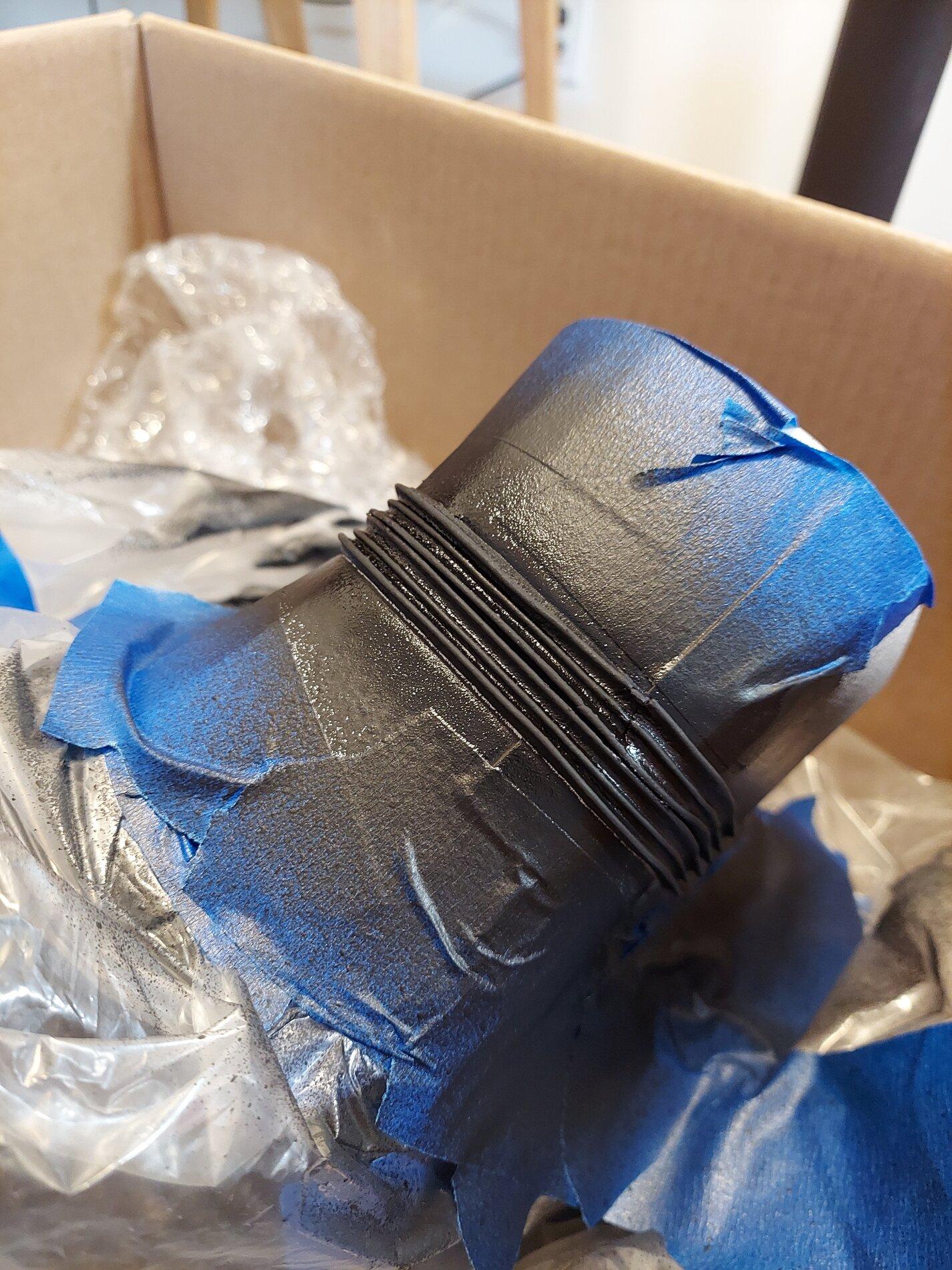

For whoever may be interested, I masked off and coated the foam on the airbox inlet vent with 2 coats of Flex Seal. Strengthens/reinforces the foam
Oooooh this is a good idea! Have you done the install yet?
