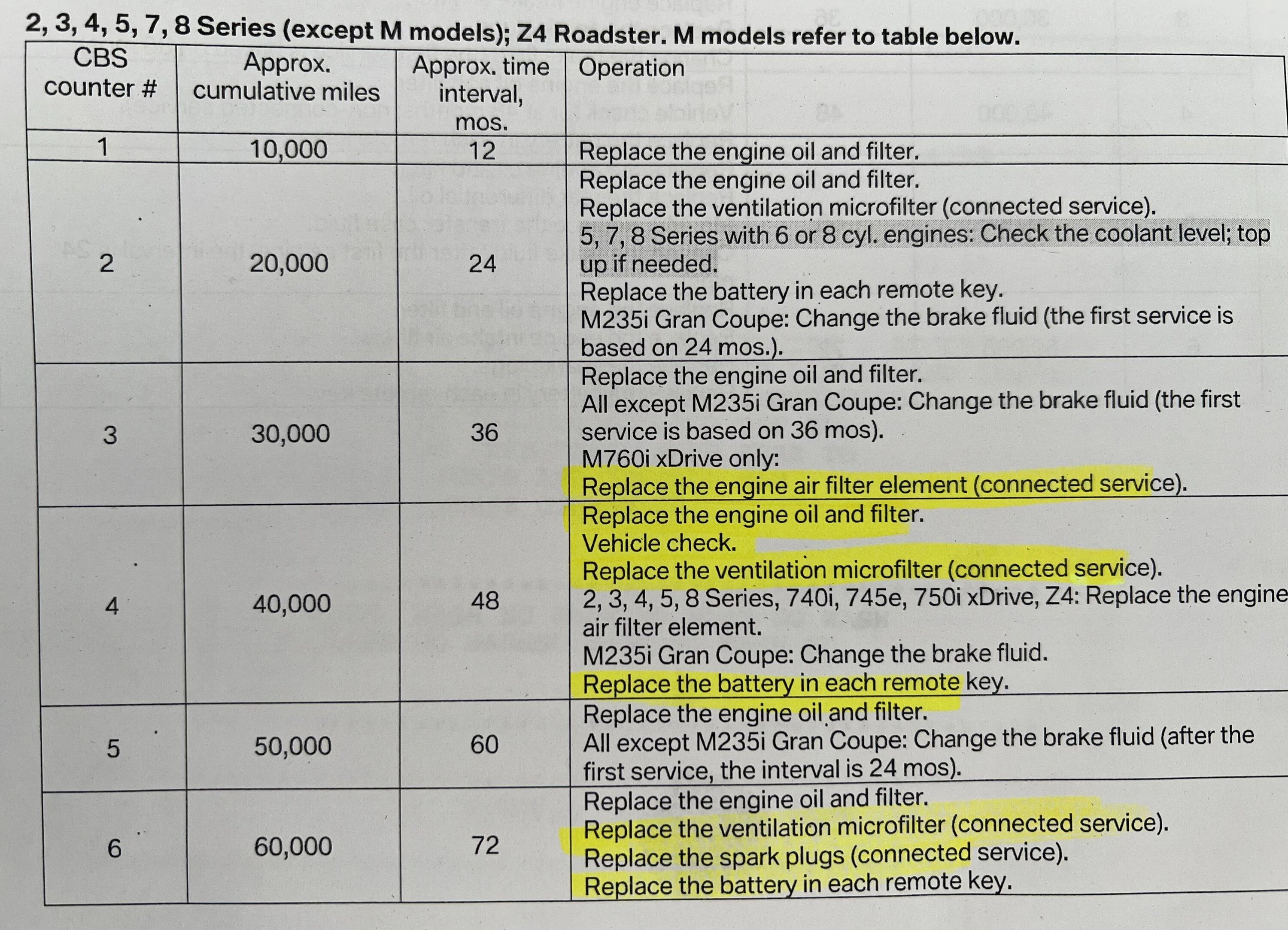

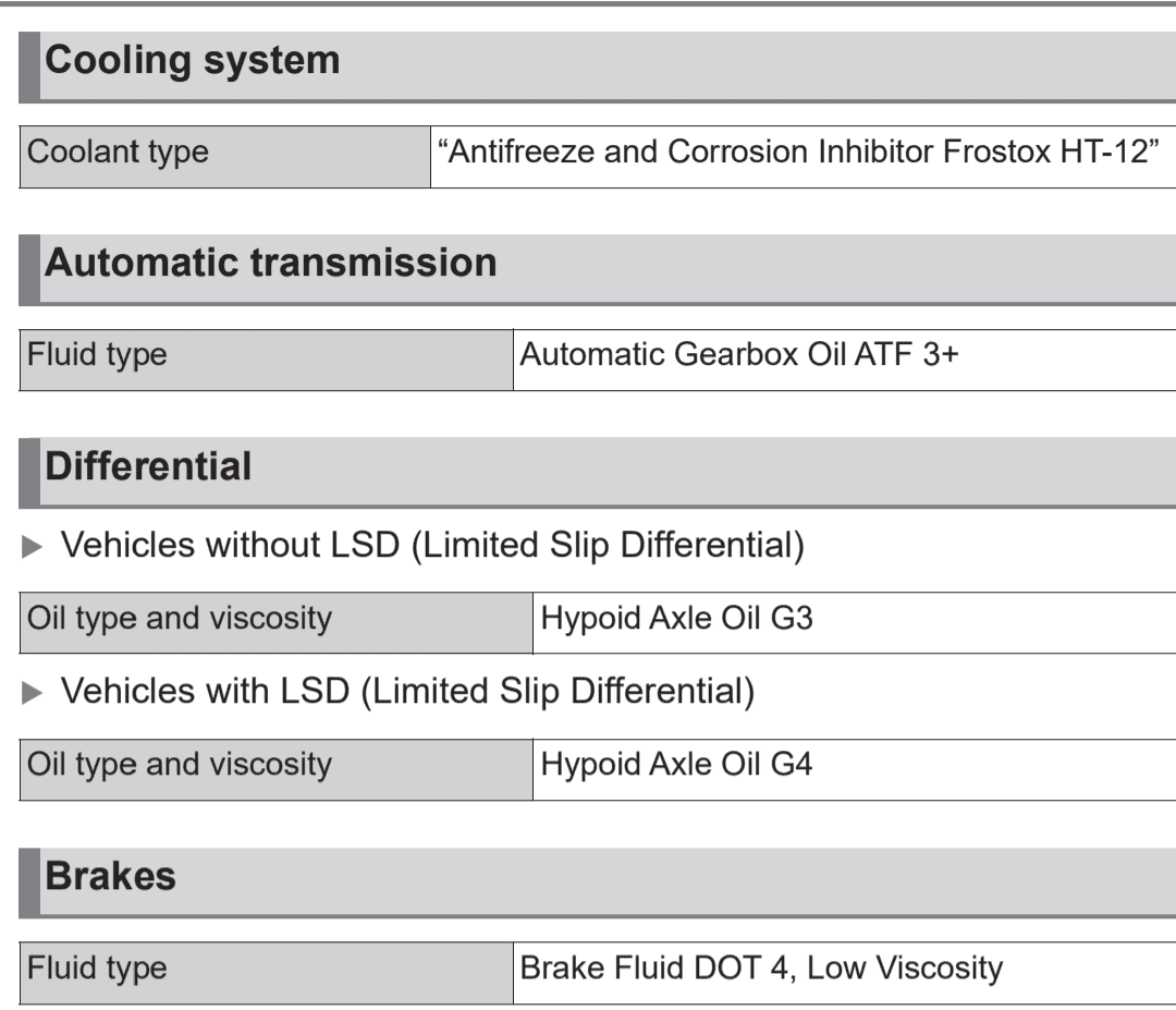

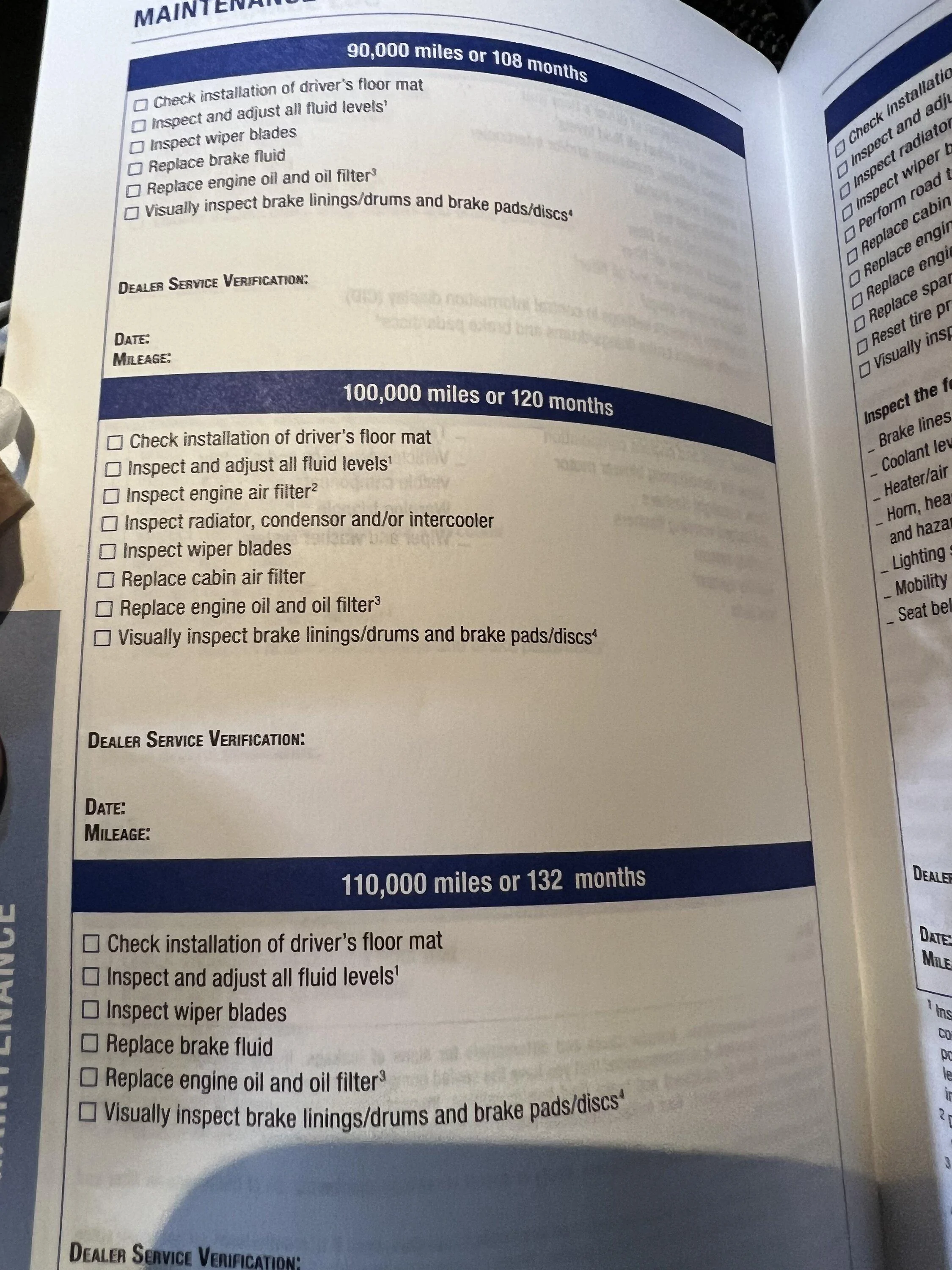

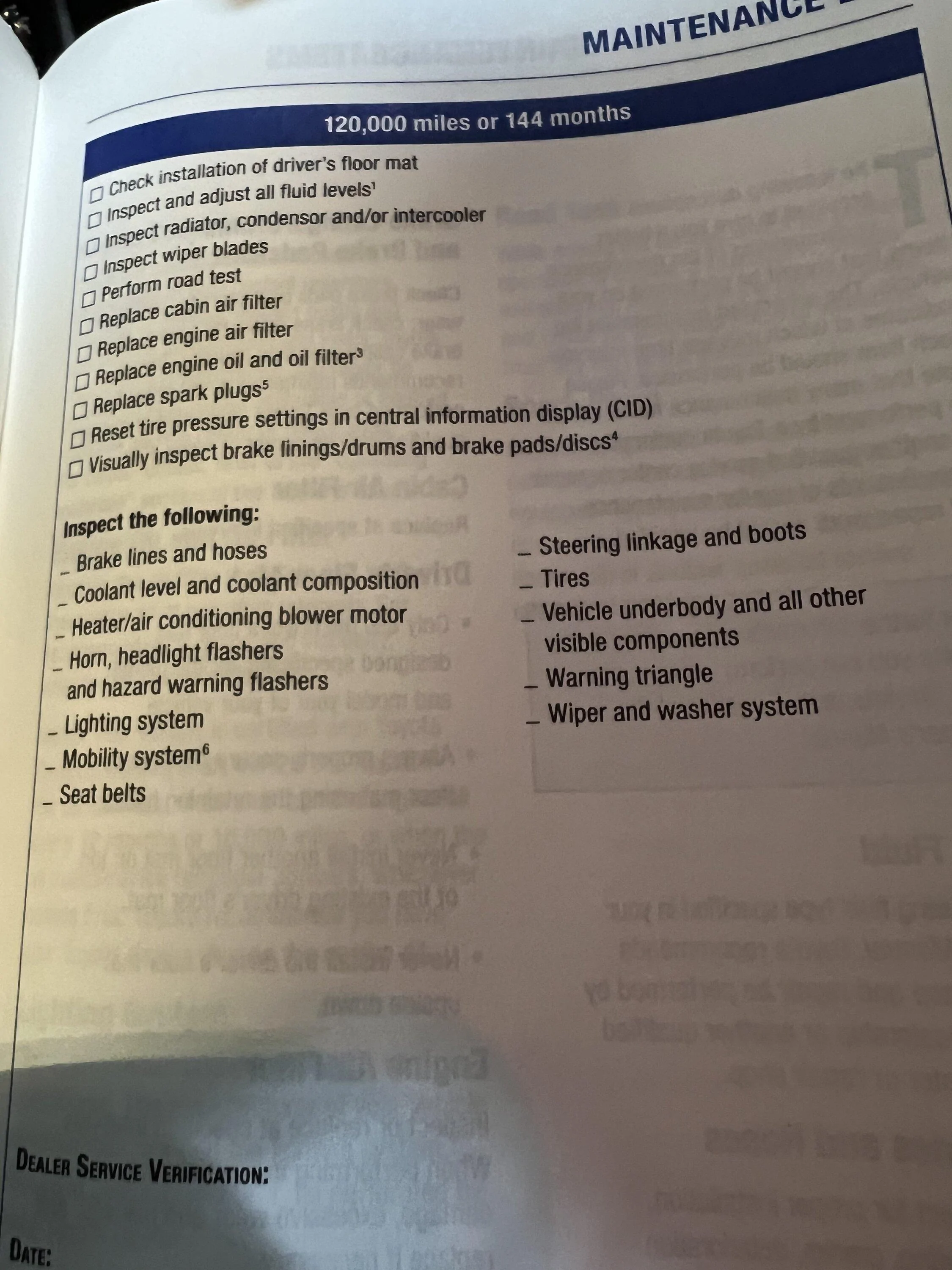

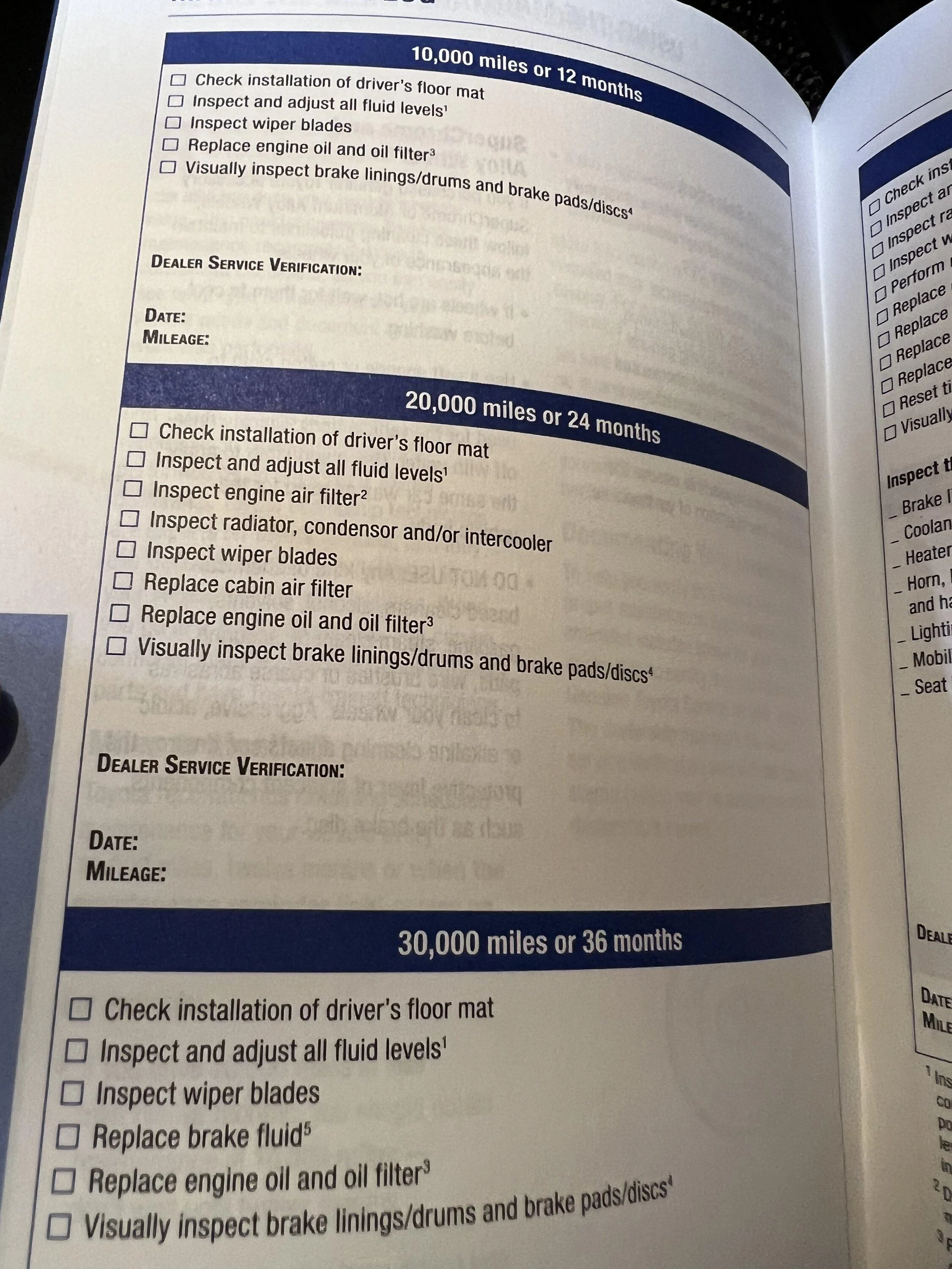

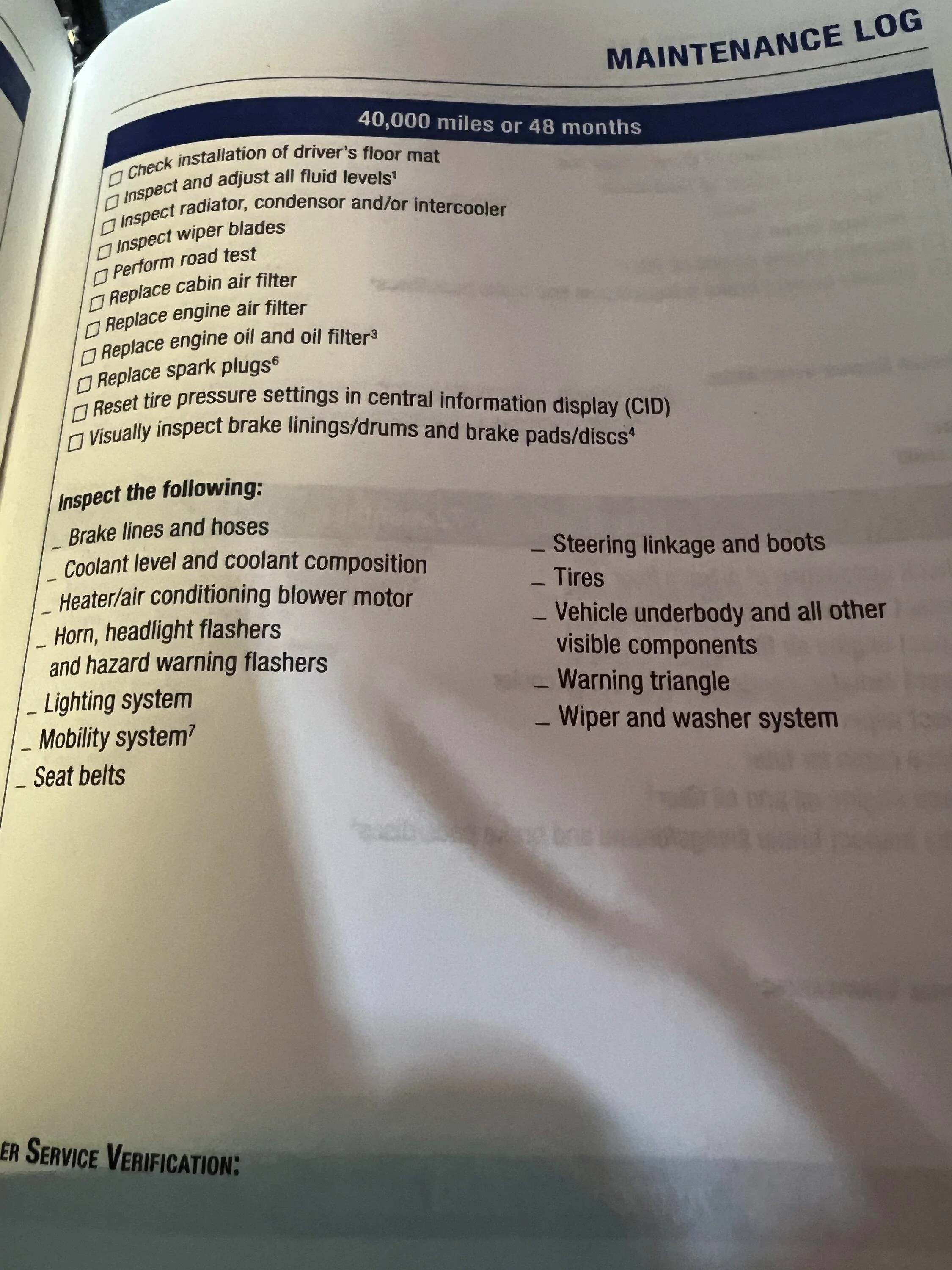

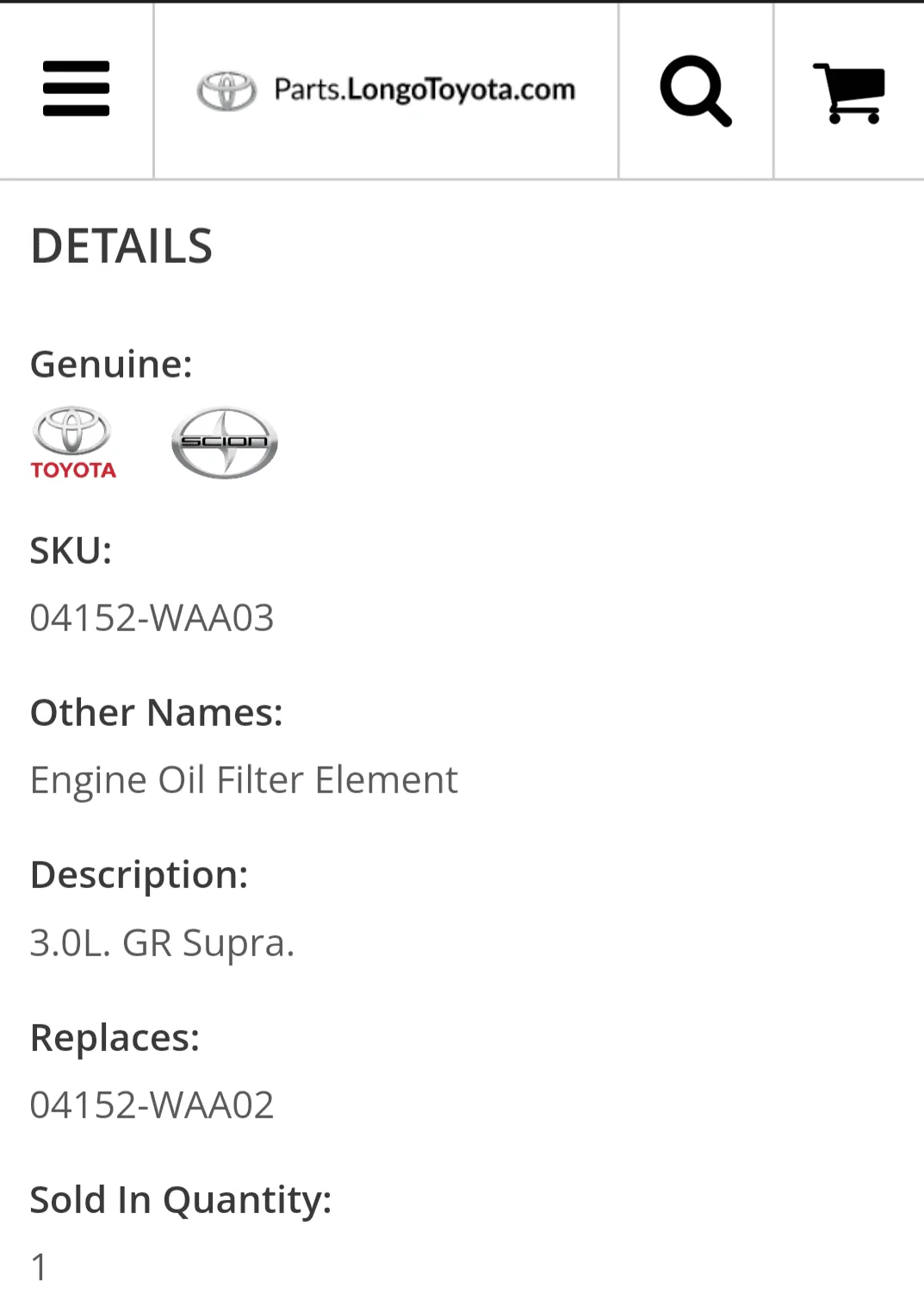

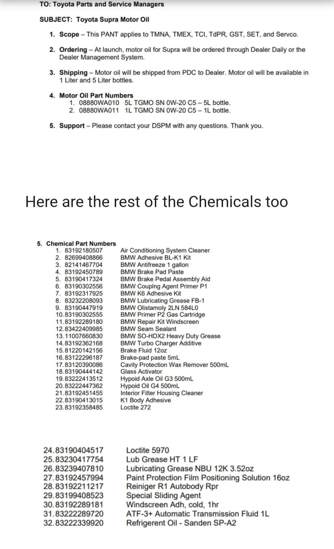

Iā€™ll put these on here for you or anyone that may pick their car up used and not have the maintenance schedule for their Supra.
In addition BMW dealerships will typically service the Supra according to the Z4 service schedule:
