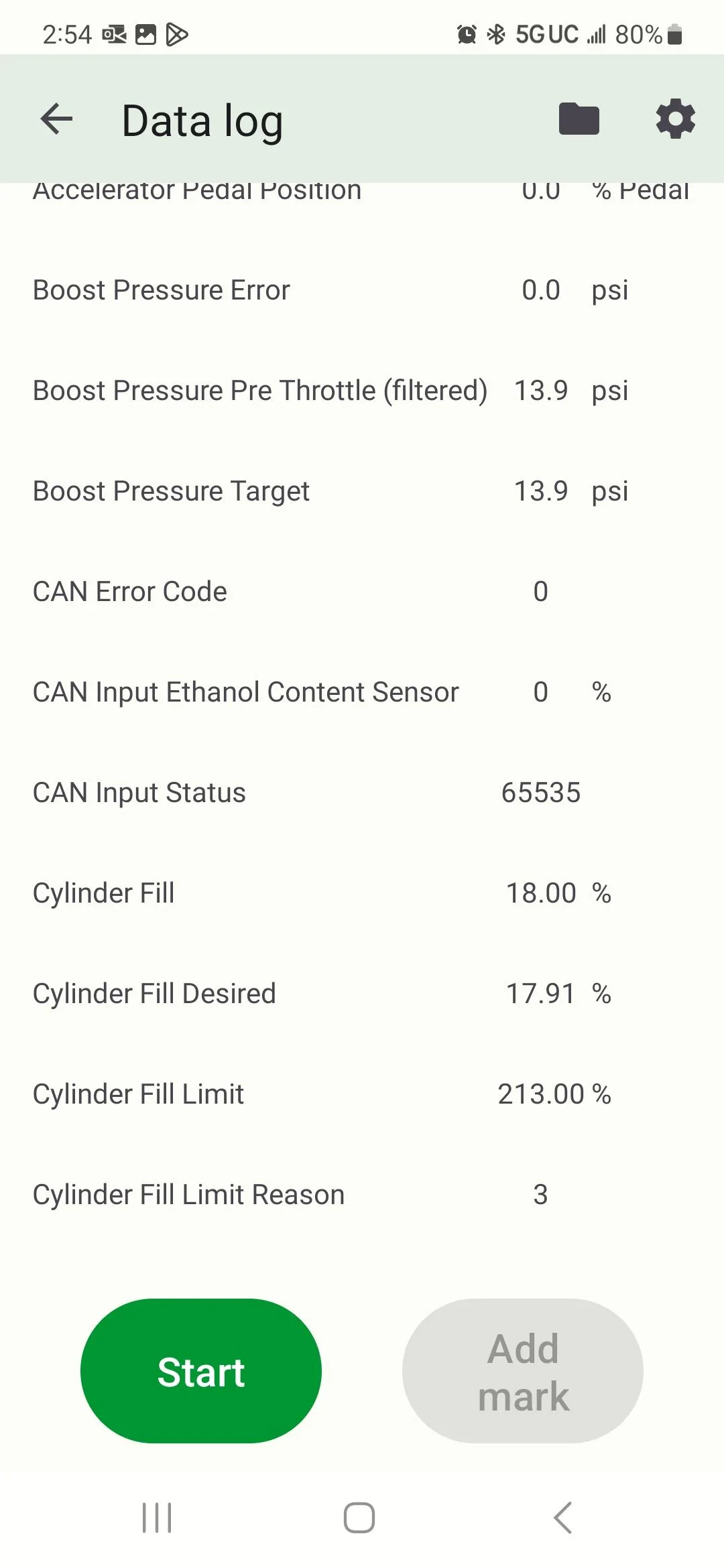

Anyone know if it's normal for 65535 to show on the can input status if you haven't flashed to a flex fuel map yet? Currently on a 93 OTS and wanted verify everything is working as it should.

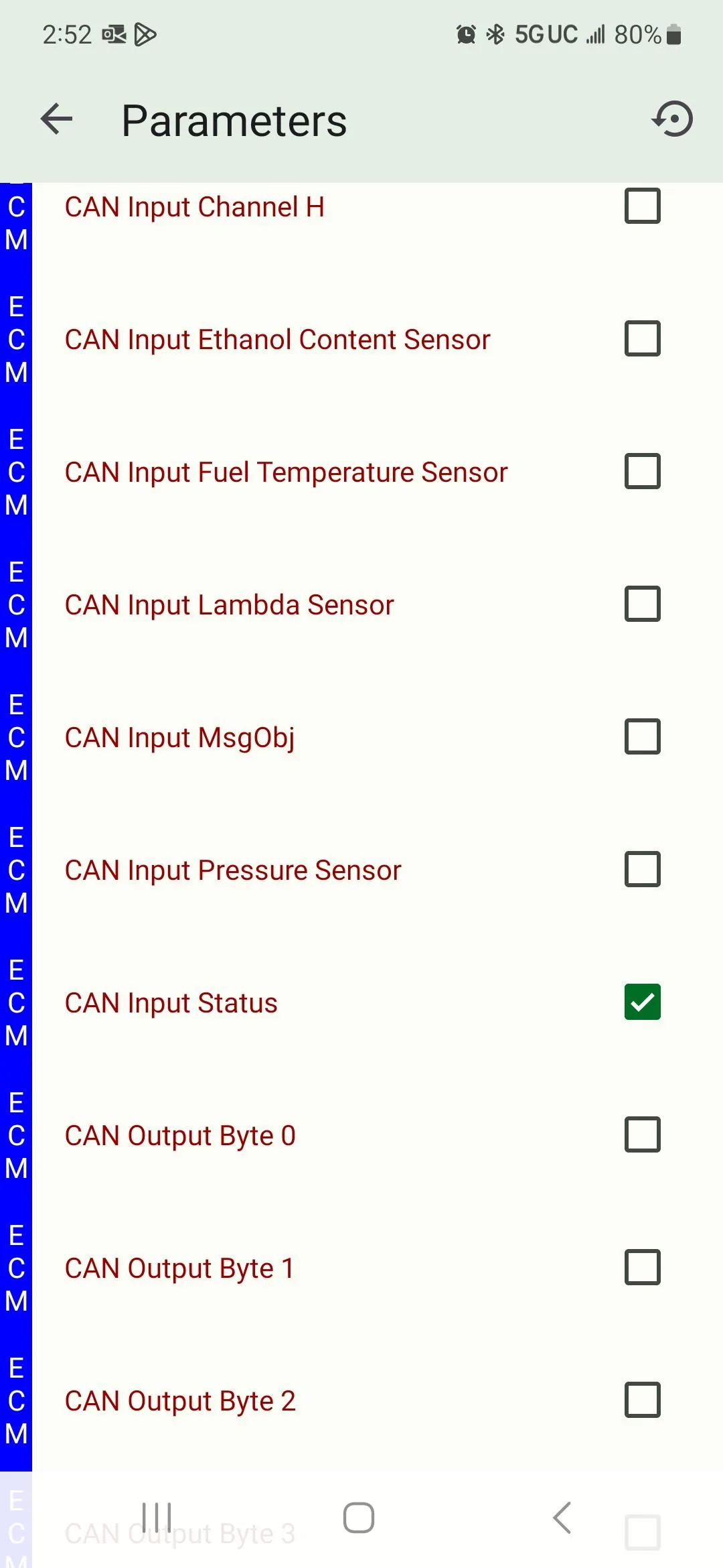

you may ask your tuner to be sure, but I think maybe they have to enable it in the ecu

Nope. somethings wrong.

Check your signal wires and that you have power to the zeitronix box
Yeah , I was thinking the same thing as the parameter is red under the datalogging settings and thought maybe it could be that it's not enabled. I'll need double check the connections if that's not the case. Thanks Zrk and Blake.

Just a quick update for anyone else in the future. There were no issues with my wiring/install. The OTS Map I have did not have the setting on to detect the ECA. After getting a new flash from my tuner and programming the ECU, the CAN Input Status now reads 0.
