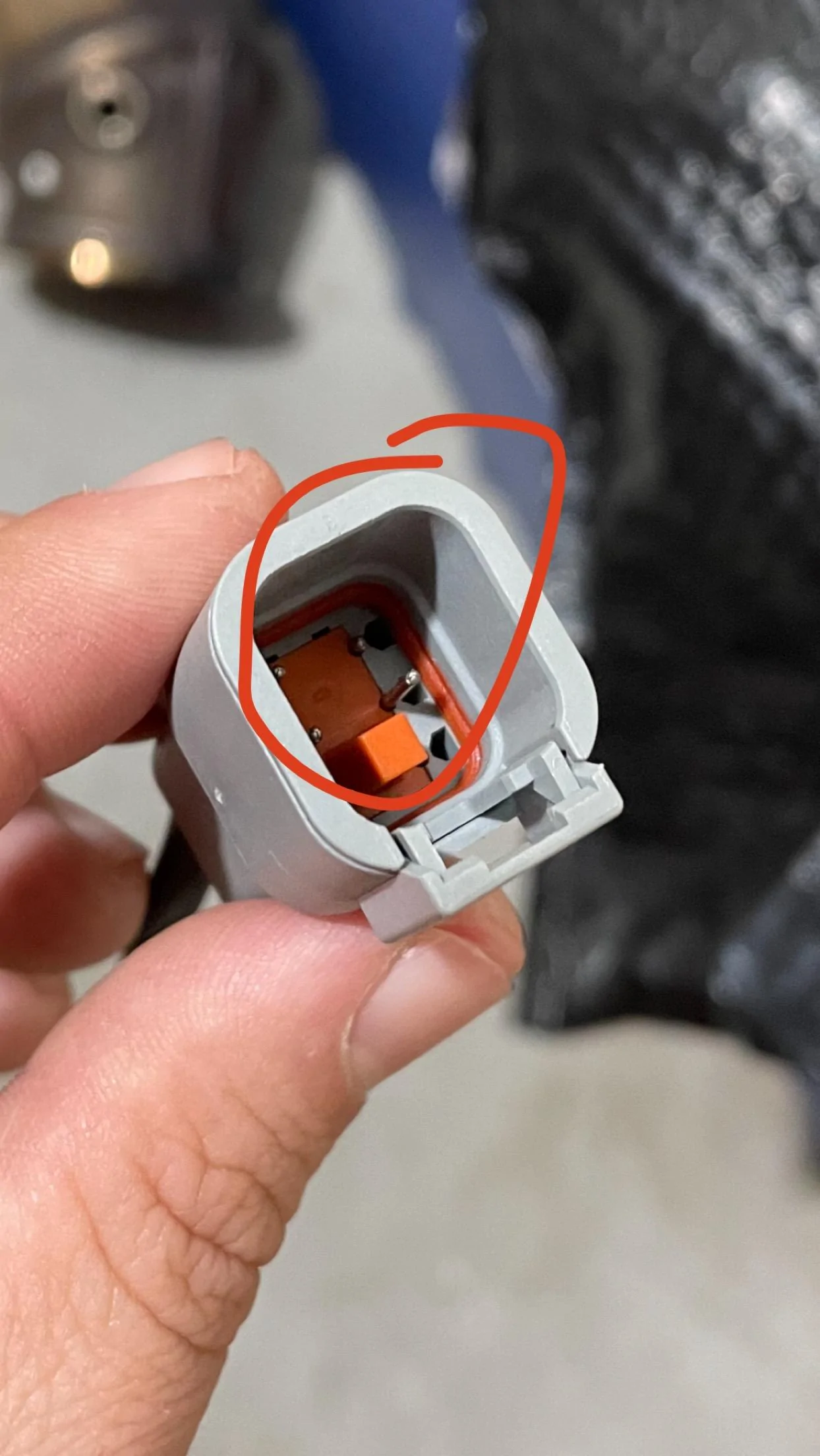

May have found the issue this pin is pushed back and it’s the yellow and black wire.
Could someone else also look at theirs and see if it looks similar to his?

Ya that for sure is the issue. Pop the orange piece out, push the pin back up, put orange thing back in and call it a day.
