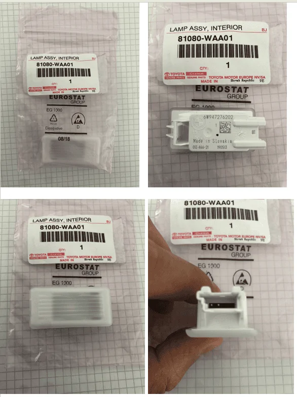

J29DB03
Dec 14, 2021
1,710
3,232
2021 Absolute Zero 3.0 Premium

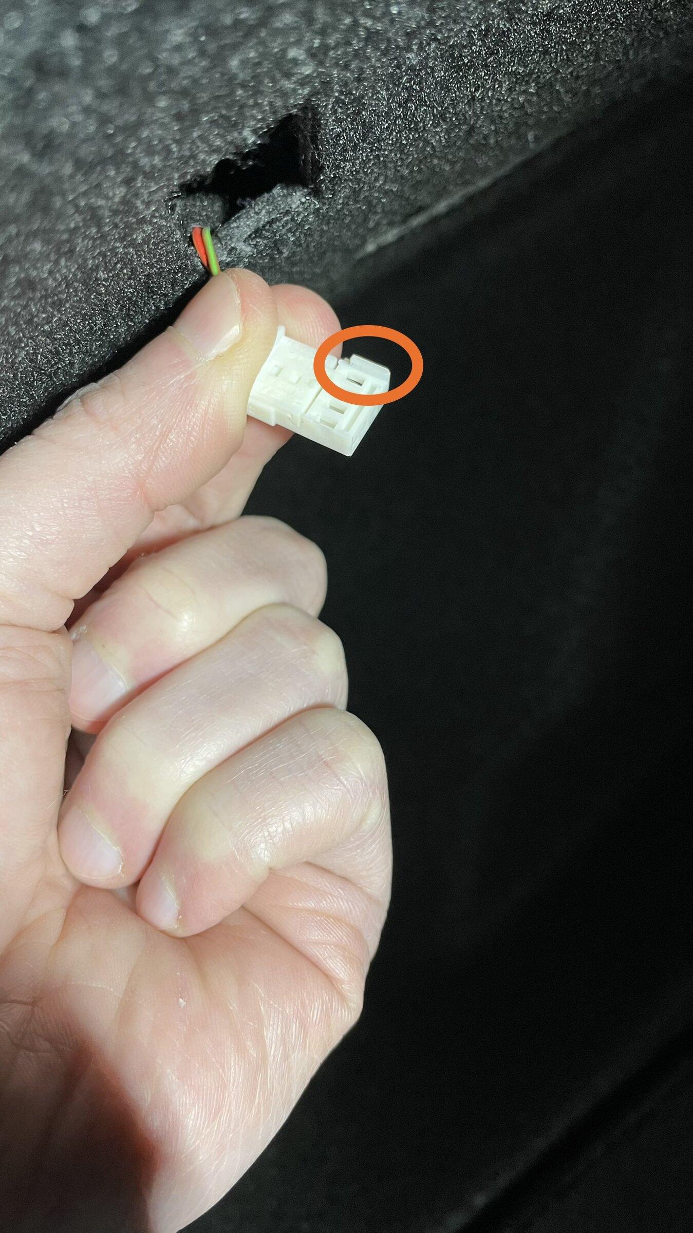

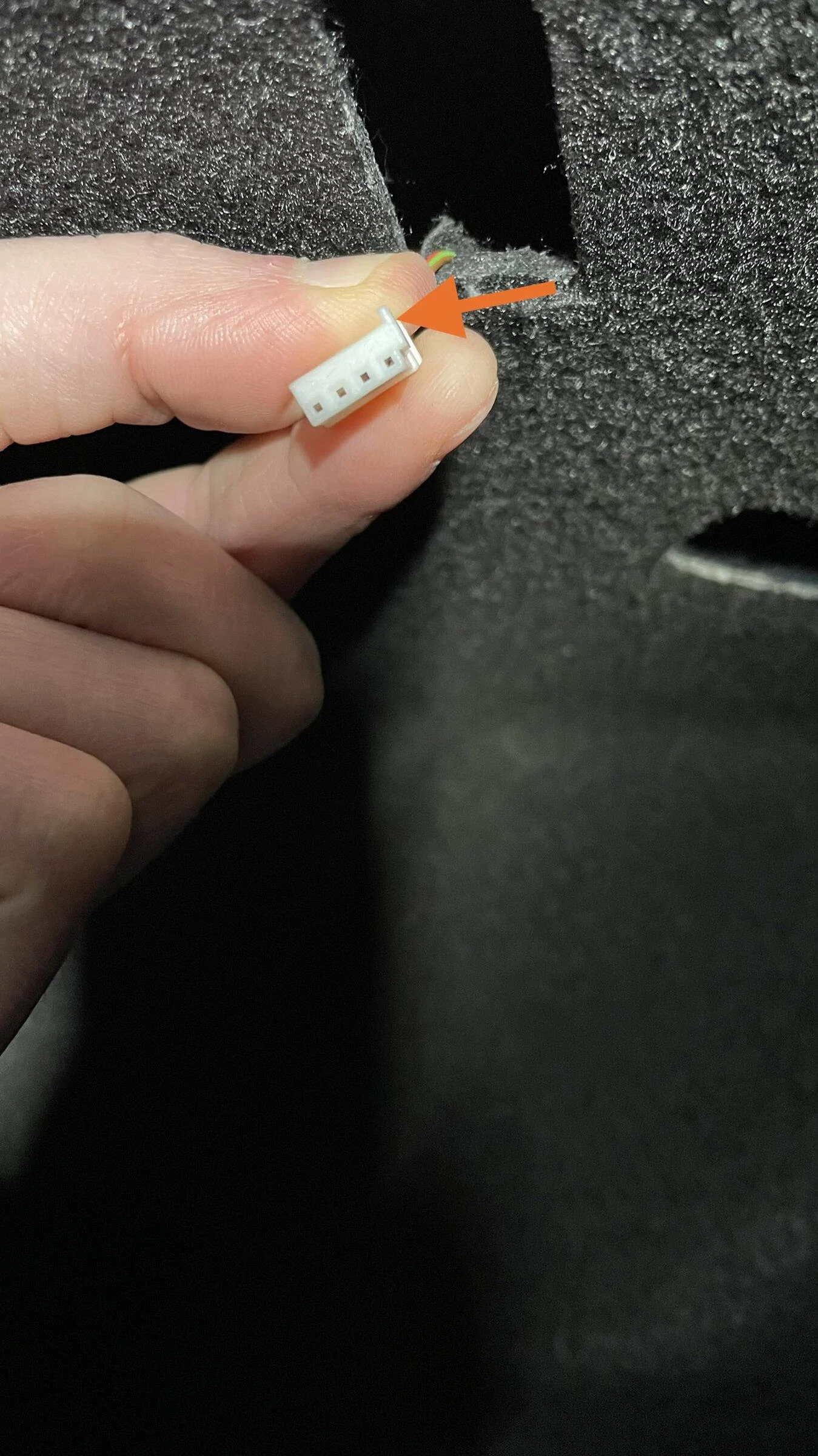

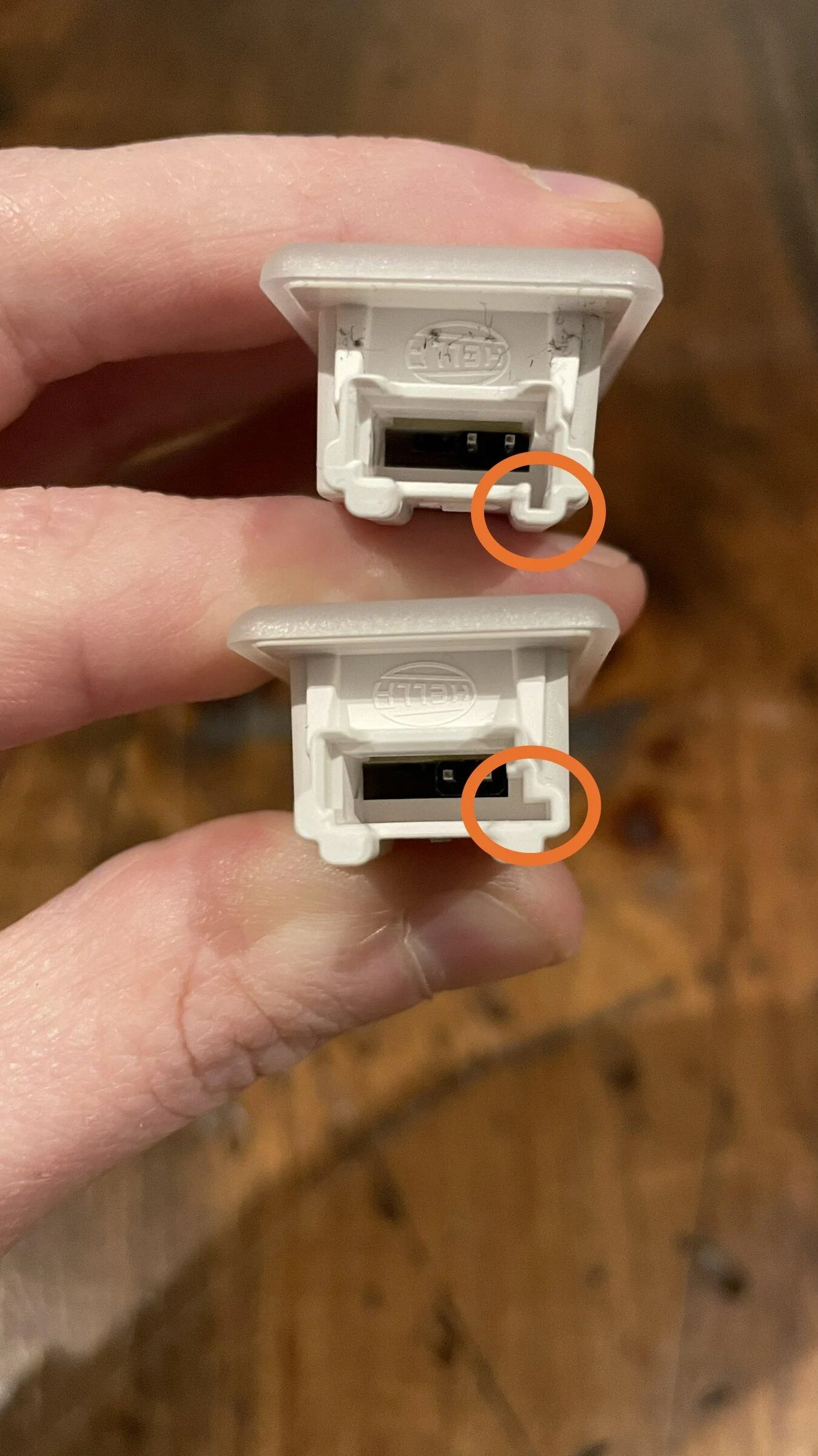

So my idea of the plug for the trunk lights being the same was almost right. The slight difference preventing it from going into the footwell light is the piece on the side of the plug. Tried my best to highlight what I’m talking about. I believe I’m going to look for a Supra at a junkyard, snip off the trunk lights, and remove that piece because otherwise they appear to fit perfectly. The small tab for keeping it connected looks to be in the right spot. Another project for the spring time. In the picture the trunk light is on top, footwell light is on the bottom. You can see the slot that piece slides into. It’s sideways on the footwell light.
