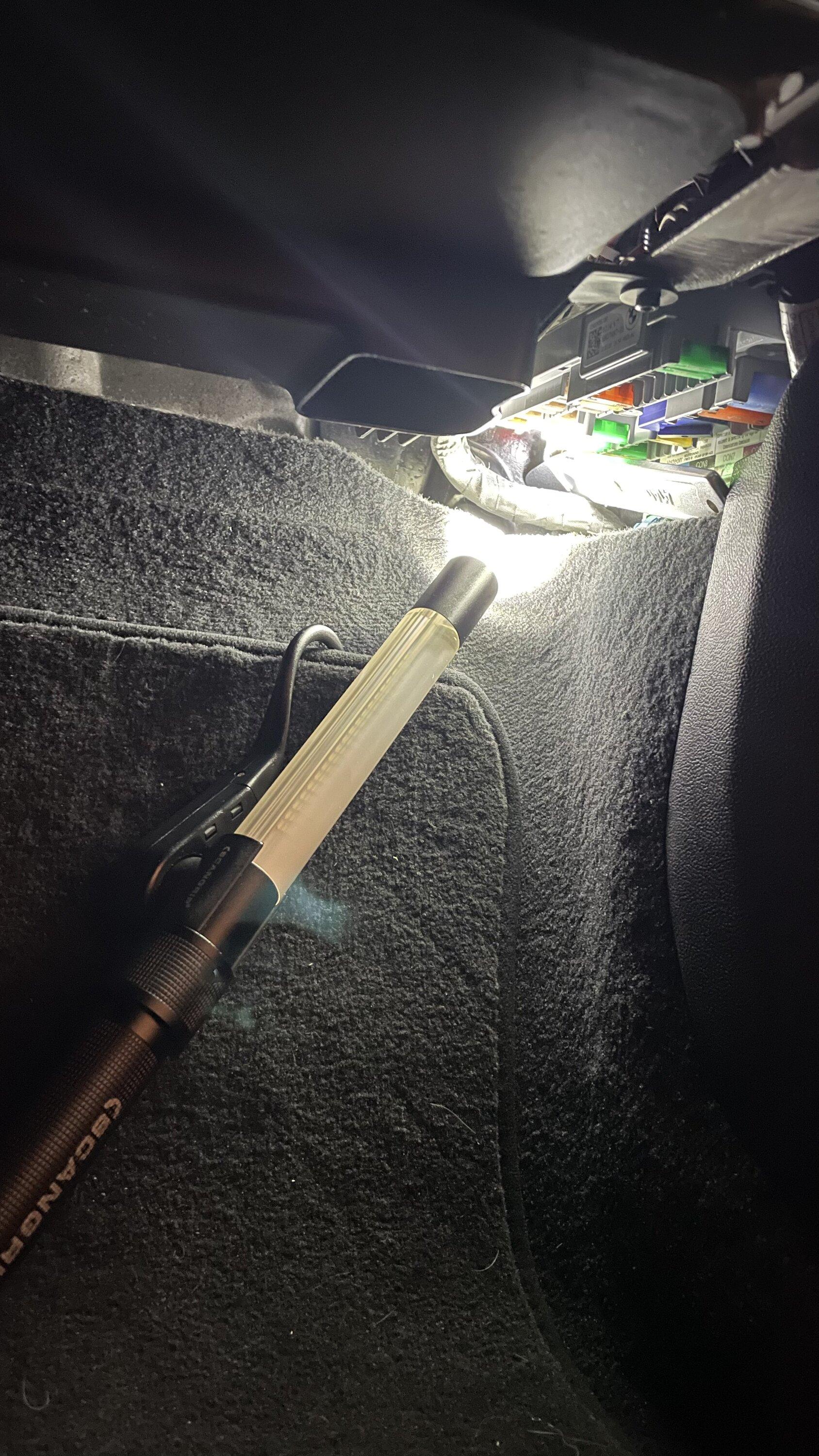

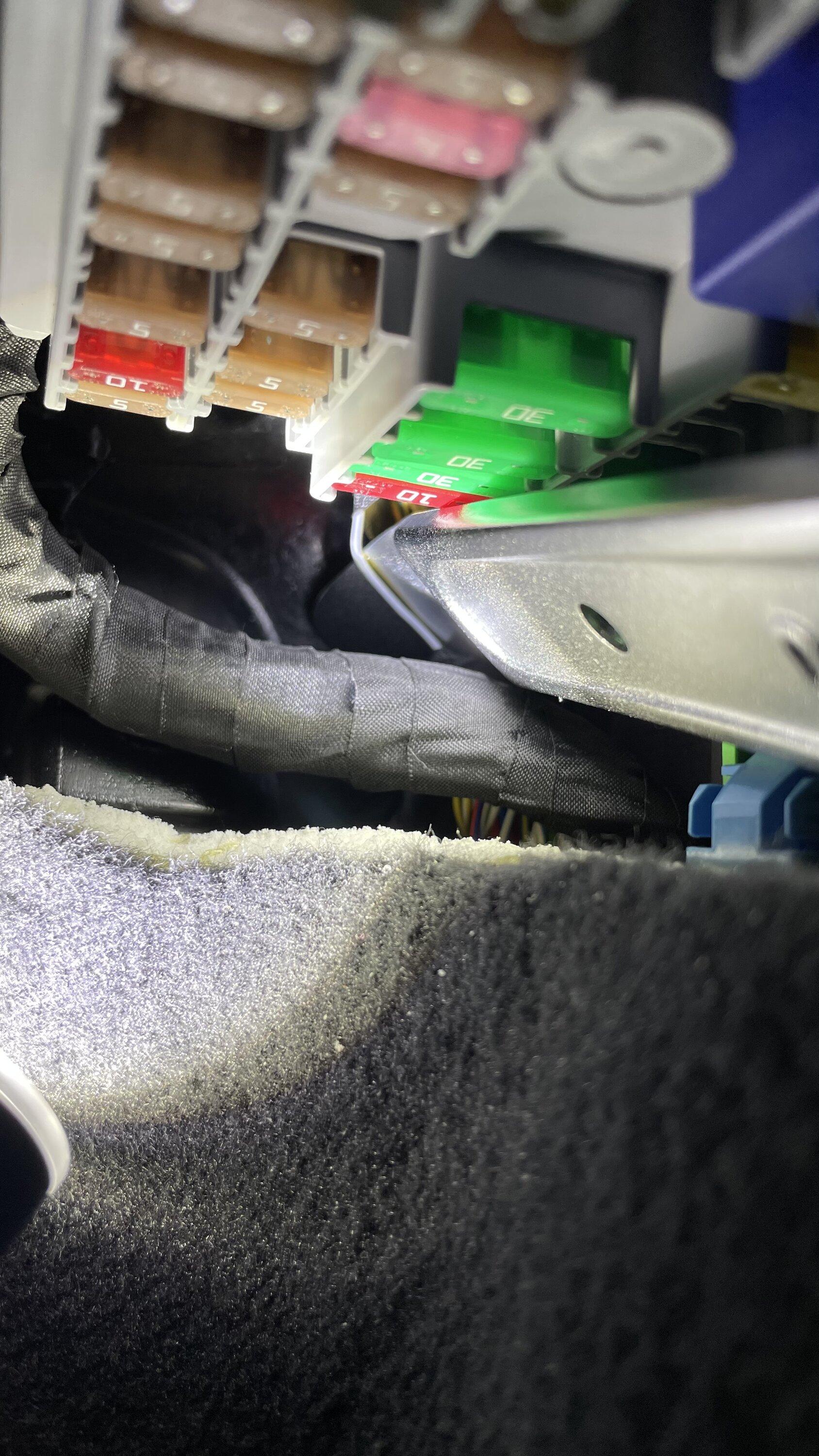

Probably can use the trunk connectors if you modify them. My pictures above show the difference. I had a poke around in the passenger footwell just now and found the grey w/ yellow striped wire that was mentioned in a previous door puddle lamp DIY thread. Got to assume it is the same as the wire in the door. I want to get a tester to make sure it performs the exact same way as the door lights. If so that’s the wire I’m going to tap on each side of the car.

Use the provided fuse tap and plug your control box into fuse F62. Move the existing fuse to the tap. It's in the footwell next to the BCM. You can check a fuse panel diagram to find it.

That’s the wire we have been looking for, grey w/ yellow stripe. Big thanks to @JRedMKV for finding it during his puddle lamp install. The footwell lights work the same as the door handle lights.
