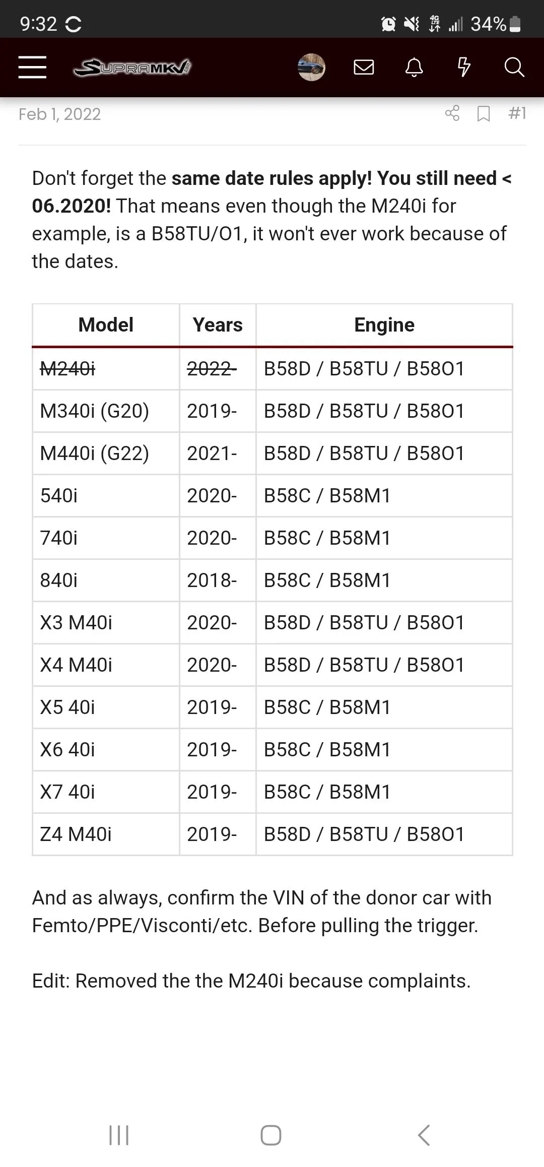

So this is the list can of vehicle that can be use right? On the date can it be prior years?
