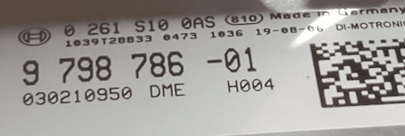

So for 'compatible' ECUs for cloning, is there anything on the ECU label (other than the date code) that would indicate the correct model of ECU from an unknown BMW? (I know this is a Supra ECU pic from an earlier forum post). Is the 1039T28833 what we are looking for or something else?
No, the 0261s100as number would be the one to match. Using any of the other numbers could result in getting an incompatible ECU.
Just so everyone's aware Femto can check the VIN to see if it's compatible, but they don't have comprehensive list of 0261 ECUs that will work.

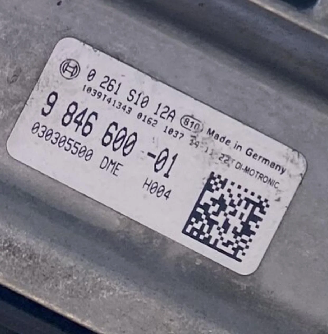

this is inaccurate
How so? Search for the 0261xx numbers and you'll see they match other compatible ECUs. The 1039t28833 will not get you the same results.
I should also add that you obviously need the correct date as well.
I know that 0261s100as and 0261s1012a ECUs work if the date is correct.

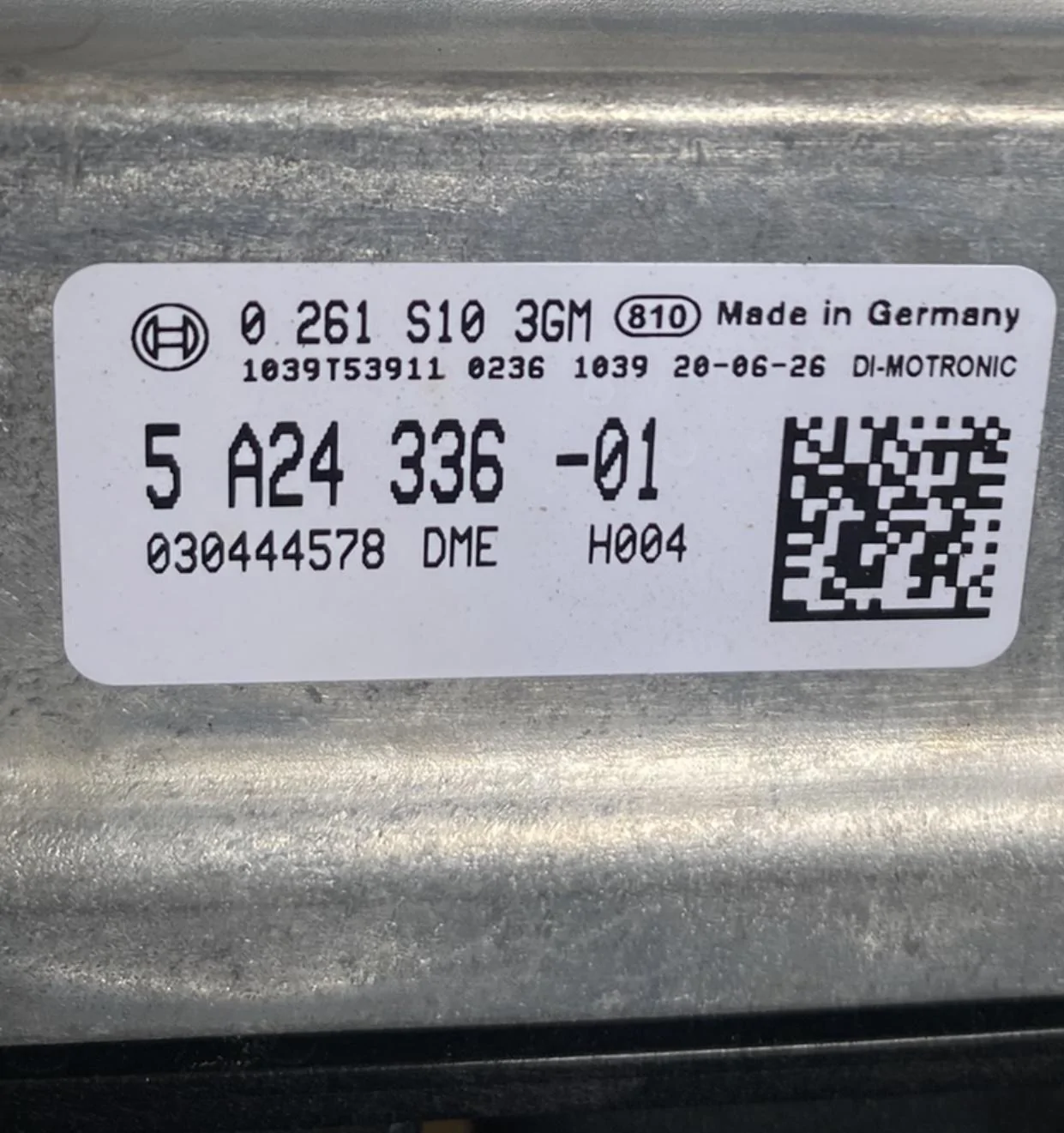

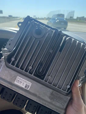

@zrk need you expert help with compatibility.
A buddy of mine had this extra ECU (unsure what vehicle it came off of) and donated it to me. Are you able to determine compatibility by the ECU label?
1st picture is the donation ECU.
8,472
14,122
Can't tell by the label unfortunately, but that date is too late anyway.
