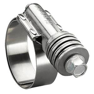

Oetiker
100%, don't use hose clamps.
Thank you, now that means I gotta buy that dam tool lol

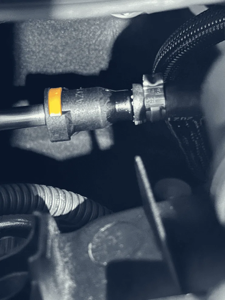

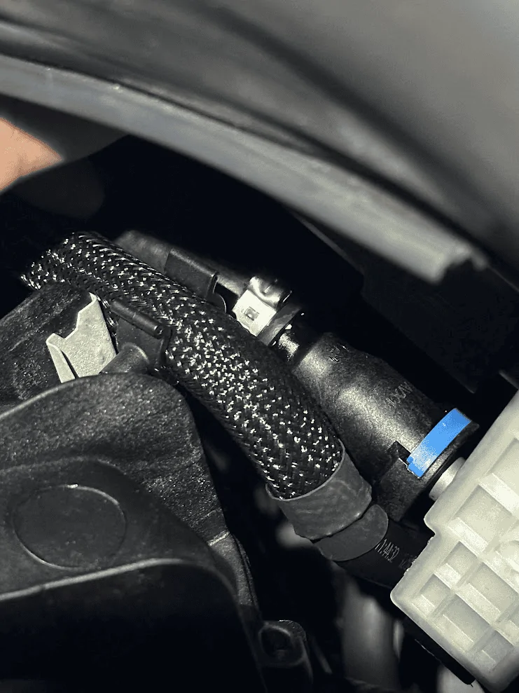

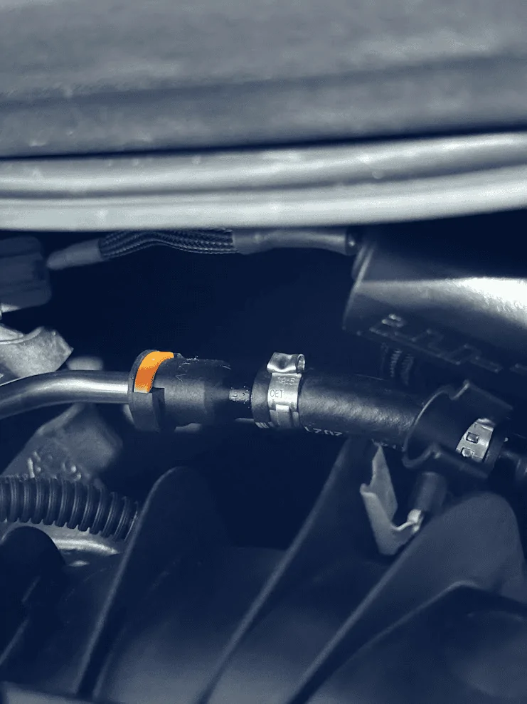

It wasn't leaking from the fittings. This is the original hose and clamp.
Right, the fittings I linked get rid of that shit fuel hose AND fittings and uses your OEM fuel lines that don't suck ass. The fittings nor the hose in your photos are OEM.
Win, win.
Ah took me a min lol! I think this is the best solution! is it the 5/16" i'll need?!
