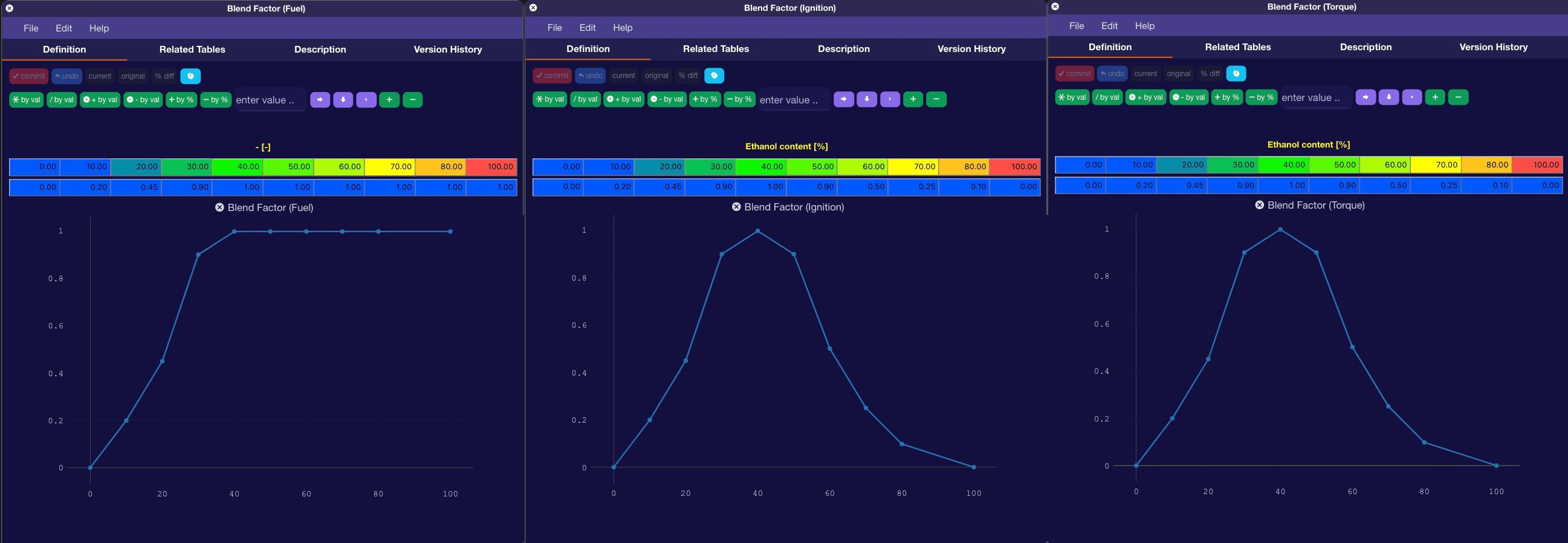

Great question. I was curious myself what would happen if you get your mixture wrong and ran higher level of e.
You can setup the interpolation tables to bring everything down with higher levels of E if the fuel system can't support it at higher power.
Something like this, and setting the base tables as more of the neutered map. This is an exaggerated example of course.
