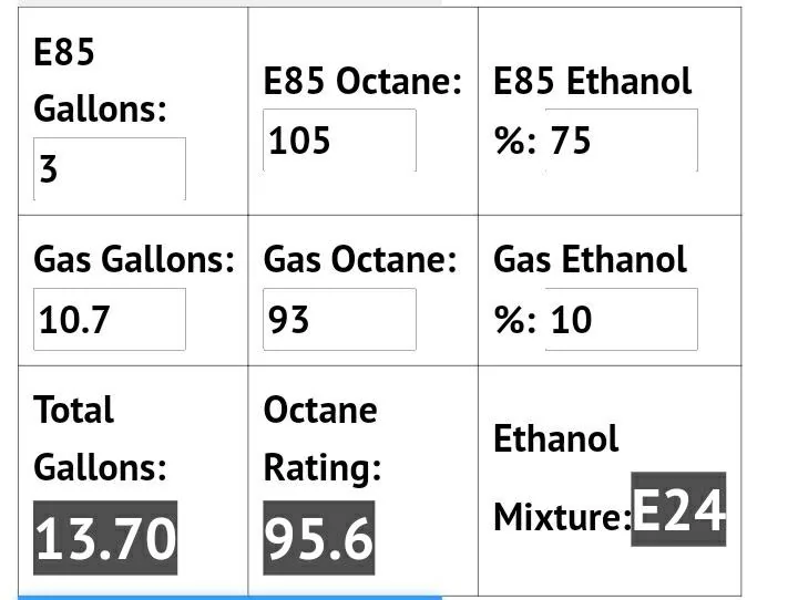

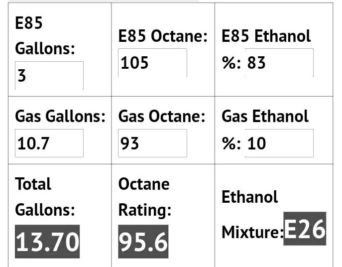

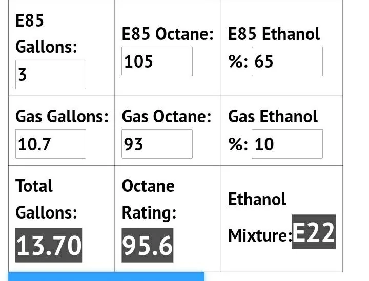

3 gallons of E85 to 10.7 (13.7 gallon tank)of 93 is safe by BMW's standards(e25 maximum ).The maximum E85 at pump is generally e83 or less. This has nothing to do with the OP's post but I'm just clarifying that this isn't a bad mixture.

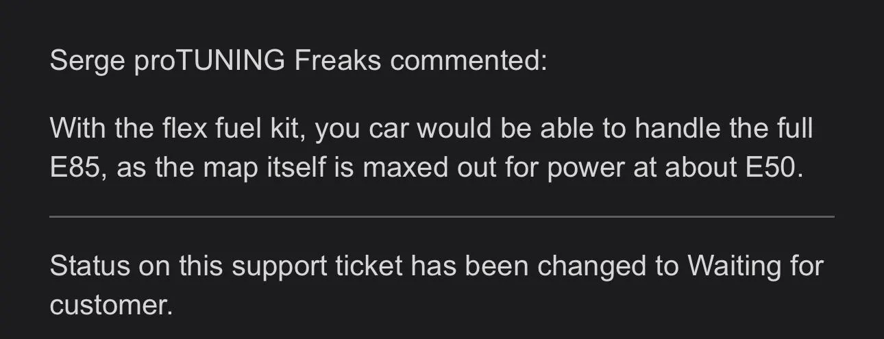

So how accurate is this? Told bm3 I was on multimap and was wondering if I could do full e85 due to it being cheaper and just easier than having to pump 2 different times. without PI or lpfp upgrade and this was their response. Im not a numbers guy for power.
so again, the stock fuel system can support any amount of ethanol you want. the tune is what makes it safe. if it is optimized for a specific blend, usually e30-e50, then power should drop off towards e85 as boost pressure drops to keep things safe. The only way to know is run a log and confirm it works for your, your conditions, your fuel, etc. it's an OTS map designed to work for most.
