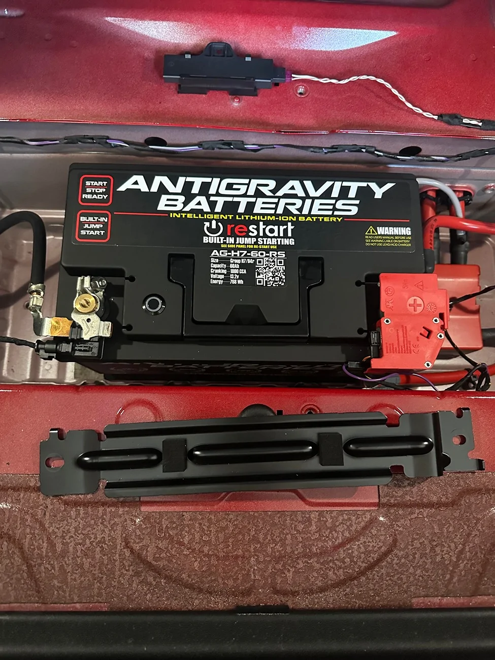

Getting DTC 030E07 after coding/registering new lithium battery
SoSparkly
Crisa
Mar 20, 2026
2022 M440i
Nope, hasn't come back after I coded the battery type back to AGM (I left the size coded to 60ah with the new battery). Hopefully that works for you too.
Stop/Start still isn't activating, which isn't the biggest deal for me since before it only did when putting the car in park because of XHP tune. Antigravity told me typically getting the Ah rating as close as possible is recommended but I might see if putting it back at the oem size turns stop/start back on
Thanks! I changed it to AGM yesterday and the code hasn't come back yet. You might want to scan with ISTA, I had several other codes that MHD didnt show related to the battery issue and one showed a start stop disable. They haven't come back after I cleared them with ISTA yesterday.

Just an update - I tested reverting to the original coding for the battery (AGM, 105ah) and turning stop start back on in Xhp. After registering the battery again and a couple of drive cycles now stop/start is activating, and still no other codes related to the battery or charging system, voltage etc.
So at least for anyone getting Antigravity batteries I would recommend just registering the new battery as same type and don't bother coding anything. Not sure if other lithium ions would work the same way, but my car wasn't totally happy with the bimmercode changes.
