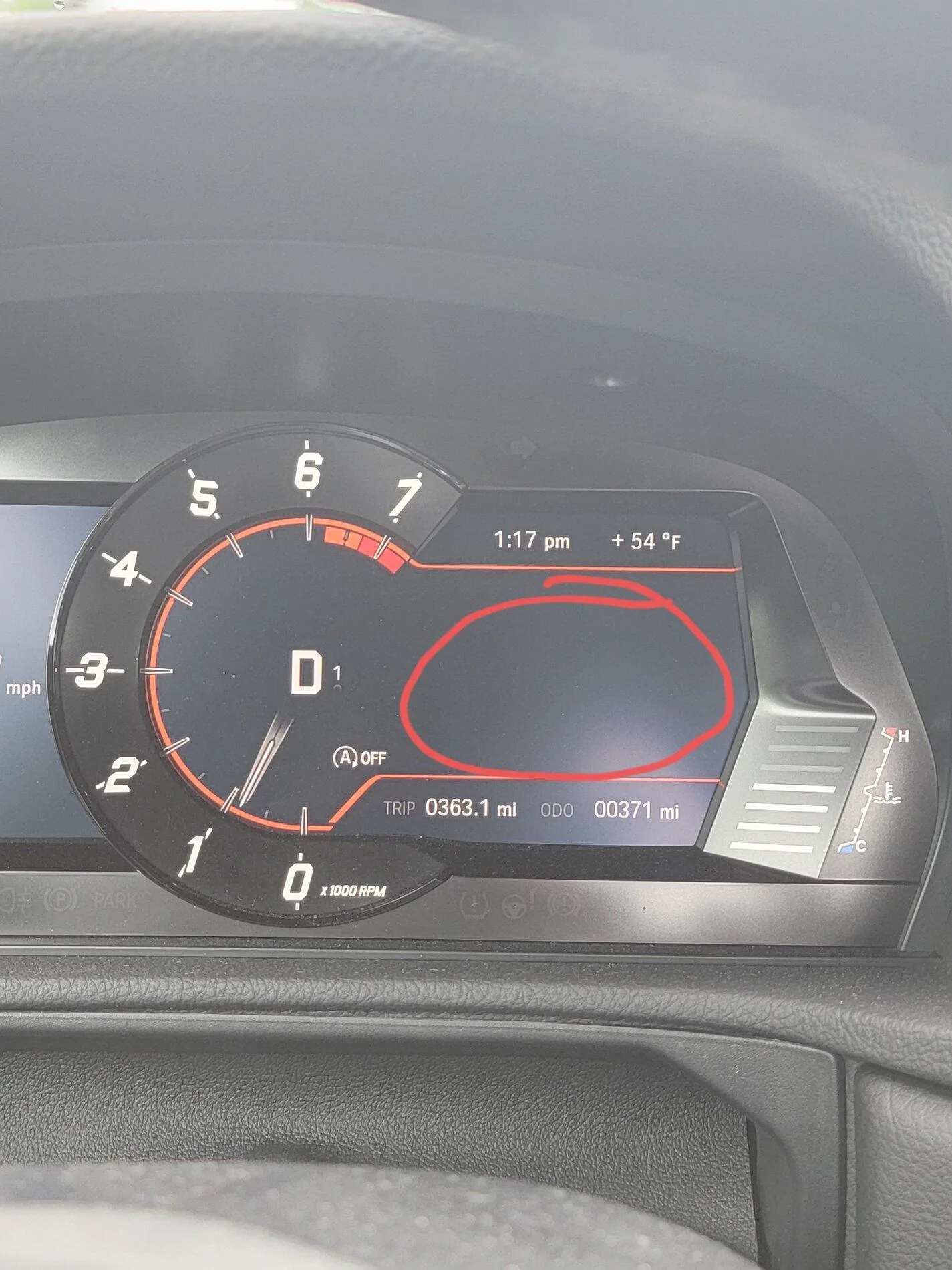

I was driving today in the rain and this guy cut me off and a picture popped up on my dash for a split sec or 2. It looks like the rear of a car with tire trails behind it? This is something to worry about?
It happened before when it was dry.
It happened in the red circle area
Thanks ks

I get that all the time. No worries, it is just a warning that you are too close to the car infront.
You could turn it off in safety settings if you find it triggering too much.

I thought it was part of the in-dash infotainment video game system used to keep drivers from staring at their phones.

It's unfortunate that the distance to keep the light from coming on is just enough for someone in traffic to decide they wanna cut you off.
