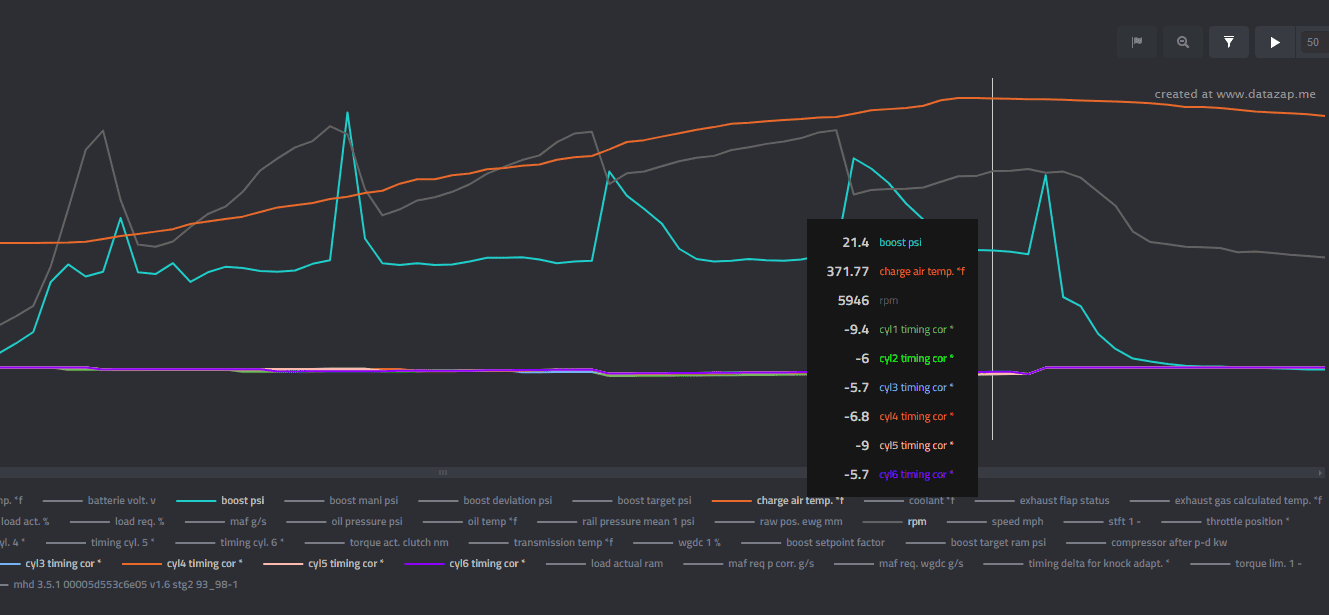

You're only running ~18psi? I'm sorta surprised actually. Timing looks good, you're not pulling. Fuel starved maybe?
Yeah, Fabian tapped the injector limits, he bumped it down a bit after. I told him i wanted a conservative tune with low torque, i wanna still have a 6th gear lol

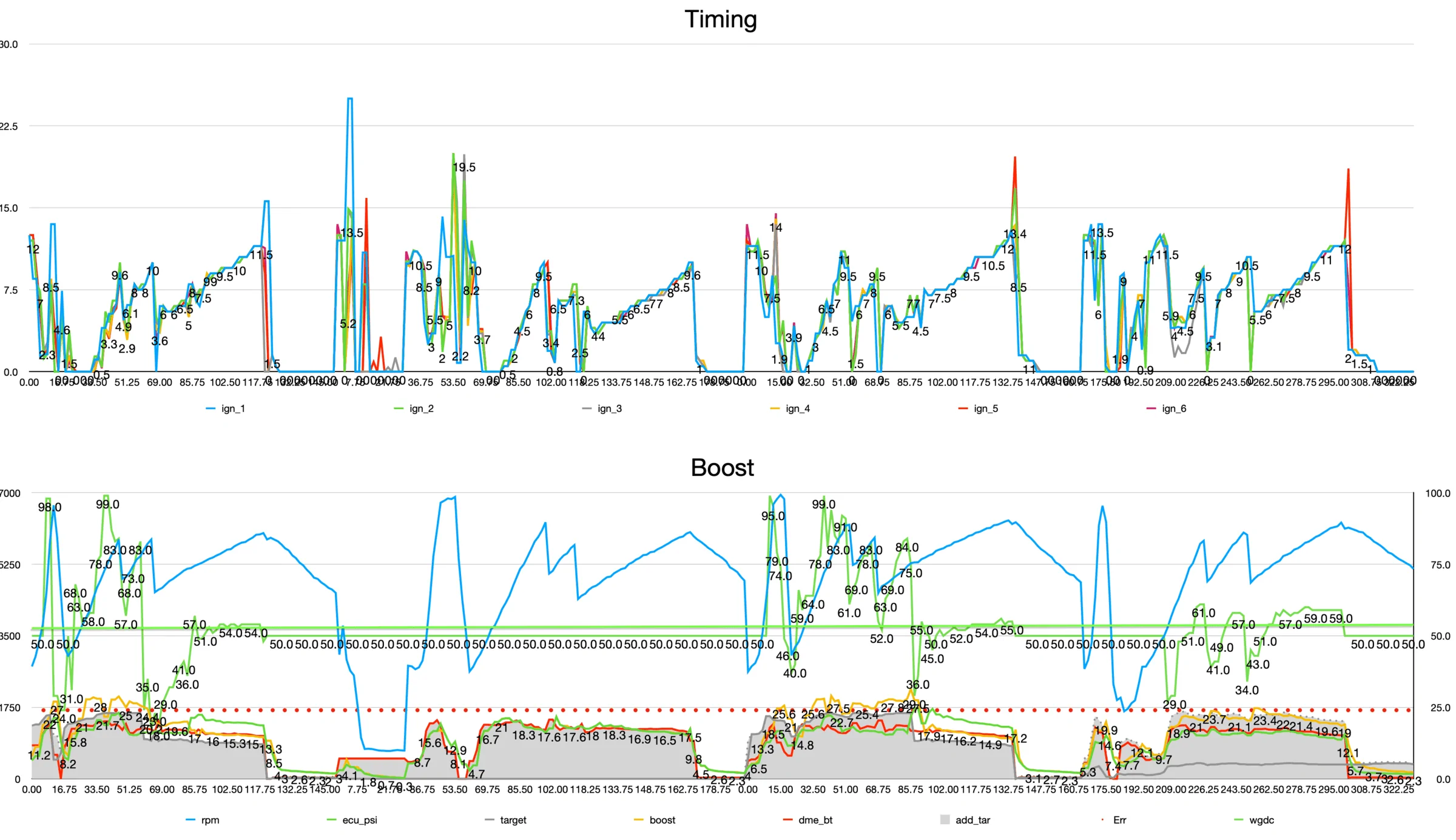

https://datazap.me/u/manny96961/first-log?log=0&data=24
i haven’t had time today to log a run but this is the best I had saved but I will do one when I get a chance
IATs are high, but not bonkers insane. It's head soaked. You have like no timing at all. like.. 4* across everything. Ice down that engine bay or get some meth. You're also running to redline, which isn't ideal. Too much boost. Something is definitely out of wack.

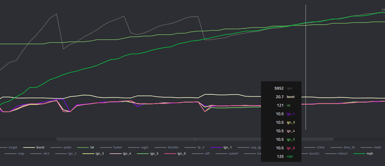

MAJOR timing corrections and your IATs cannot be correct (edit: had the wrong param selected belowl IAT actually look reasonable but not great)... I'll review in further detail later this evening if I get a chance. Avg 20psi -- way too much for pump gas.

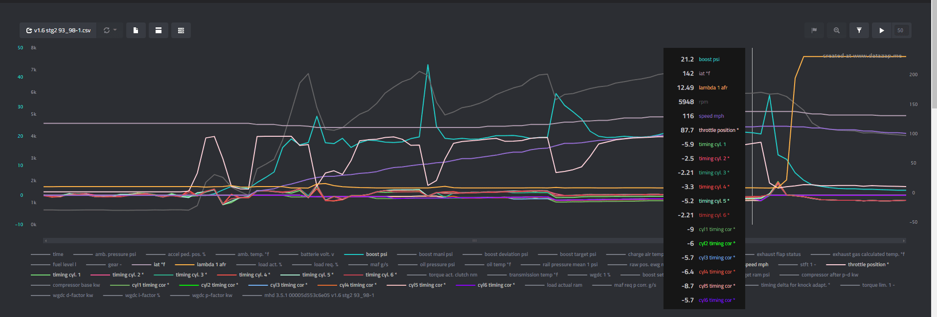

Had a few more min than I thought, more feedback:
IATs were already heatsoaked before the run at 122° -- is what it is if you're stuck idling in the staging lanes or shut the car down for a bit and restart. AFR looks good across the board. The timing tells the whole story, though. By the time you're in 2nd gear it's progressively pulling timing harder and harder in each gear to the point its full on negative in 5th gear. I would NOT be running the car like this; damage is eminent if not already. You need a lot less boost or a lot more octane.
