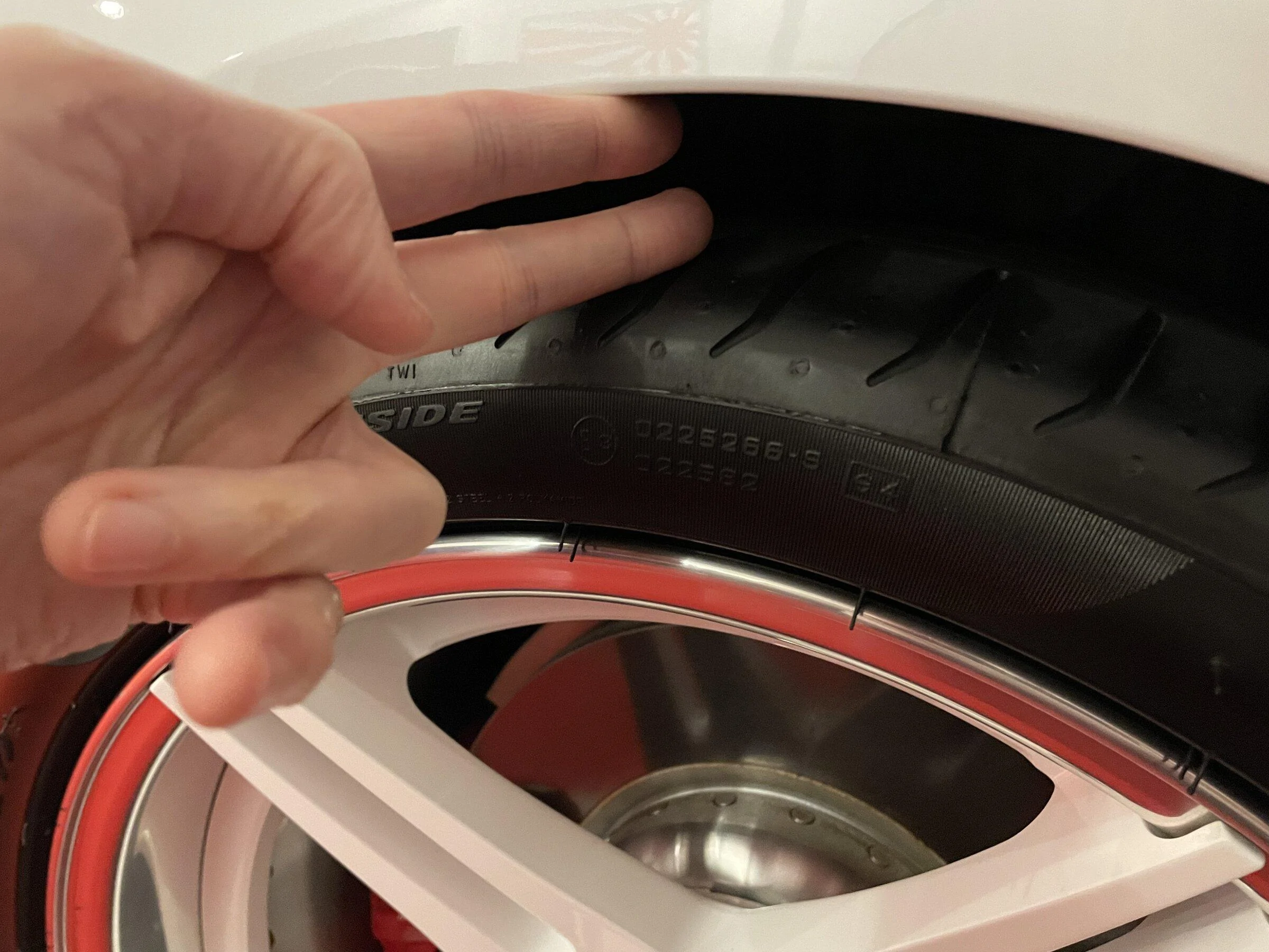

Question. Those lowered on H&R springs and 305/30/19 in the rear. What is your gap from top of tire to fender? I swear mine is not correct. I should not be able to fit 2 fingers in the gap. Others look way different. I have 265/35 in front and the drop is perfect. Thinking about adding more negative camber. I hate the Pirelli tire I have, the profile comes past the rim which in turn comes out barely beyond the rear fender and it makes me nuts. Maybe more negative camber will bring in it in a bit. Thanks for any help everyone.

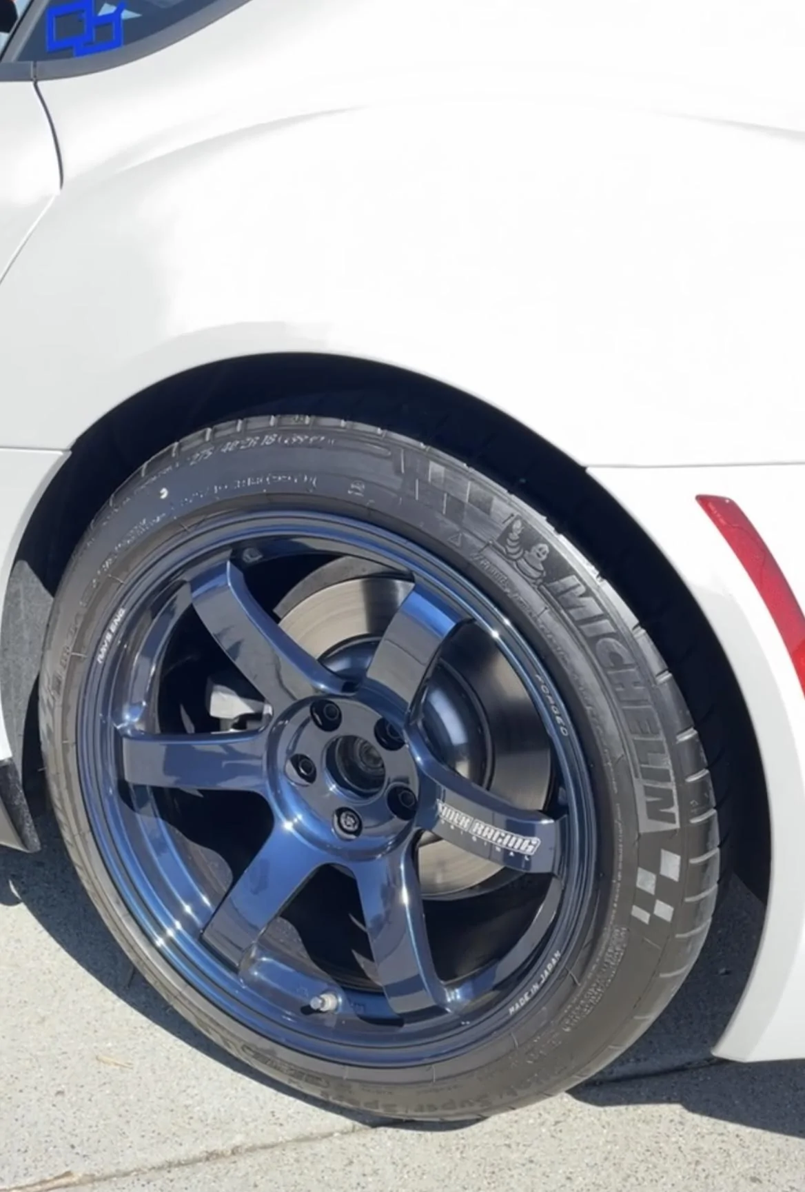

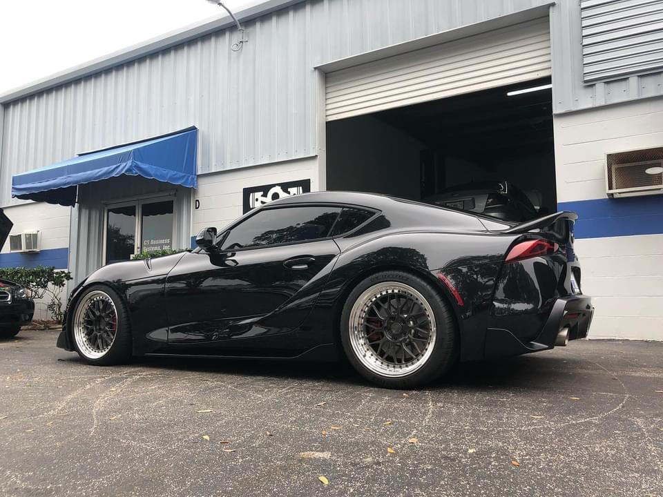

My fronts are near-perfect for what it is. I attached a picture of my wheel gap in the rear (18x11 +34 wrapped in 275/40/18 PSS) as a reference.
