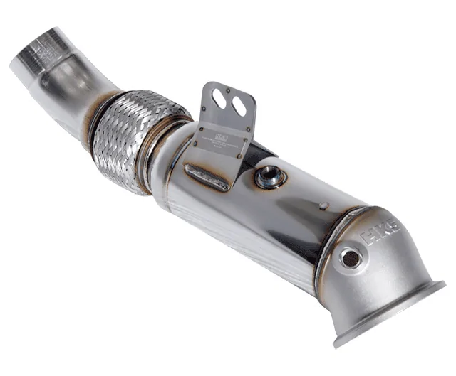

Official page for the HKS Metal Catalyzer is up:
https://www.hks-power.co.jp/en/product_db/exhaust/db/31541

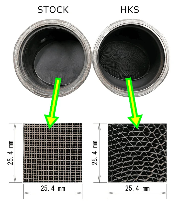

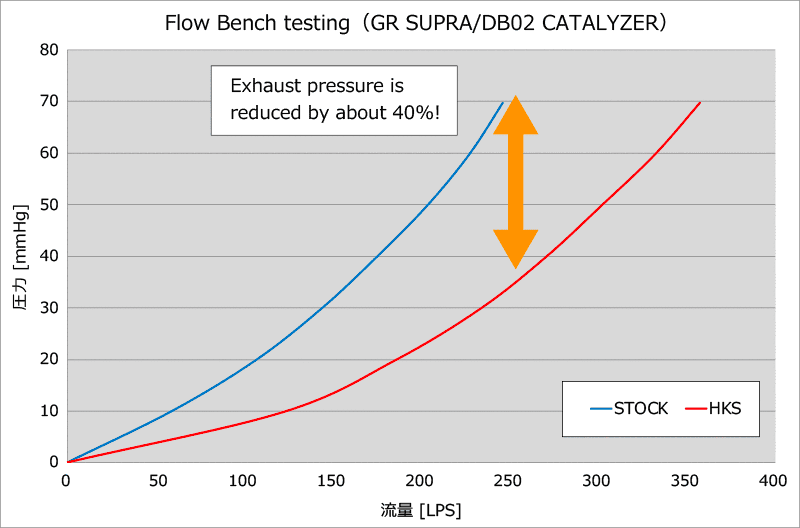

  • The HKS catalyzer has 150 cells compared to the stock catalyzer‘s 600 cells, resulting in a 40% lower exhaust pressure.

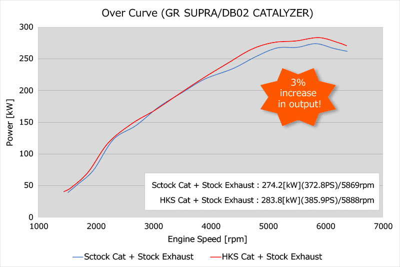

  • Gain an approx. 13PS advantage by just replacing catalyzer. (In-house test)
