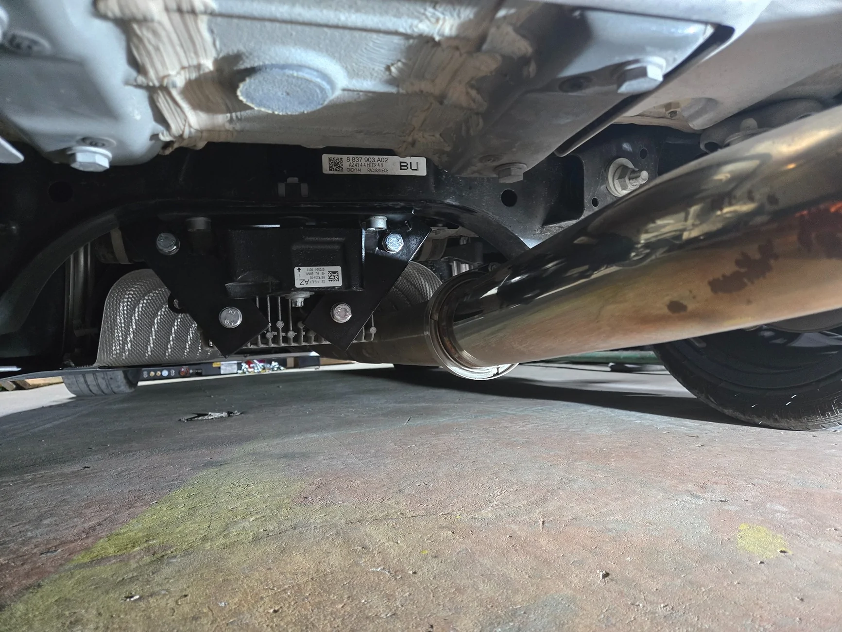

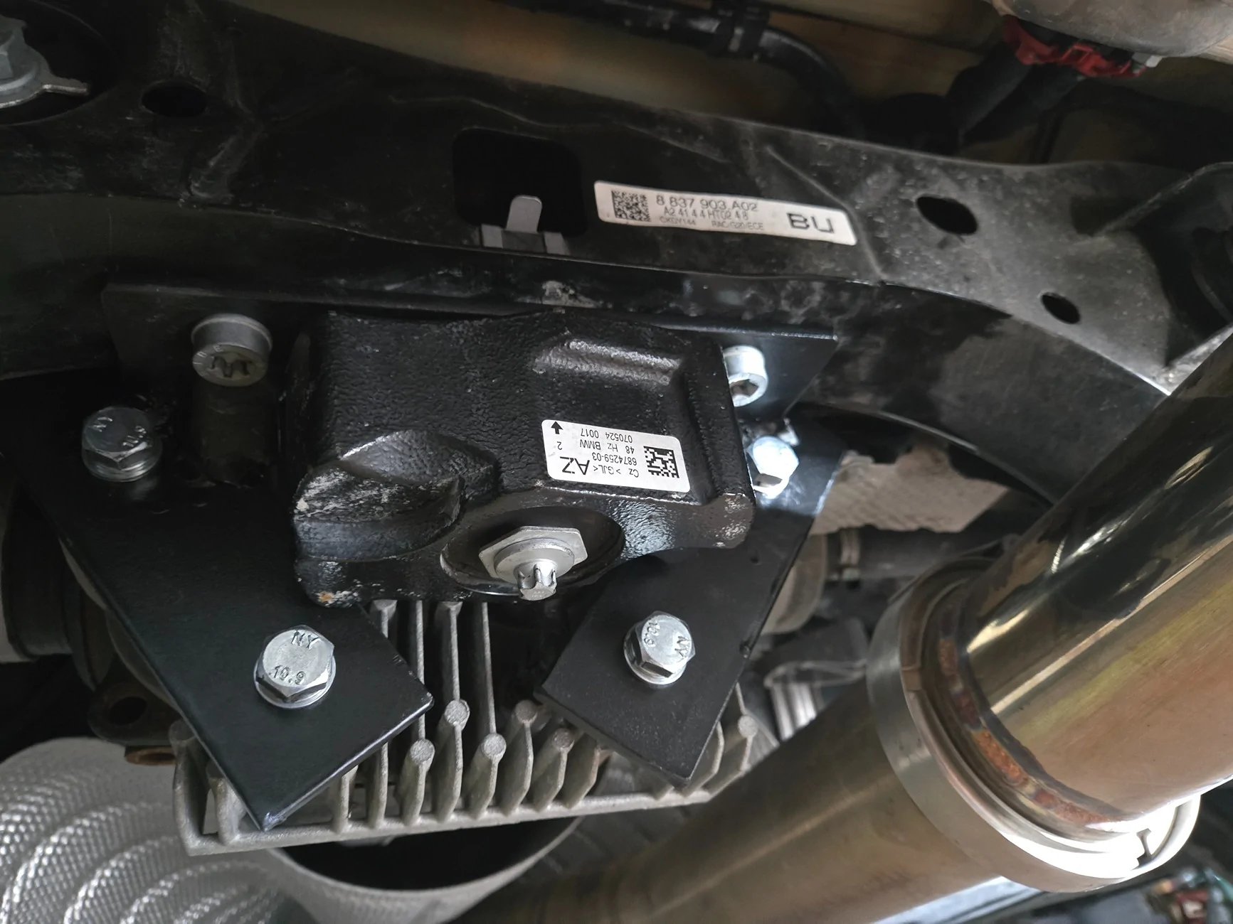

I had a few hours to kill between service calls on New Year's Day... And the Supra has been sitting, so I decided to tackle the task of bracing the differential. $18.XX from Lowe's, a can of black spray paint I already had and some scrap 2" 1/4" flat stock. Everything is welded solid including the spacers. There is a flat washer that is between the spacer and the aluminum and grade 10.9 coated bolts. I left the tabs down lower because I'm going to attach to them later and make a differential cooling scoop. I'll probably tie the bracket ends together for more strength. I will eventually do brackets, similar Twisted Tuning's, for the front. I also wanted to leave the NVH device in play. I'm very pleased with the outcome. It was extremely cold in my garage and the paint ran but I will eventually be welding more onto the bracket, so I didn't really care what it looks like. I have a bunch more stuff to get powder coated later and we'll probably take it off and do that then. Here is to New Year's fun and saving at least $300.

I actually need to take better pictures. I made sure I didn't block the differential plug for fluid changes. I wonder if anybody has measured with a decibel meter inside the vehicle with and without the damper to see if there's any difference in harmonics? Vibrations should come through as a sound increase one would think?

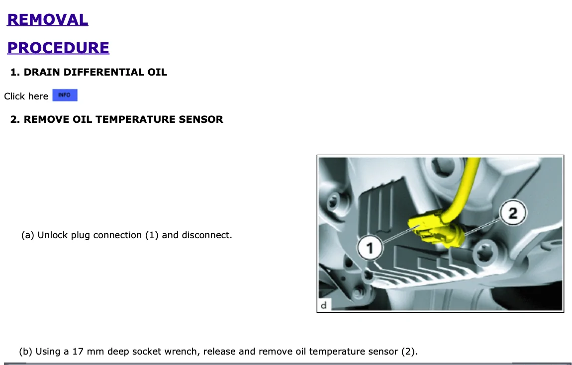

You have to take the sensor out to drain it.

Well thank you for my ignorance. I've been removing the plug and sucking out the fluid the entire time. I never realized you could pull the sensor out to drain it. Because I'm so used to doing it on all my BMWs I never thought any different. That will make it easier in the future. I will incorporate that into my new design when I build in the differential cooling plate. I'm hoping to go out and test the car the next few days.

Well your way works too but taking the sensor out is way easier. It's also how the workshop manual states to do it.
