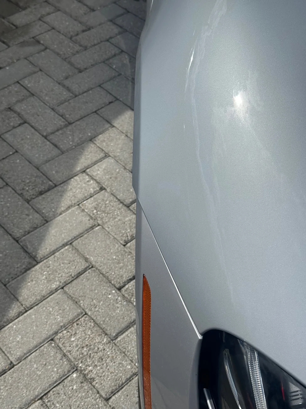

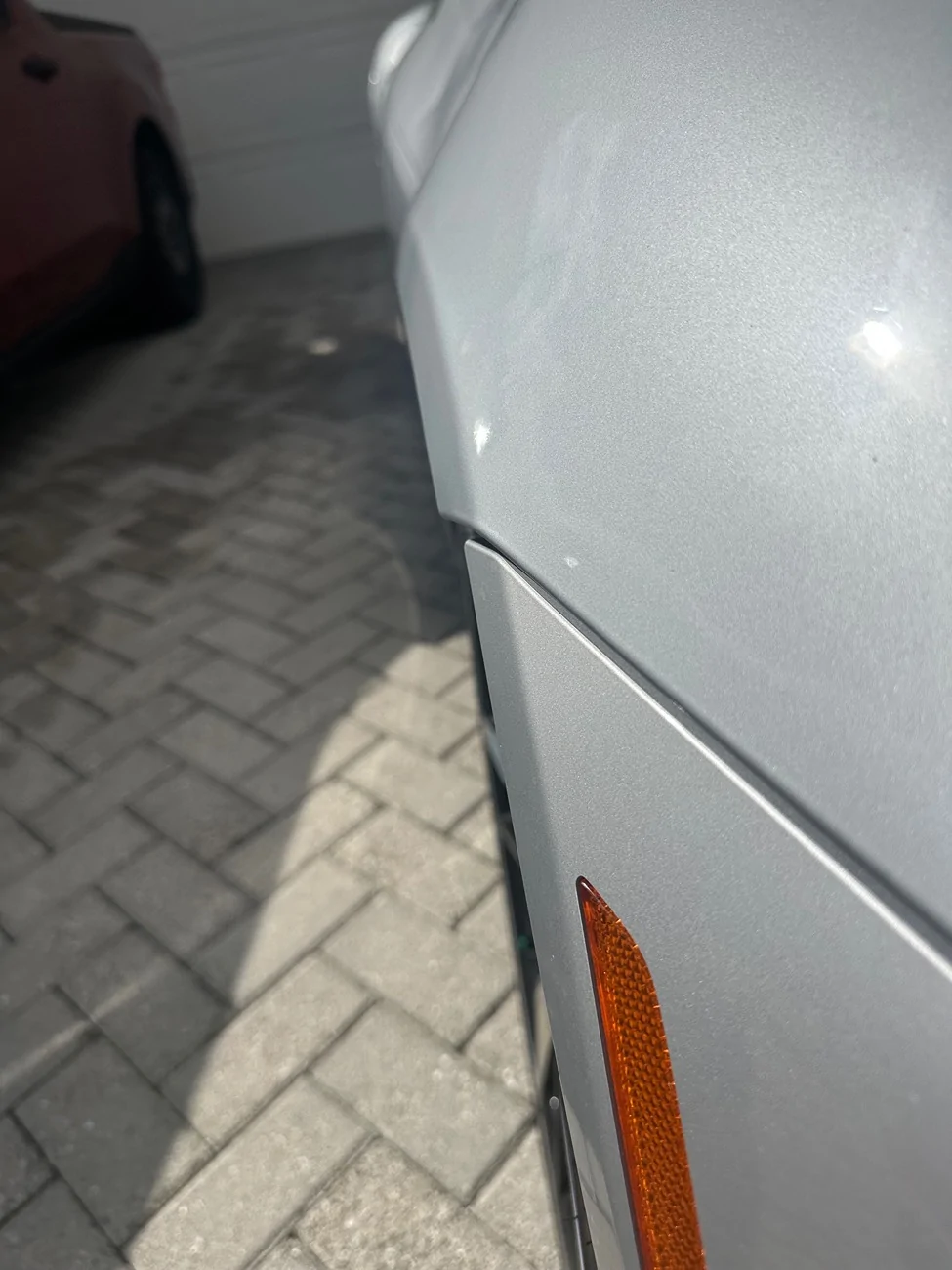

I recently installed new DRL modules on my Supra, but I realized after I buttoned everything up that I must have over tightened something on the alignment of the front bumper. I’ve attached images of it. Does anybody know where I can adjust that from?

theres two bolts above that section that you can adjust - lift up the rubber trim and you'll see it

yea loosen the bolts on top of that part of the bumper cover and there is adjustment you can do.

👆 Each pointy corner of the bumper has a fender screw that can move the pointy corner inwards or outwards of vehicle centerline.
If the pointy corners need to move towards the rear of the car, I believe (if my memory is correct) all bumper screws need to be loosened to push the bumper further towards the rear of the car. You may be able to get what you need only with the set of screws I'm about to mention...
The most important screws for front/rear positioning are hidden below the 18in-ish rubber trim right in front of the engine bay near the nose of the car. If you get the bumper in the right spot forward/back, you can lock it down with those screws before adjusting something else.
