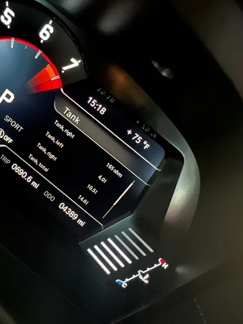

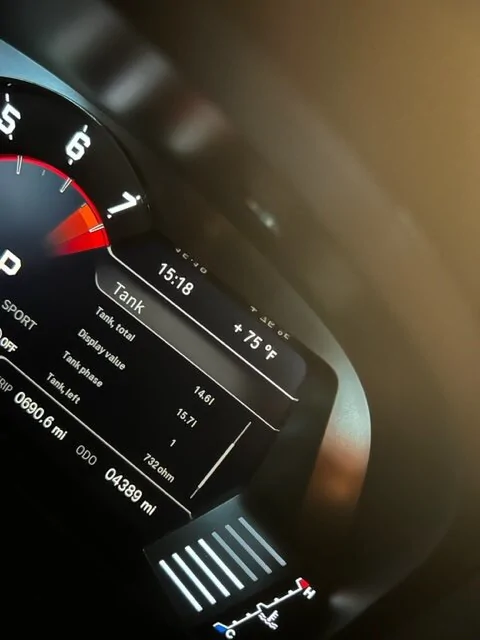

Some of you might think I'm an idiot, but I don't care I don't know how to read this. I went to my "hidden menu" and it says tank left: 4.01 tank right: 10.51 tank total 14.61 and display value 15.71...Is that the percentage left? Should note there are 2 bars of fuel left…
Thanks in advance!
See pics...

Its 4.0 L and 10.5 L for Liters. The tank goes over the driveshaft, so assuming it tells the amount on each side of the tank and then a total in the tank, and then the amount the gas gauge (bars) is showing. I could be totally wrong but I believe that is how it works.
Aug 8, 2018
2,989
3,270
Supra has 52 liter tank capacity = 13.7 gallons.
The last digit you typed as 1s is actually L as in Liters.
Anyhow out of 52L you've got 14.6L full = 28%
