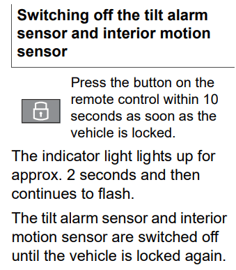

Going to be towing the car on an enclosed trailer, and I can't really seem to find any specific information. I've looked in the owners manual but the wording wasn't super clear, so I was hoping someone here would be able to chime in.
Like I mentioned, the car is going to be towed for a long distance trip inside an enclosed car carrier. I don't want the alarm to go off due to noise/shock, etc and drain the battery. Does anyone happen to know how to temporarily disable the alarm while I'm transporting it?
Would I be able to just turn the car off and close the door and walk away, or would the system arm/lock after a period of inactivity? (I feel this would be the case).

Lock the car, press the lock button again, & watch the flashing light in the windshield for the pattern mentioned..
I noticed this in the owner's manual, but it doesn't specify whether or not it disables the shock sensor. I appreciate the help either way.
Yeah I've only used it on a Ferry a couple of times for tilt. The manual doesn't make any mention of a shock sensor for what it's worth.
Looks like the manual says that the alarm isn't armed if you use the the physical key...
