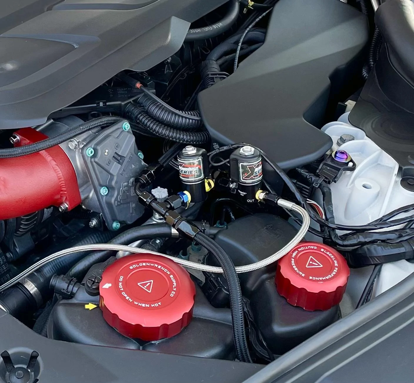

The only aftermarket part I’ve seen close to the ECU is a methanol injection system.
Maybe one of the guys running meth can chime in.
-RJM
I run meth, but run it through BMS's FSB. I did not tap that location. It's likely port injection that was mentioned above.
Might as well go full send on this one and put the Port Injection back on it. ;)

Right now I’m trying to figure out if the pure might still be on it ?. I put up a photo since short of pulling the charge piping I’m not sure how else to identify a pure turbo
Remove the turbo, the blades say pure on it
Lol that’s my last option lmao I know it’s not a hard job but I’m just short on time with work. I think if I pull the charge piping off the inlet I should be able to see the blades even if I use my camera to get a photo. I was hoping for some exterior machining marks but that doesn’t seem to be a thing.
Dont pull the charge pipe...Pull the intake pipe off and use a mirror takes like 3 minutes to remove it.
That’s actually not something I even thought of lmao. I did just realize shouldn’t the pure have a large inlet pipe though? I was just watching an open turbo swap and doesn’t the inlet for the factory turbo fit just inside the compressor side and since the pure is larger they give you a larger inlet pipe to adjust for that
its not.. That car has a stock turbo on it now. I had seen the car around in Florida at a meet.
