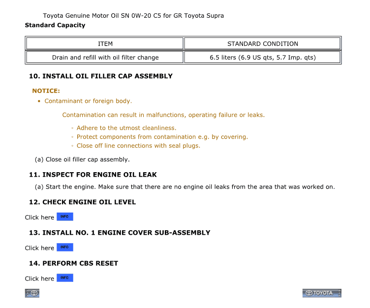

Parts guy at my local Toyota dealership insists the car only needs 5.5L (6.8 quarts)..... :rolleyes:
Had to argue with him that it's 6.5L (6.9 quarts).

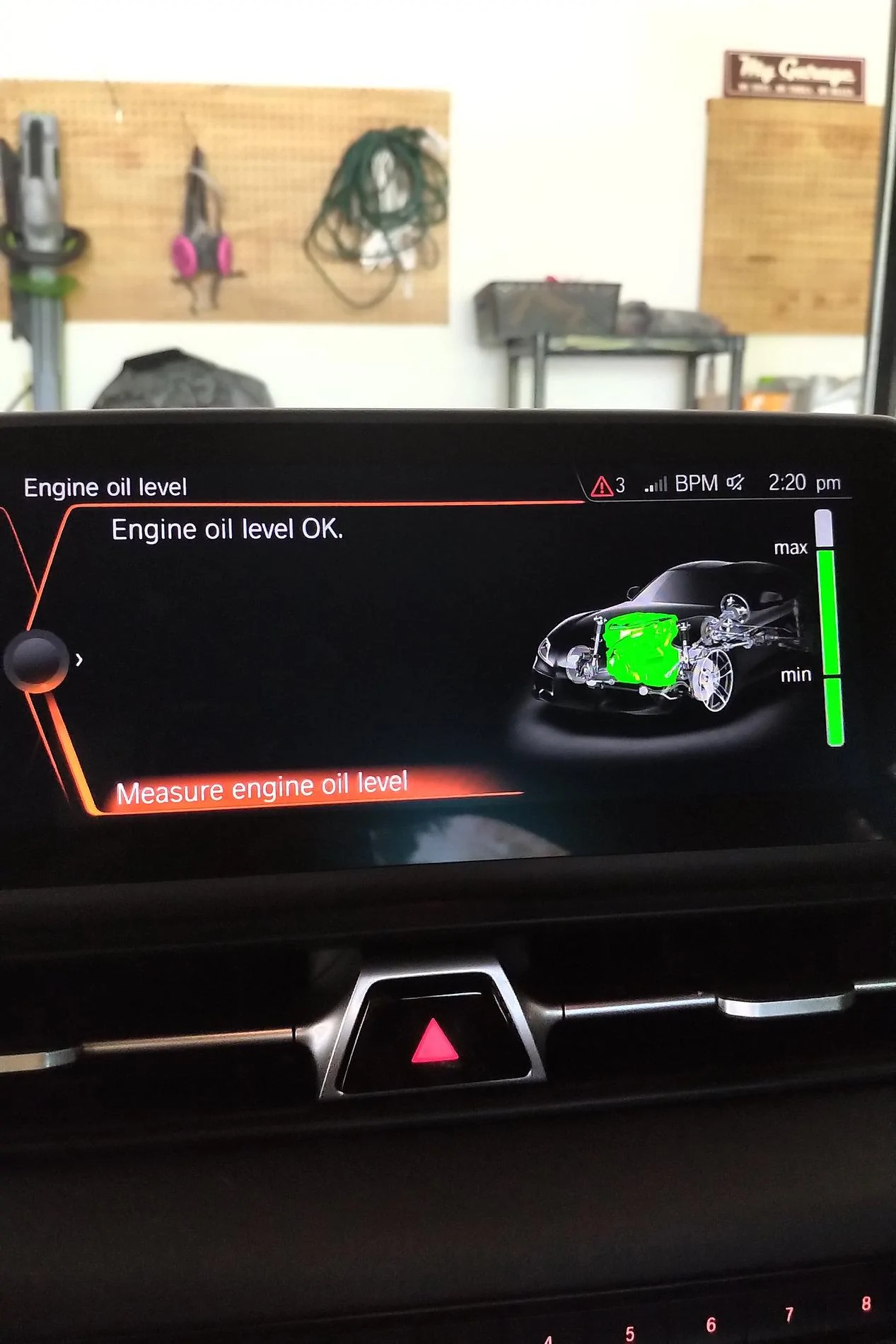

Just did my first oil change Tuesday and I put in 6.6-6.7ish quarts and the oil level read perfect first try.
I couldn't remember if it was 6.5 liters or 6.5 quarts recommended for re-fill, but right in the middle worked out fine.
