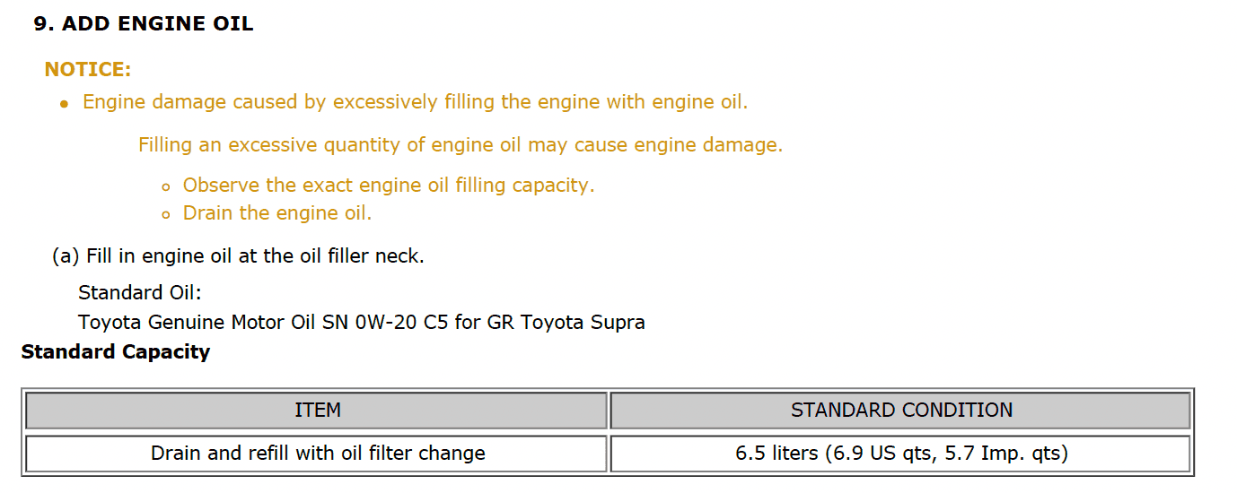

I guess I'll be the lazy person that asks: Will 7 quarts overfill it?
Dont know. Oil capacity is clearly stated as 6.9 quarts. They didnt state 7 quarts but did state overfilling will damage. Is it worth it at the very least getting back under the car to let some oil out? That being said i doubt a dealership will accurately measure anything and that would be the ultimate lazy.

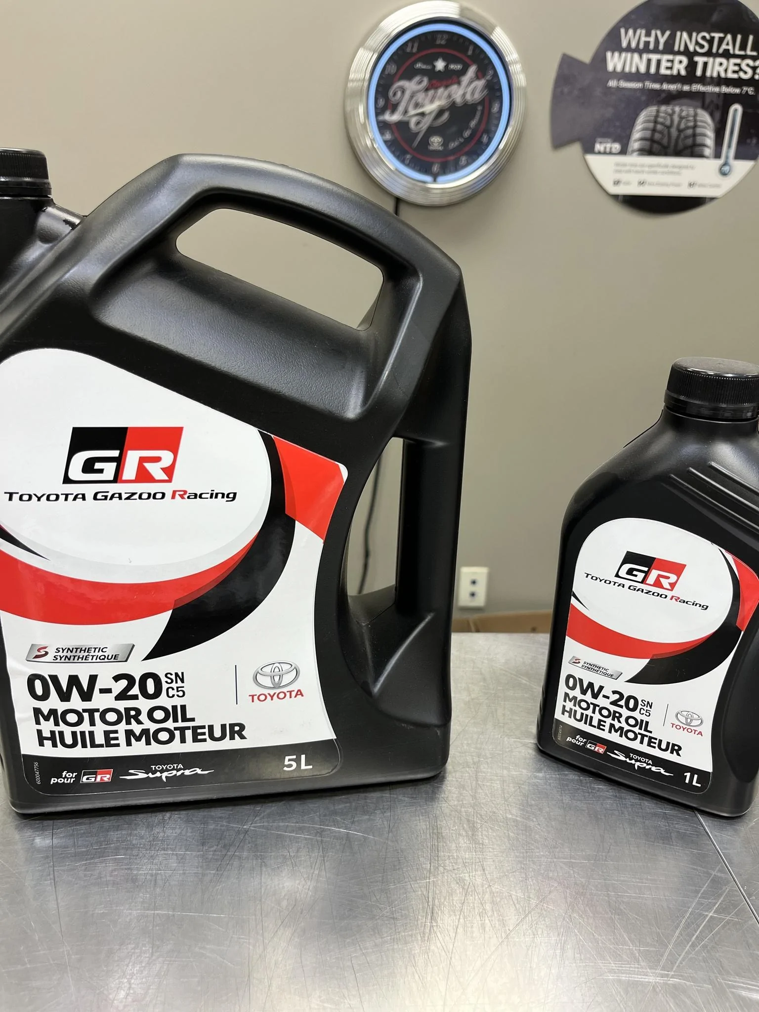

Parts guy at my local Toyota dealership insists the car only needs 5.5L (6.8 quarts)..... :rolleyes:
Had to argue with him that it's 6.5L (6.9 quarts).
8,807
17,280
Dealerships know little to nothing. That said, they could have easily just looked it up in the service manual?
